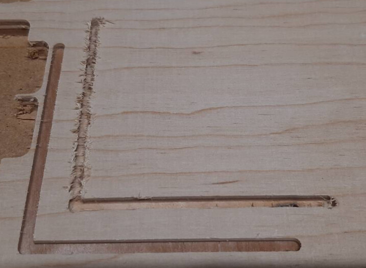

Iāve run some lines with two bits I used earlier (upcut and compression) and decided to see how width of cutting looks like on both axis, not just one.
I have found interesting thing, which I assume has to do with direction of wood fibers in the plywood Iām using for testing? Please confirm or deny ![]()
Left L shape is up cut bit. Right one is compression but (which actually should also be up cut on this 2mm DOC?)

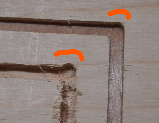

Also, what kind of wobble can this little bump be? Nearly nonexistent on upcut L, but huge on compression bit.
That problem with the upcut will allways be like that unless you can plunge the bit into the wood past the compression part of the bit, which migh be around 10mm. see this video for explanation
I think I understood principle of those bits - thatās why I said the above.
Letās clear this up. Letās assume I have a compression bit: upcut 5mm, downcut 10mm. Perfect for cutting 12mm material on one pass (if possible for given machine of course).
So, are you saying that 5mm upcut part will not work as up cut if plunged only 4mm deep?
Your compression bit could be dull/have imperfections? Itās crazy how clean of a line a fresh blade gets you, but also crazy how easy it is to dull one..it only takes a fraction of a second at high temps and sheās a goner
