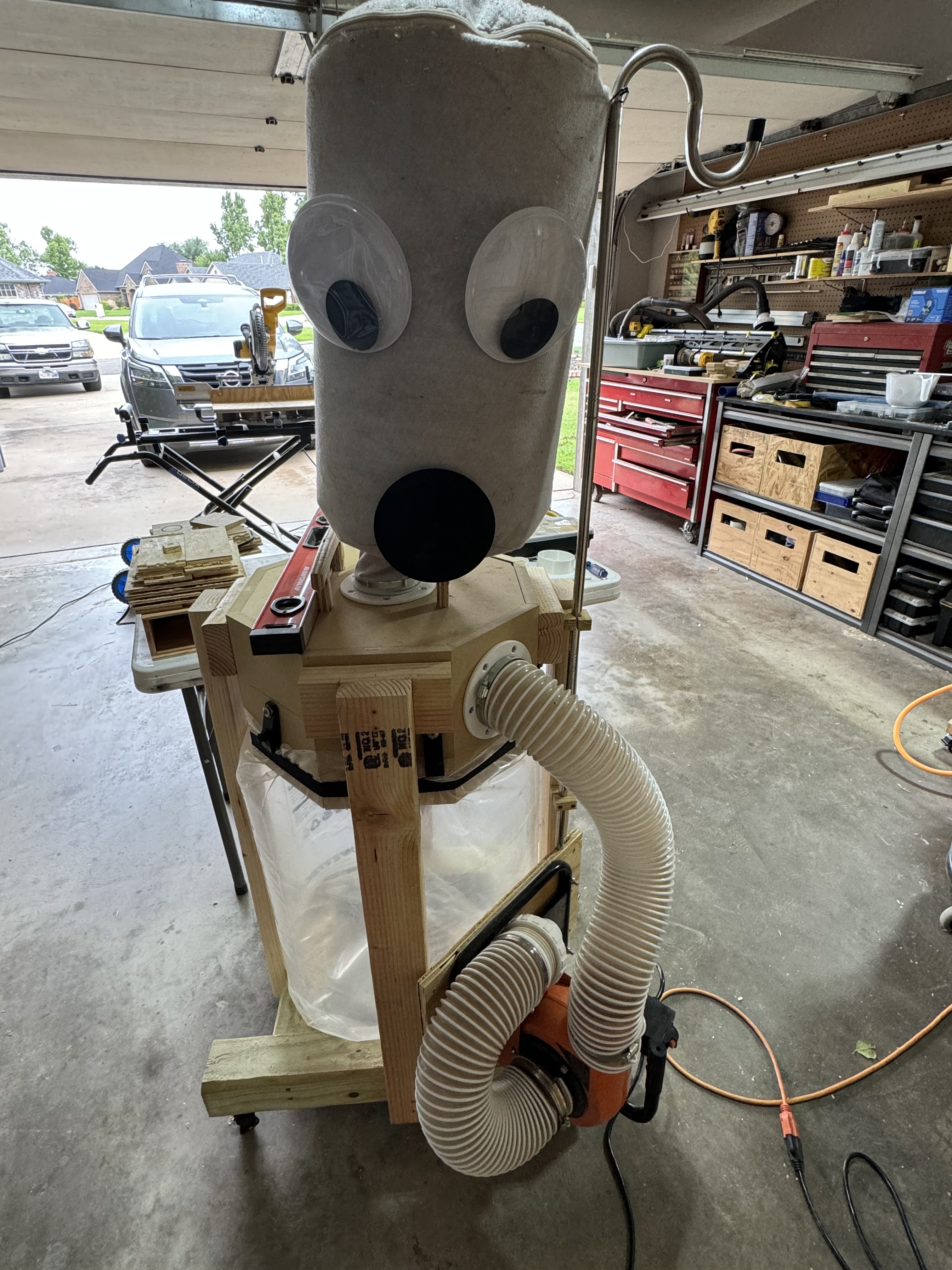

So the design is pretty straightforward, the dust collector pushes into the side entry port and down into the plastic bag below. Heavier particles stay in the plastic bag and lighter dust flows up through the top into the cloth bag and stay out of my lungs (hopefully). The internals are connected with short runs of 4” vacuum hose.
Speaking of which, I got the parts assembled, just had to wait on some #10 x 3/4” wood screws from the Amazon since Lowe’s and Home Depot didn’t want my business this week…. For some reason I can’t explain, my design in Fusion 360 for the vacuum hose mounts were set up with #10 wood screw heads in mind, so I just went with it.
The octagon housing glued up surprisingly well and the left-handed thread on the hoses just screwed right on without the need for clamps. Love it when a good 3d model comes together!
The 2x4’s for the cart are being picked up this week and we’ll see how it all comes together soon. I’m imagining some spacers on 4 sides attached to legs leading down to a plywood base about 30” below for the plastic bag to rest on. The dust collector motor will be mounted to a side plate and then I’m thinking of a manifold with blast gates that lead to various sized receptacles for different devices around the garage. Then it just needs some wheels…

However, moderate progress was made to get my dust collection cart built and all the pieces mounted. It could use some grab handles, but that’s a tomorrow kind of problem.
The last part is the manifold system, which will require the 3D printer, a little CNC work and some general plywood cutting and assembly. Also probably more vacuum hose to make everything fit nicely. The general idea is to be able to roll this thing over to whatever device need dust collection and just hook it up to whatever size it needs and open that blast gate.
These are mock-ups of the face plate with gates and hookups, I’ll need to build a box around it with a single 4-in vac port to run to the collector. Then I’m thinking I’ll mount it at around waist height and maybe add a hangar hook pole to the top for certain applications and some hose keepers to the sides…

Weirdest problem I’ve had in awhile… apparently they don’t sell Googly eyes with pins on the back over 2.5-in diameter on Amazon? Problem solved, ordered a pair of just paper back 6-in Googly eyes and some giant safety pins, then 3D printed some backs for the eyes with snap-in slots for the pins.
Add little CA glue and I present to you: Giant Googly Eyes for my Dust Collector Bag

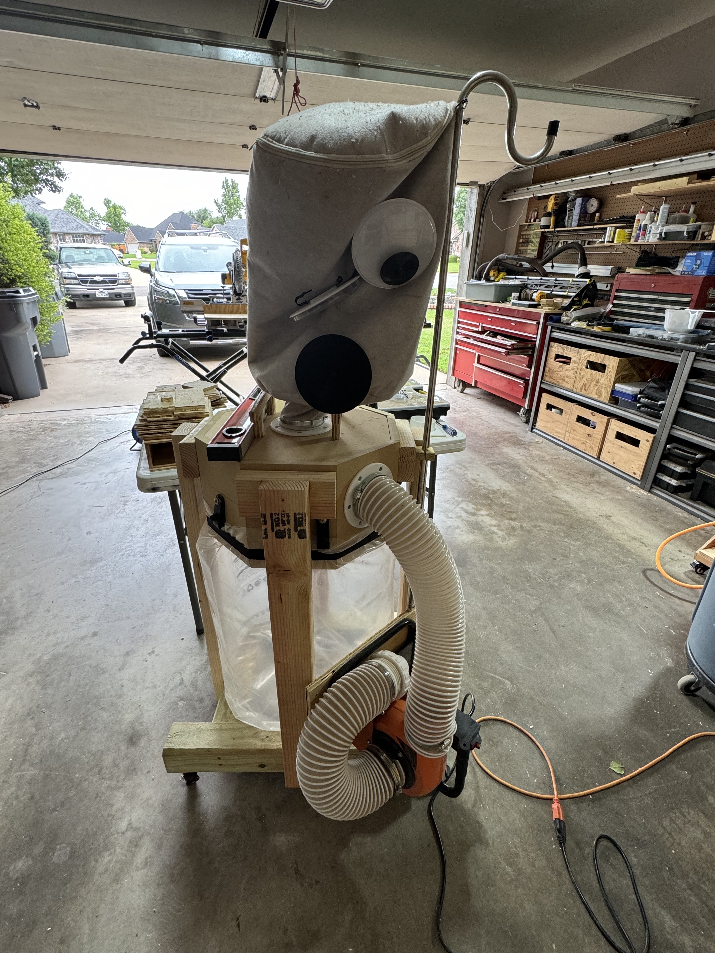

I could just 3D print another googly eye backer in black and then just pin it on at mouth height…
Had to clamp a hook on there to hold various vac hoses up off the ground so I clipped the bag to it too. So I present to you, awake mode and sleep mode.
