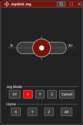

Added a new version to Github that includes independent X and Y jogging. While I like XY mode, sometimes you only want to change one axis at a time.

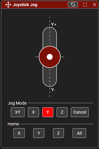

Y looks just like Z but with different labels.
I usually use this on my phone, and it’s nice to be able to start the jog and look away from the phone while getting it in the precise spot you want. Note that on a phone, while not necessary, it is sometimes nice to put it in fullscreen mode when using it. Not a good idea on a larger screen.

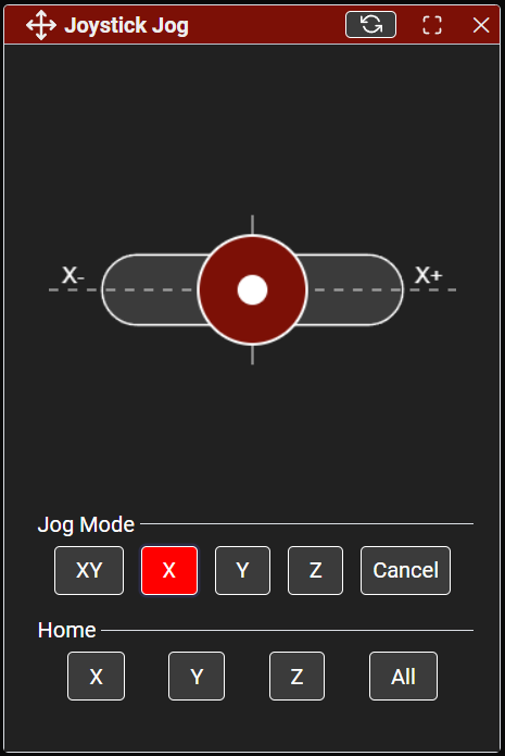

I made a few minor updates to this extension:
  1. Support WebUI version 3.0.0-5-FluidNC (which is now necessary for proper formatting). This is mostly changes to margins.
  2. Updated to center the touch joystick portion.
  3. Updated to send a “?” to get status when the extension loads. If you are only using auto-reporting and refresh the extension, it would not enable the joystick until an update was received.
If you are upgrading to the latest WebUI, you probably want to update this extension, otherwise, it’s nothing of consequence.

But when adding the joyjog now the UI appears but the joystick is not functional. The buttons work but joystick doesn’t move or do anything.
FluidNC v3.9.9
Yea, I need to do some more investigation. I was having issues with WebUI 3.0.0.6 and my extensions but I was also testing a FluidNC 4.0.0-pre release. What I saw was exactly what you describe. It’s because the extension wasn’t getting an update that the machine was idle, so it wasn’t enabling the joystick.
