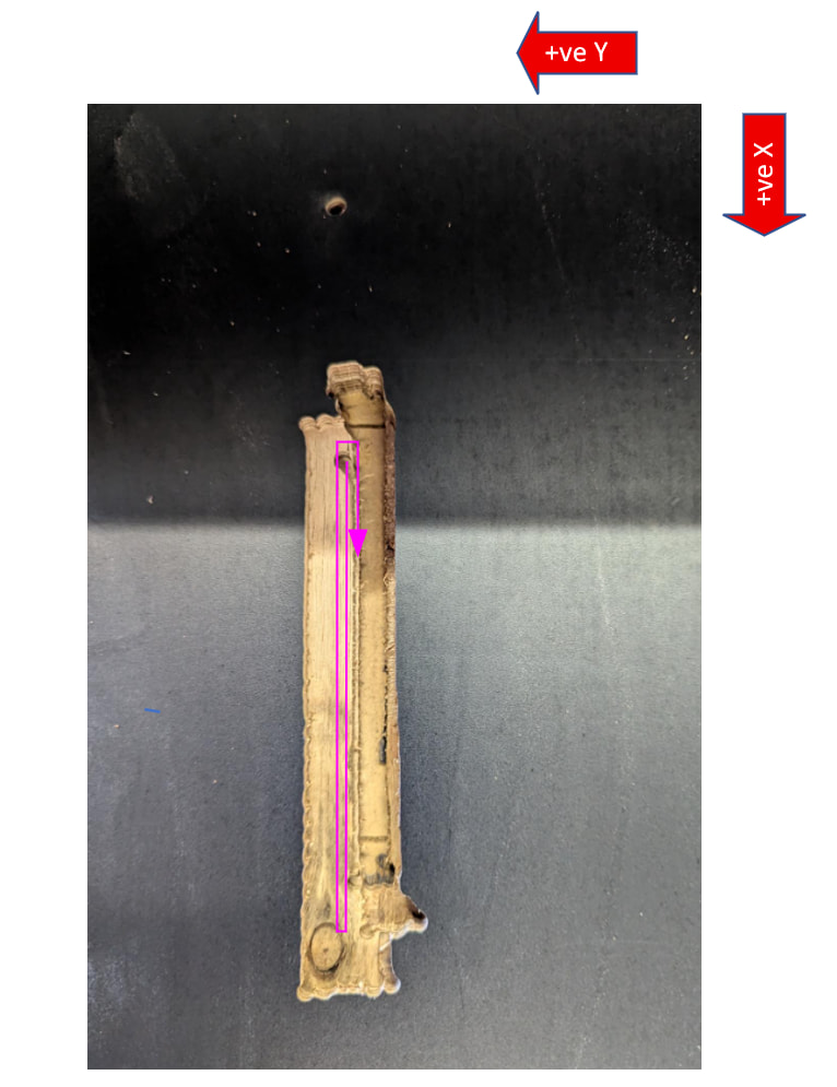

Right…… The LR4 has been working flawlessly….. up until now! Of course it happens to be the first serious project!
  • 17mm Formply (Phenolic faced plywood used for concrete formwork/shuttering)
  • 1/8” Straight 2 Flute Bit (new)
  • Depth of cut = 3mm, Feed = 25mm/s (1500mm/min)
  • Router Speed = Between 2&3 on the dial (Genmitsu Makita clone) - circa 14000RPM?
Initially I think I was running the router too fast (5 on the dial), and too deep (Depth of Cut 6mm), with too long a bit (32mm). Ended up dulling the bit (discoloured). Trying to pocket a hole and when I dropped down to the next level the depth being too great it wasn’t able maintain track - ended up losing both X& Y.
Changed out the bit to a (again new) 1/8” Straight 2 flute (this time only 22mm long). Also checked grub screws on the X-axis Stepper and tension on X-belt.
Vastly improved for a period, with no steps missed - until this

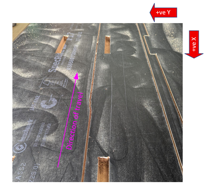

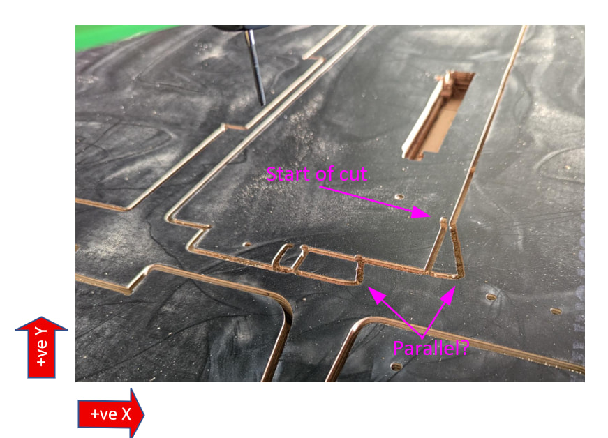

I don’t understand why the x axis would suddenly wander on a long straight cut. It then comes in to complete the loop and goes off on a tangent again (where I’m assuming the Z drops 3mm). The cut along the X axis looks ok, but then it goes off on a similar angle when it tries to cut on the Y axis.
There’s no discolouration of the bit, but I’m assuming it’s dull on the basis that it’s digging in at changes of depth/direction?
Would welcome any input on the issue - and I’m more than happy for my thinking to be torn apart…. Every day is a learning day!
Thanks in advance

  • A typical run setting for me is 1/8” 2 flute upcut at 3 on the router and 7.5 mm deep in 1/2” ply (12.7 mm) to get 2-pass thru cuts. I had to slow the acceleration down to get x not to skip. What you are displaying looks to me like you have a bad y motor extension wire and the gantry is moving out of square.
  • I had a dull ball nose one time and when it would plunge, the y gantry would lift off the table and rail on the y min side. Are you ramp plunging with that straight-edge mill? Any video of the cut when it does that?
  • Is your vacuum hose grounded?
  • Are any wires getting pulled at various gantry or core locations?
When that happens to me, it is always one of two things (rarley both): a dull bit or being too aggressive (to fast speeds and feeds). I run my router as low as it will go (16,000 on my Dewalt). And try to not go more than 1/2 the diameter of the bit on a DOC or sometimes just a little more.

I have been playing with limit switch cables (and discovered that I hate crimping dupont connectors!) - but haven’t touched the stepper motor cabling. If it was the gantry out of square, then all cuts would then be skewed thereafter? It looks like the cuts on the x-axis are in alignment (or not as far out os the cuts on the y-axis).
How would you diagnose a bad extension wire if it’s an intermittent fault?
Yes - ramp plunging the bit, but no video of it. Plunge is 8mm/s @ 45deg

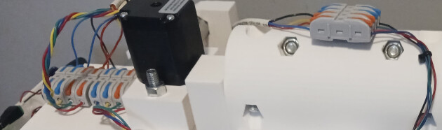

intermittent faults are the worst. usually the best option is to resecure all wiring that is extended. and verify connections are in fact connected. I don’t trust dupont extensions. I don’t trust dupont to jst connections. For wire extensions you can strip the ends and use the wago toggle switch connectors, but those are huge.
On the MPR&P they are used a lot because they are easy for prototyping.
