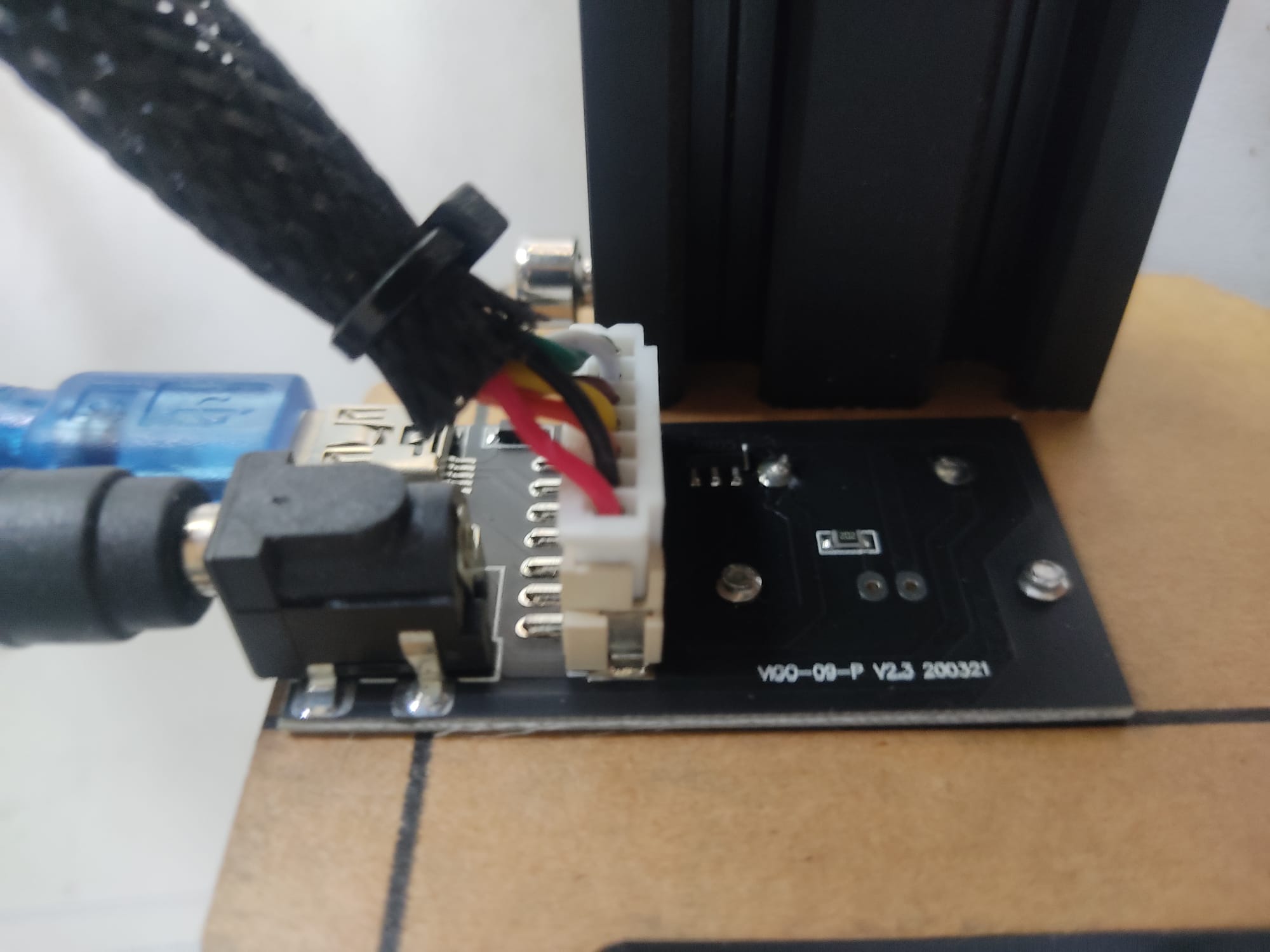

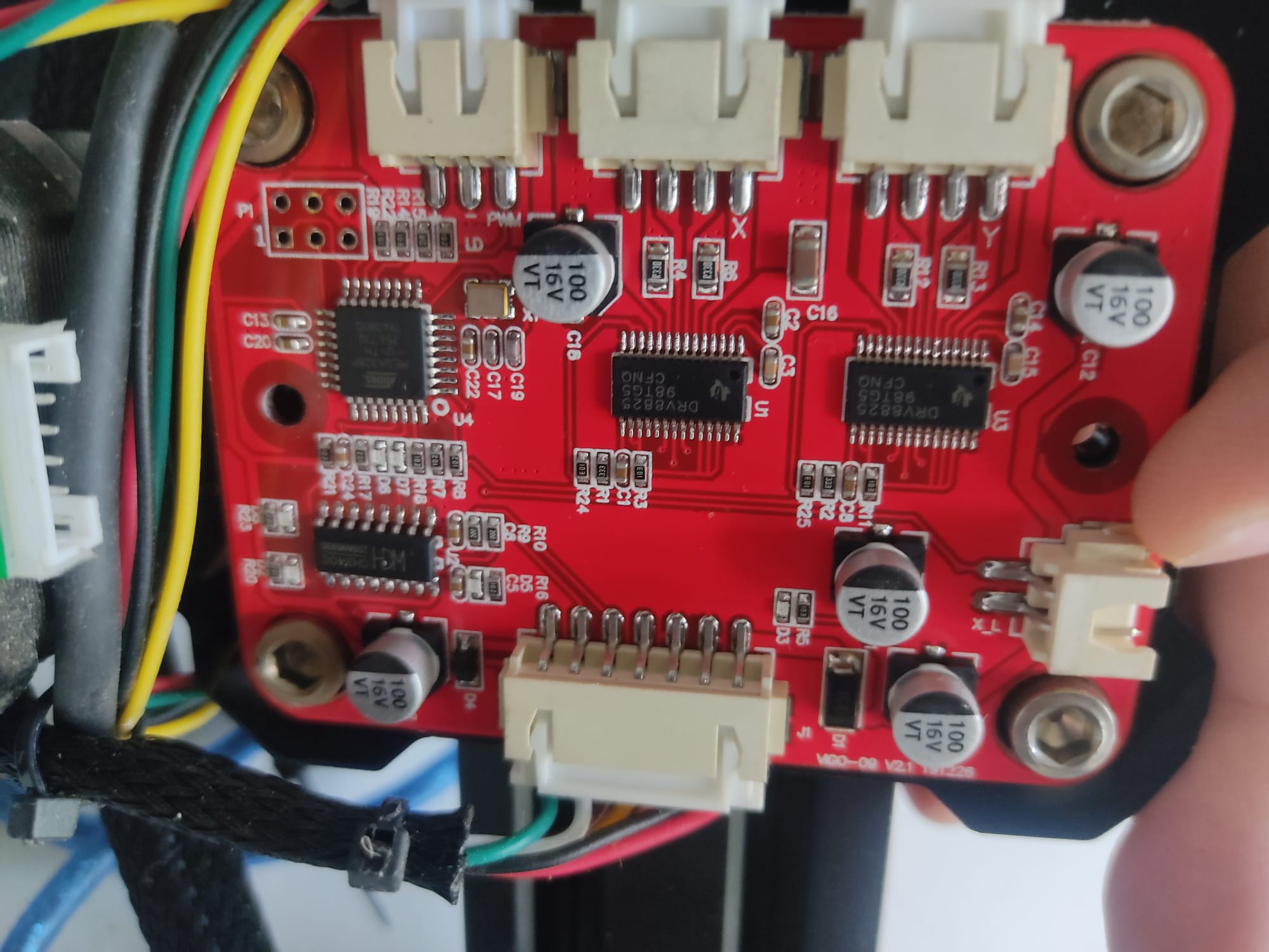

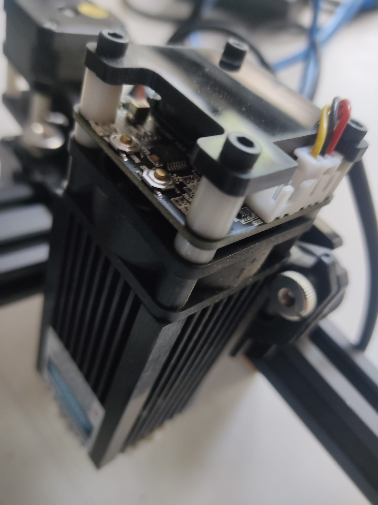

This is my small engraver from which I am trying to add the laser to the MPCNC.
Do I need to get the pcb from it in order to operate the laser module or can I connect it to the SKR Pro v1.2 and control it from the MPCNC marlin software? Do I need a separate power supply for it (how to connect it)? If it’s just the module that needs to be taken from it I will probably buy a more powerful one later, but I want to try with what I already have first.
