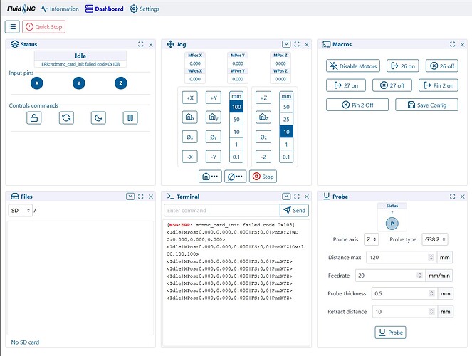

Does anyone have videos showing the use of the web ui for the LRv4 with jackpot 3? I’m trying to understand everything before I buy the kit from Ryan, and I can’t find any videos on YouTube showing it all from start up to probing to running a file. Doug came close on a couple but didn’t exactly show every button push. After reading one of builds post ( of several that I’ve read ) it became even more confusing. A video from start to finish would ease my brain. I’m probably over thinking everything but…

Yes, probably. The thing you don’t realize is how little you actually need the UI. For normal usage, you need to:
  1. Home the machine - there are buttons per axis and one to do them all.
  2. Jog to the starting position of a cut - There are direction buttons +/- per axis
  3. File browser - you can upload files and run them
There are other optional features like:
  • Zero axes to set the zero position - this is normally done in gcode
  • Probe - again normally done in gcode
  • Macros - custom gcode commands

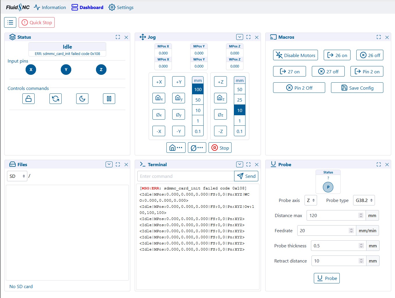

This is what it looks like. The 6 little boxes move around depending on your screen size.
The first box has that pause button in it now, it will change into a play button when needed.
Home is next to it, in the jog box.
macros are a few extra things that are used less often.
Files are there when you have a loaded microsd.
Oddly enough I never use the probe panel, most do it in the Gcode with each file.
Does that help make a few things more clear?
