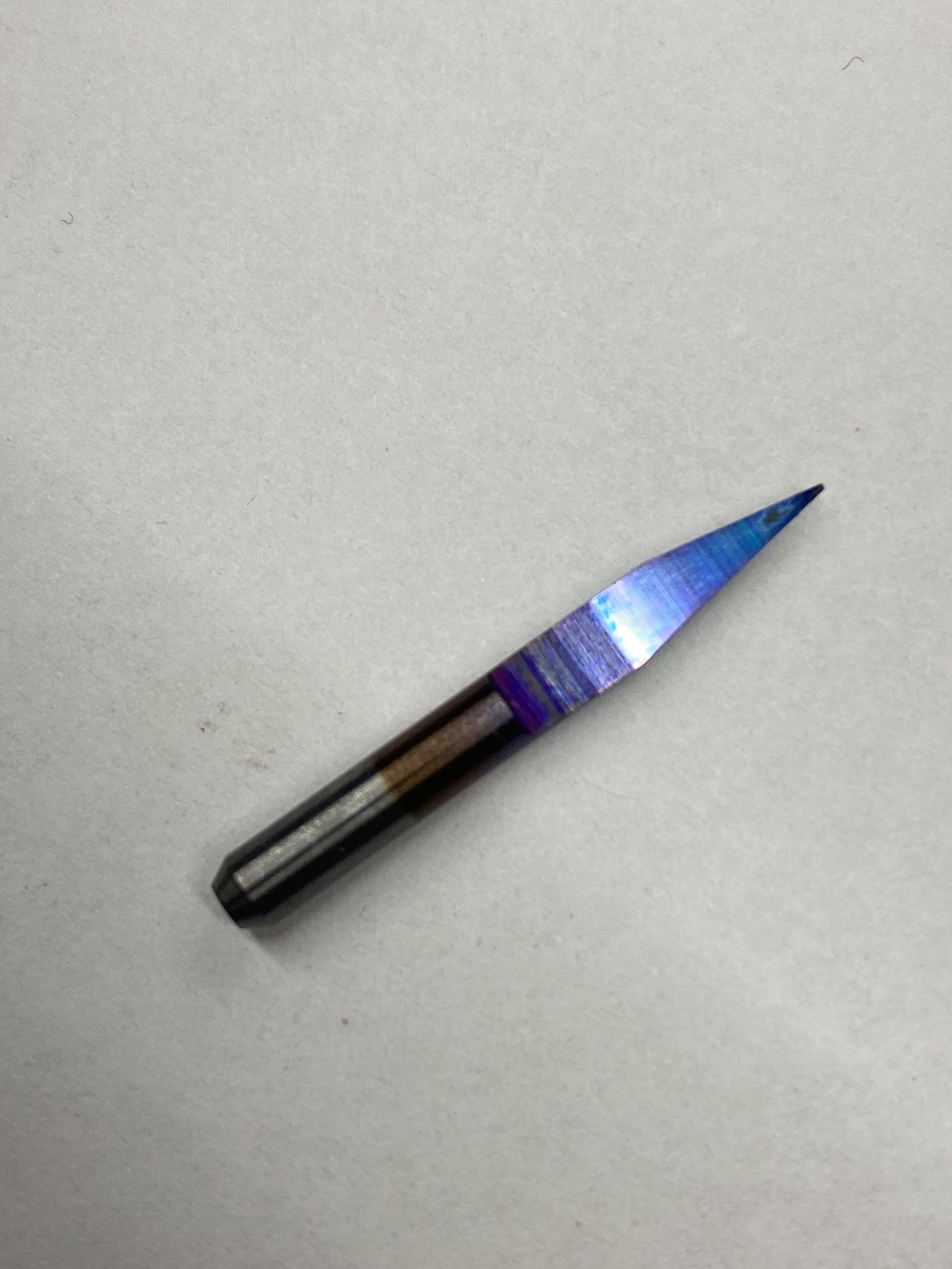

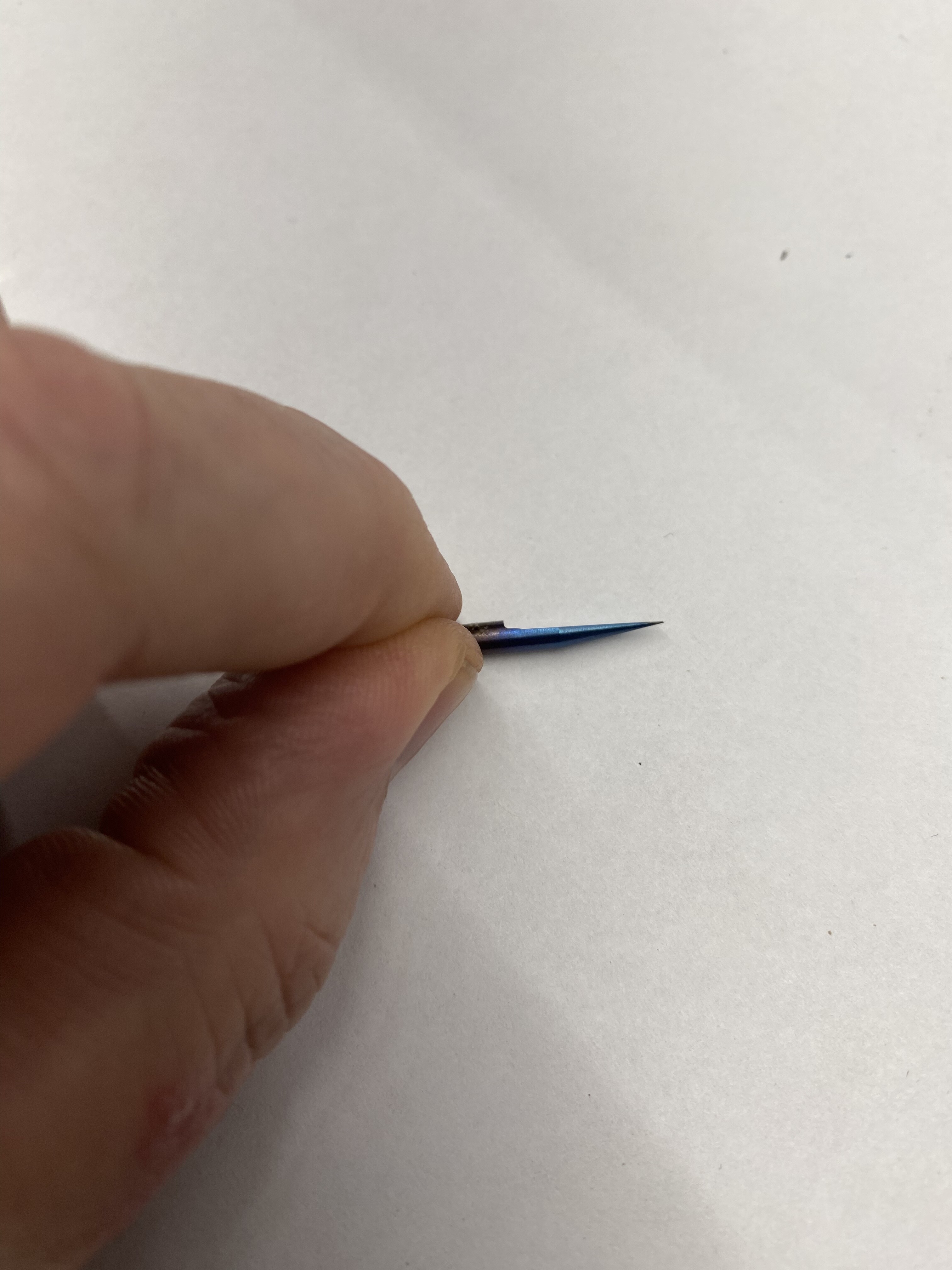

I have never seen a triangular bit have you used it for any cutting? It seems like it would be a bad idea in terms of material removal rate.
These, 1/8" 45 Degree Carbide V-Bit – V1 Engineering Inc have a flute for chip evacuation, and even these, Amazon.com seem like they have more room to eject material.
Why did you choose a triangular bit?
YouTube loves to truncate links.
I have not used it for cutting (that I can remember). I picked those up thinking I was getting the right thing, and did not even realize they were that way! :slight_smile:
I guess I need a better link regarding bits!
EDIT: I will simply swap in your link to the V-bit on the V1E.com shop!
UPDATE: change made here, making on my build log thread, and on YouTube description.
UPDATE 2: Checked, and that bit was not a triangle after all.

So I double checked and that bit is not a triangle. It’s identical to the one that you linked in your post. It would seem that maybe the illustration photo in my Amazon listing kind of tricked you. Here are better photographs of it. This is my actual one in hand.
I think we’re all good. Thanks for the tips to hone the video description.
