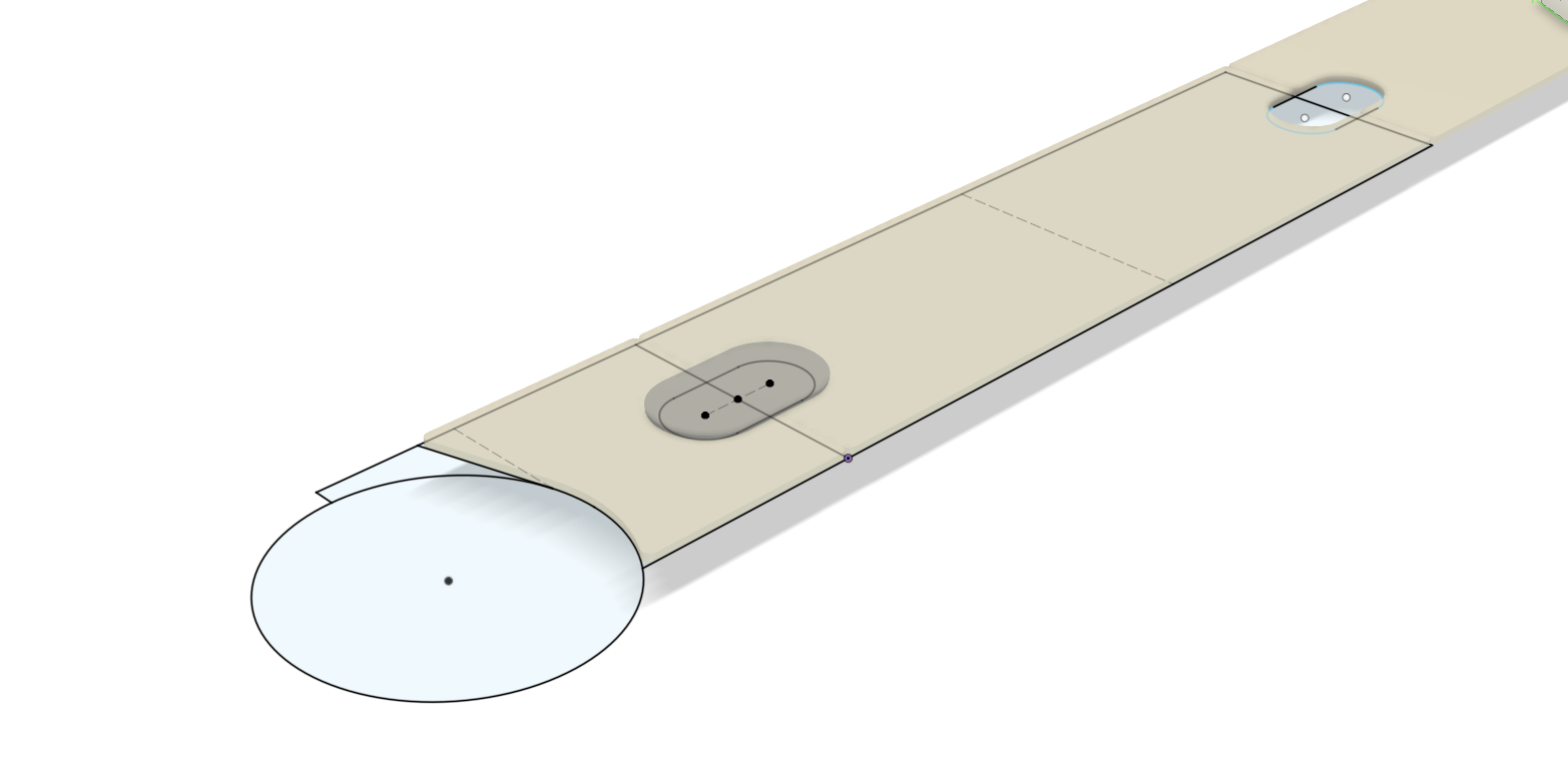

I built a sort of u-shaped “gutter” i attached to the back of the cabinets, flush with the worktop, and added some custom-cut panels on top with 3d-printed latches
I’m very pleased I did add this, as it makes the whole desk a lot cleaner :slight_smile:
The single-post screen support also helps a lot for a clean setup

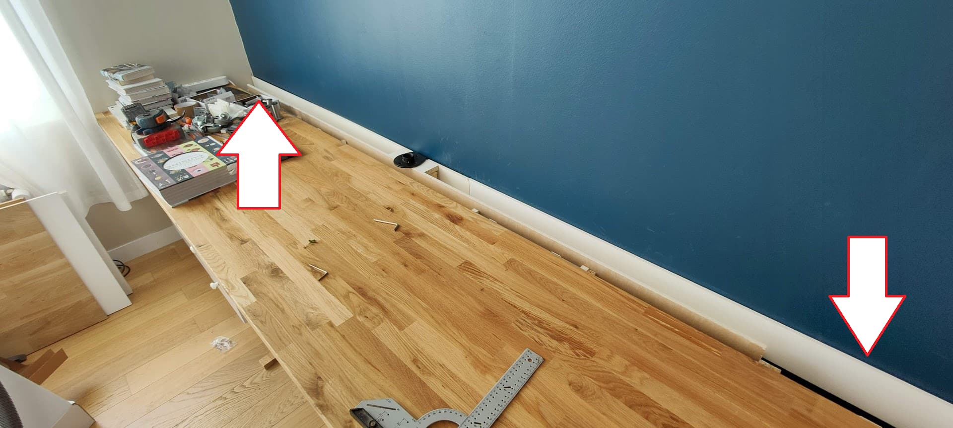

In fact it’s just a tassle with skirting boards attached to it
There’s a gap on both sides of the gutter where all the wires can drop down to the wall outlet behind the cabinets
The right one is covered by the wall shelf on top of the worktop, the left one is just covered by the small panel covers I made (plus there’s a massive typography press right in front of it…)
I also drilled a hole on the front face of the “gutter” in between the two cabinets (where i sit)
This one lets me route the screen and PC cables to the USB C Hub station I hanged on the side of one cabinet
(this one needs a little bit of care and finish, but still…)
It’s clean, and I can easily plug my headphones or any USB device without reaching too far back
I might add a hook for my headphones at some point too, maybe even a small “under desk” USB outlet in the front…
I also made sure the gutter was wide/deep enough to put some power outlets with plugged-in cords into it.
I have two of those 5-slots-outlet tucked inside the gutter, both with 2 USB charging ports
If you ever need to plug anything, you just remove a cover, and plug it to the outlet inside, no need to reach down o the floor, it’s a lot easier and accessible
Having the holes in the cover panels rather than the desk itself allows you to easily change where the cables go through depending on your setup.
Just change the lengthes of the covers and you can get any spacing/position of cable outputs
eg: I made small ones around the screen support post so that the cables go directly through
Also, one small advantage of this whole system is that, with the screen support attached to the gutter rather than the worktop, the desk has a bit more depth than your typical kitchen worktop (+10cm), and it gives you a bit more distance to the screens, which is comfortabl

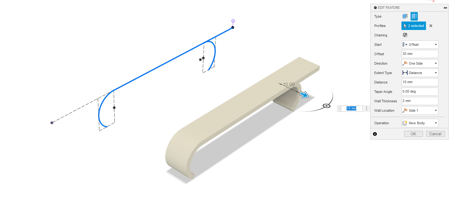

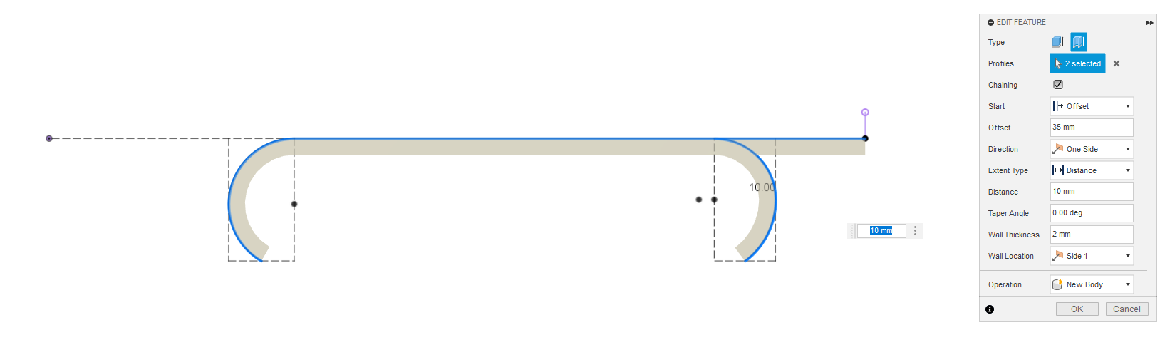

Any chance you’ve shared your 3d-printed latches somewhere publicly?
Sure!
https://file.io/mfnYYfj8YNPt
The design is pretty specific to my use-case though, length will need to be adjusted…
Also, I needed a small 2mm thick tab in the back to compensate for the gutter being slightly below the worktop’s height
This tab also serves as a reference to where I need to glue the part on the cover panel relative to the back of it…
The design can easily be replicated / adapted, it’s just two half circles and a line, with a 2mm thin extruded wall
I added a small fillet in the back for a bit more strength
Prints rather quickly on its side (it’s only perimeter walls…), and I made a few attempts adjusting length until I got a satisfying “snap”
The file also includes the cover panels, and plugs for the holes between covers (I might try a TPU version with brushes at some point…)
