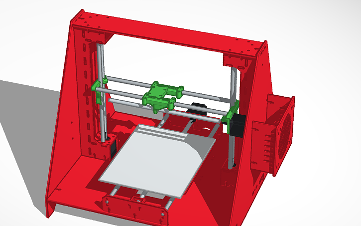

While it’s a lot of work, I have used TinkerCad for some quite complicated assemblies.
Create a group/folder thing and you can have many small parts and then keep a “master assembly” part with copy/paste parts put into place.
I have individual parts designed for all this whole printer. Many of them have evolved from when I did this assembly, to use fewer screws, be more rigid, or just use different hardware. At some point I stopped updating the assembly, because it’s a pain to position everything exactly, but that’s how I validated all of the various pieces as an assembly in the first place.
Now, using more robust CAD, I’ve abandonded this method, but I think that it at least proved that you can do some reasonably complicated work in TinkerCad.
