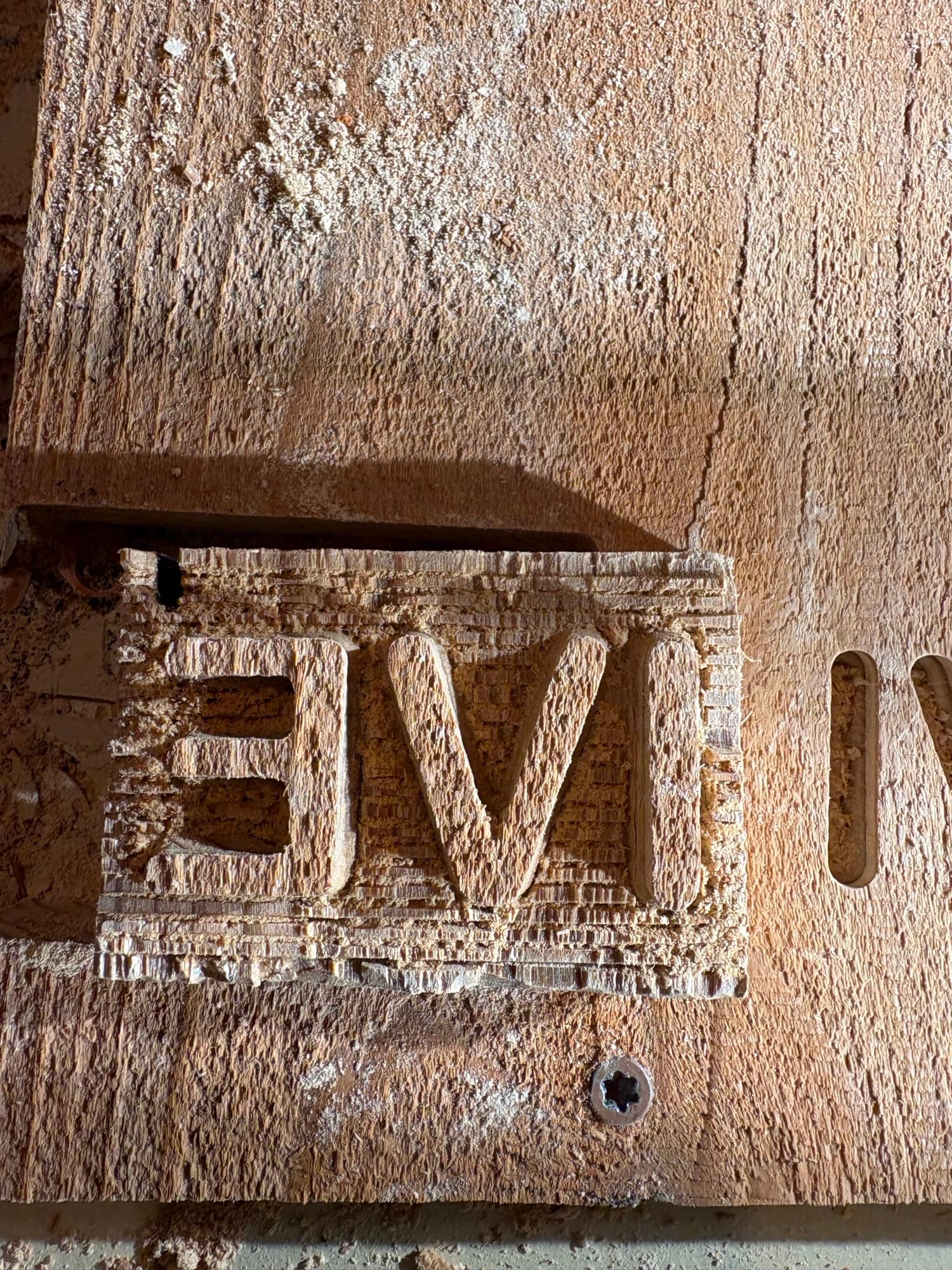

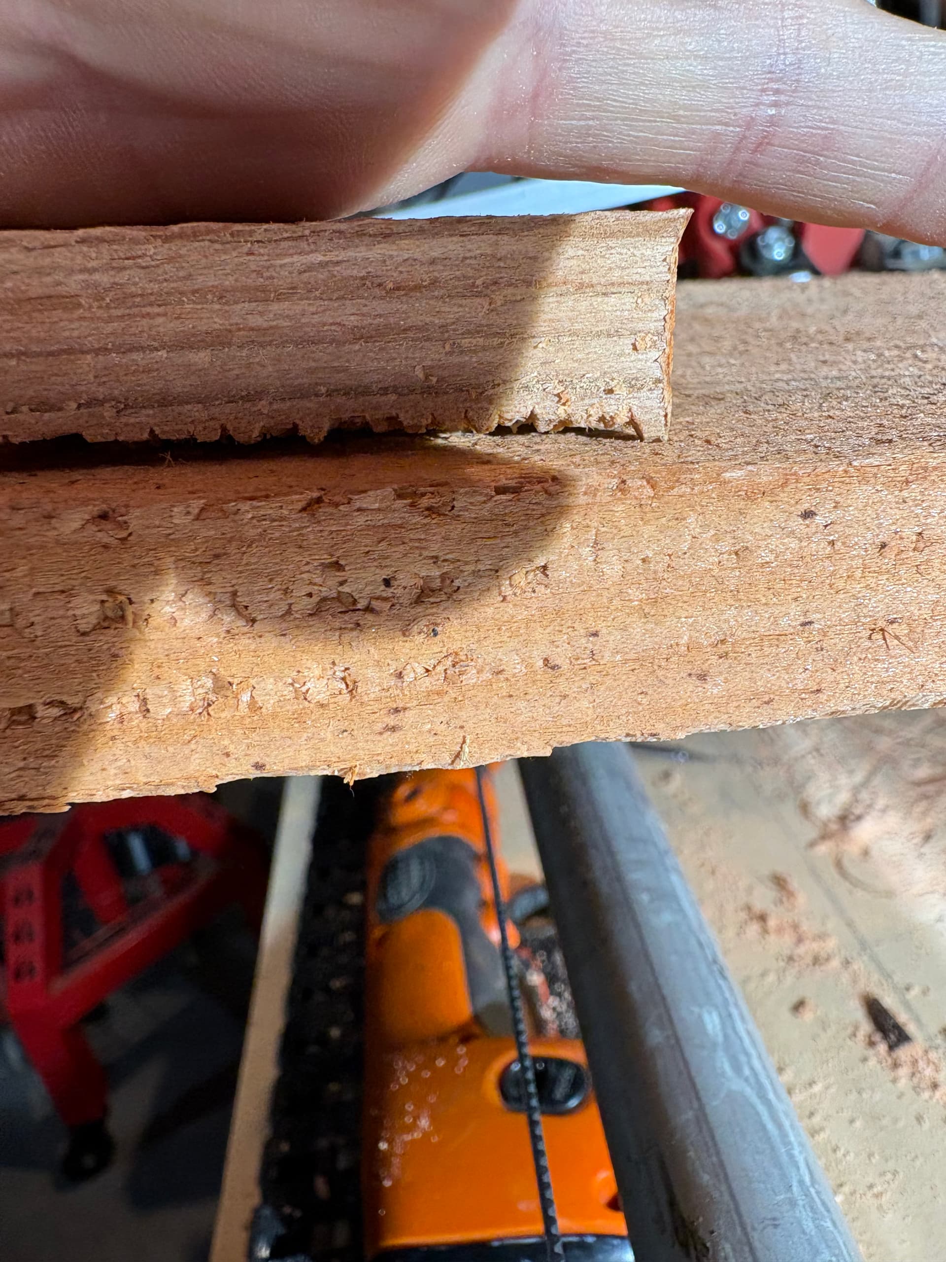

Philipp, you really got my attention with lazy because I are LAZY.I saw what you did in the vid.and stacked the gcode ,very interesting, but I am not ready for that.I am starting with some text I did this by Female text is say 30 I made it 29.75, mirrored it, and it works fairly well now this is Green redwood.
