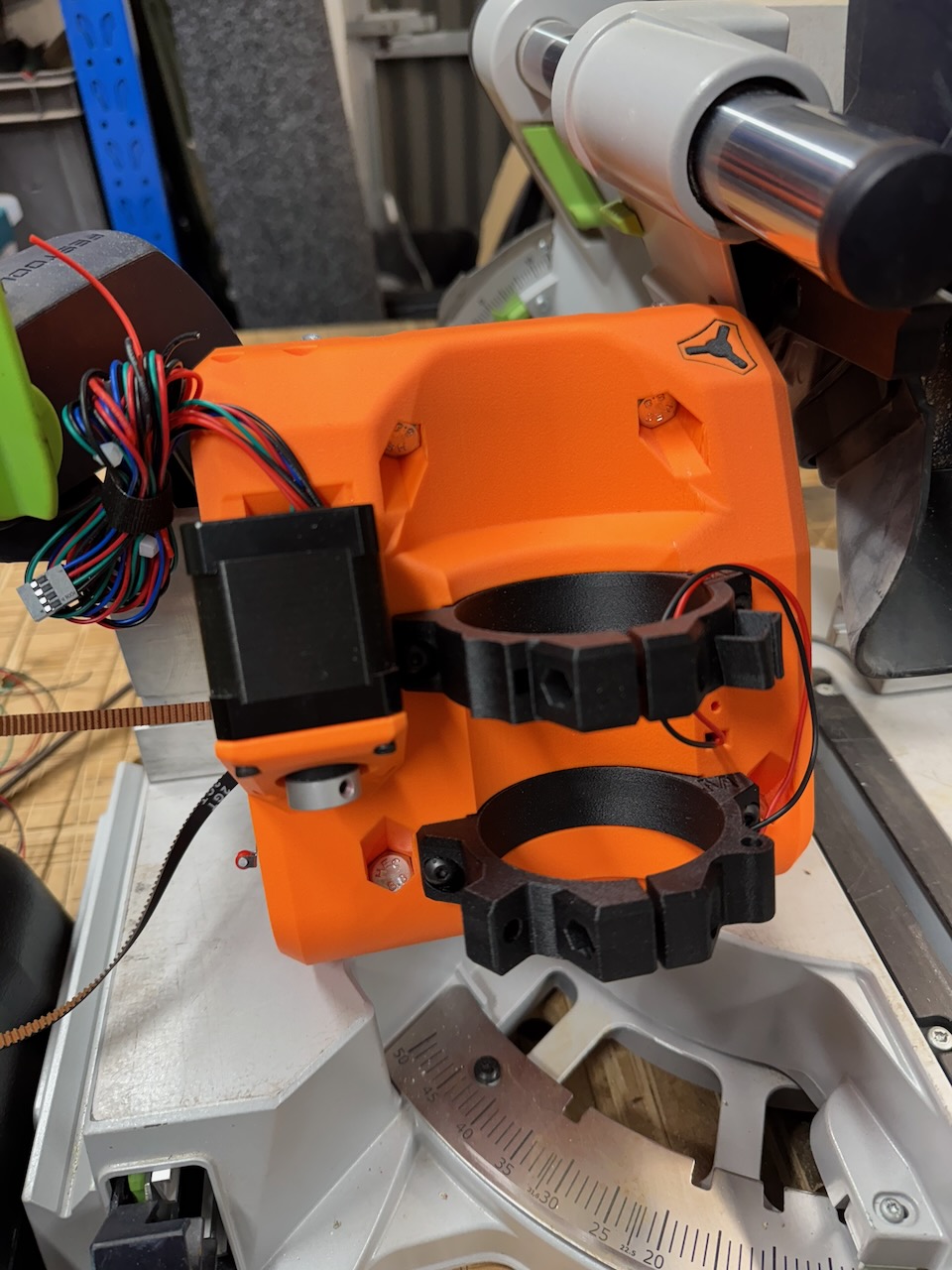

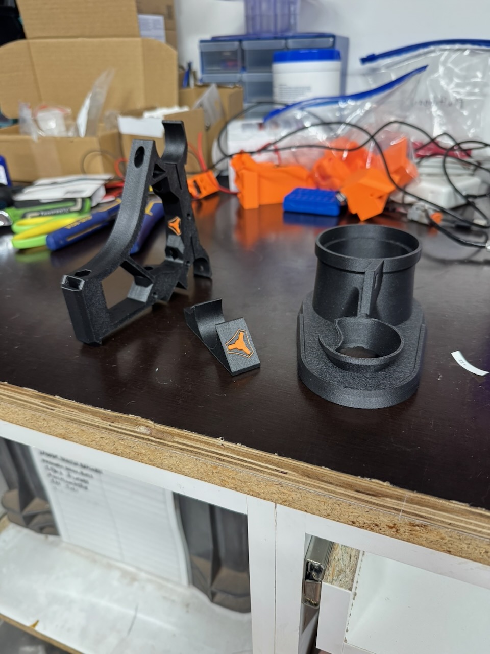

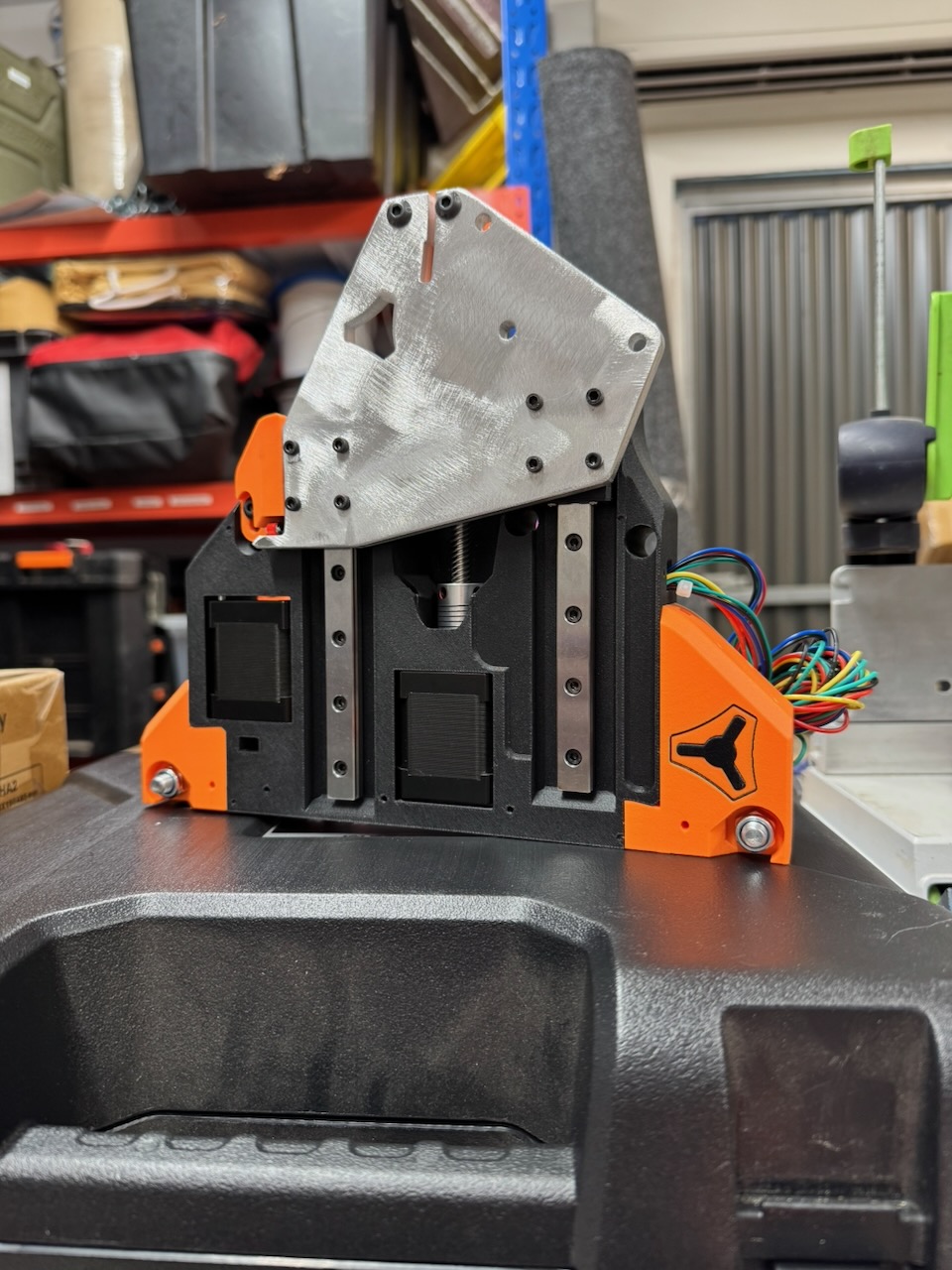

Anyway, the build is underway! The potential second mistake is my immediate straying from the Approved Path™️ by printing the parts from ABS-GF. I bought a bunch of it for some other projects and I’ve just been so impressed with it. I calibrated the shrinkage and haven’t had any early issues with assembly, but time will tell if I’m going to be back printing new parts in an approved filament.

I just love the finish that fibre-reinforced filaments give, and the H2C does an amazing job (and it’d bloody want to for the price). The parts came off the printer perfectly first time; I don’t think I had to reprint a single part. I’ve gone with black as the base colour, and orange as the accent. I’m not sure if the orange will be a bit much all told, but, I guess that’s the beauty of having a 3D printer in the workshop – you can change it out pretty easy!
I’ll use a Makita 700 series router to start with, and I’m trying to re-use some of my existing components from the workshop where I can. I had an unopened box of OMC 2A NEMA17s that are being put into service for the LowRider, and I’m intending to run Remora on a BTT Octopus Pro (lying around) and LinuxCNC on a Pi 4. We’ll see how that goes… I may yet raise the white flag and buy a Jackpot 3…
So far, I’m really enjoying the build and the instructions have been exceptional. I’m really looking forward to getting this thing built and making dust (which is the obligatory side-quest – I’m going to have a play with a 3D-printed dust separator too). Thanks, Ryan, for bringing an awesome bit of kit into the world.

I would be interested in how this turns out. Everyone says PLA is more rigid than ABS, but then you add in GF and you would think it is more rigid.

Care to share an example of any ABS variant that outperforms the recommended materials in rigidity? (basic PLA, or PET-CF or PET-GF)

I’m interested too! :laughing: I suspect it’s going to be fine for what I’m going to be doing with it, but there’s no doubt that PLA is the superior material for this particular use case. I’ve got ChatGPT to do a little comparison of the various Bambu filaments based on their TDSes and come up with this, using PLA Basic as the baseline:

I think this is pretty telling. PLA Basic is their cheapest filament by far (about AUD$16/kg in bulk) and essentially the best on every metric. If you were hell-bent on using something other than PLA, the other one that I find interesting is PA6-CF or PAHT-CF, particularly for something like the core, and maybe PET-CF for structural braces.
At the end of the day, the point of this project for me is building it, tinkering and having a bit of fun experimenting, so if it all falls in a screaming heap, that’s perfectly OK with me :slight_smile:
