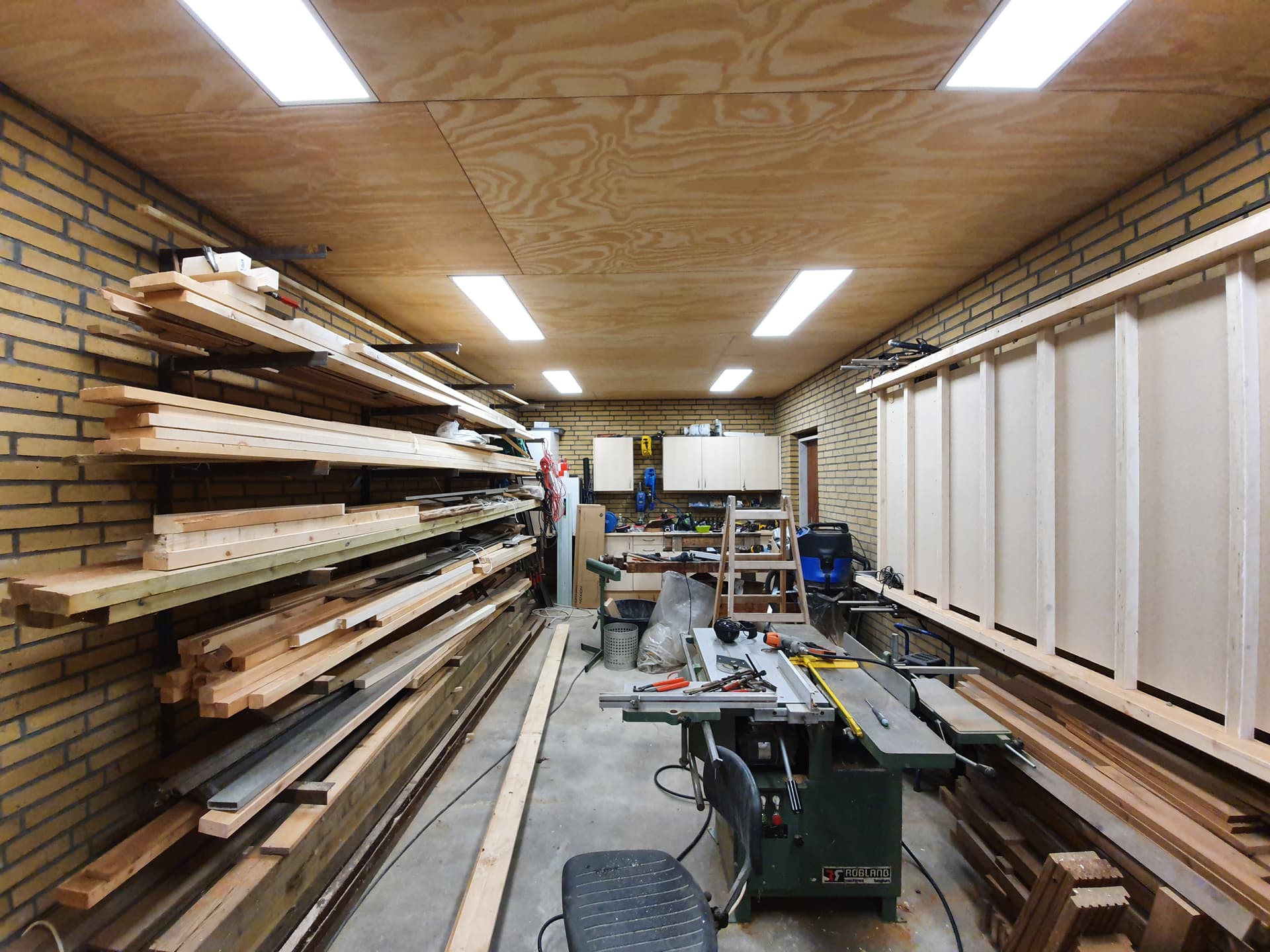

It will probably also require a major redesign of my table. Right now, I can fold the machine up against the wall to save space.

Do you think I can maintain the design of my current table as seen in the picture up against the wall? I’m having a bit of difficulty seeing if v4 is taller than v2?

YES. You will (probably) have to remove the gantry and store somewhere else while the table is folded up though. This is easier that it sounds and its easy to put back, since it indexes on the rail. The upgrade path is pretty inexpensive as well. I just did it (v2 to v4 upgrade) and was blown away - LR4 is a completely different animal. Rambo board should still work.
One thing to note is that the v4 needs a slightly wider table to achieve the same cutting area as the v2. I had to widen my table.

As for your table, you can use it but your working width will be a bit smaller as mentioned. Since you said you haven’t actually done large pieces, that may not be an issue. There’s a calculator that will help you determine what your working width will be if you use your existing table.
As for hanging it on the wall, that is completely doable in one of two ways. The simplest would be to remove the gantry and storeit separately. This is actually very easy since it just sits on a rail on one side, unlike the LR2 which was essentially captured on both sides. Your just release the belts at the ends and lift it off. Re-installation would take less than 5 minutes once you get familiar with it…you would place the gantry at an appropriate place, attach the belts and square the machine. Looking at your wall, there probably enough space above your folded table to have a shelf where you keep the gantry.
Another option, probably not ideal but possible, would be to devise some method to lock the gantry onto the table when it’s folded. Since it merely rides on a rail on one side and on its bearings (think “wheels”) on the other, you would need to have a way to fix the gantry onto the table using some sort of clamping system. In that case, you’d probably remove the router and then it would be fairly easy to design this clamping system.

*******one more comment re: the height. The LR4 gantry is probably slightly taller than the LR2 was. The ends of the LR4 are fixed and will determine the clearance needed to hang the machine on the wall with the gantry in place. If you have trouble getting this dimension from the STL files, it’s a simple matter for someone to measure it, but my guess is that it would be around 10-12”. If memory serves correctly, with the LR2 in the lowest z position, there was still significant protrusion above the table surface, but maybe not as much?
