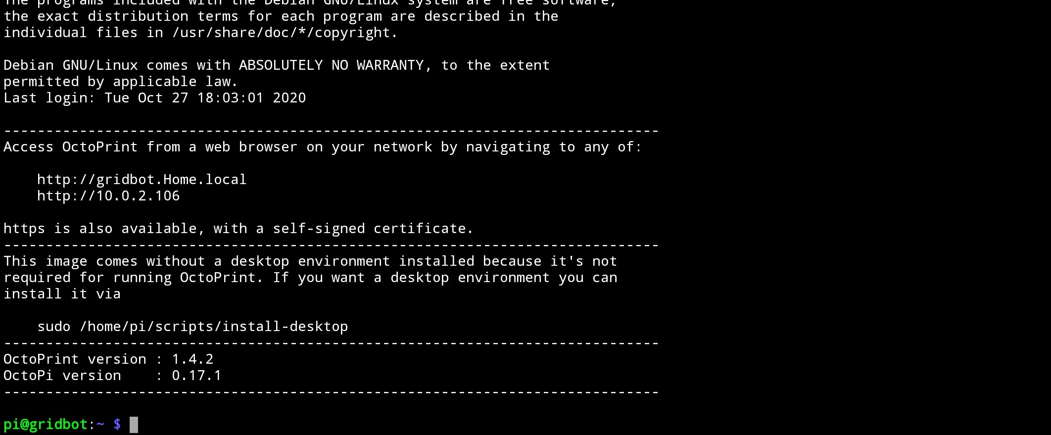

When you boot my image, you won’t find a desktop. It will look something like this:
It looks like it gives you the instructions for installing the desktop right there. Make sure you’re connected to the Internet when you run that command.
After that, you may not go straight to the desktop when the computer starts. To go straight to the desktop, you do this:
  • run sudo raspi-config from the command line
  • Choose Boot options
  • Choose “automatically boot to GUI as pi user”

I just recieved my Pi! I flashed the V1Pi and setup Wifi via ‘Visual Studio Code’
I run my Pi with a monitor and it works, but only in command line mode not desktop.
I ran ‘sudo raspi-config’
I chose ‘2 Boot Options’
B1 Desktop / CLI
B3 Desktop
Than it says: Do ‘sudo apt-get install lightdm’ to allow configuration of boot to desktop
I get an error: There was an error running option Bi Desktop / CLI
I tried http://v1pi.local on both my laptop and Iphone and it works!
I just recieved my Pi and I wasn’t sure what you meant… but now that I got it set-up I know, you just connect to the Pi via V1Pi.local… That’s an option too.
Did you run:
sudo /home/pi/scripts/install-desktop
And you need to be on the internet to run these commands. If you get any errors, you can share a picture of them here.

Yes it is working now, I forgot that step…
Yes I do want a monitor (I have a Dell one spare). I have the Pi connected to my main monitor now.
I was able to install Chromium and now I can access CNC.js!
