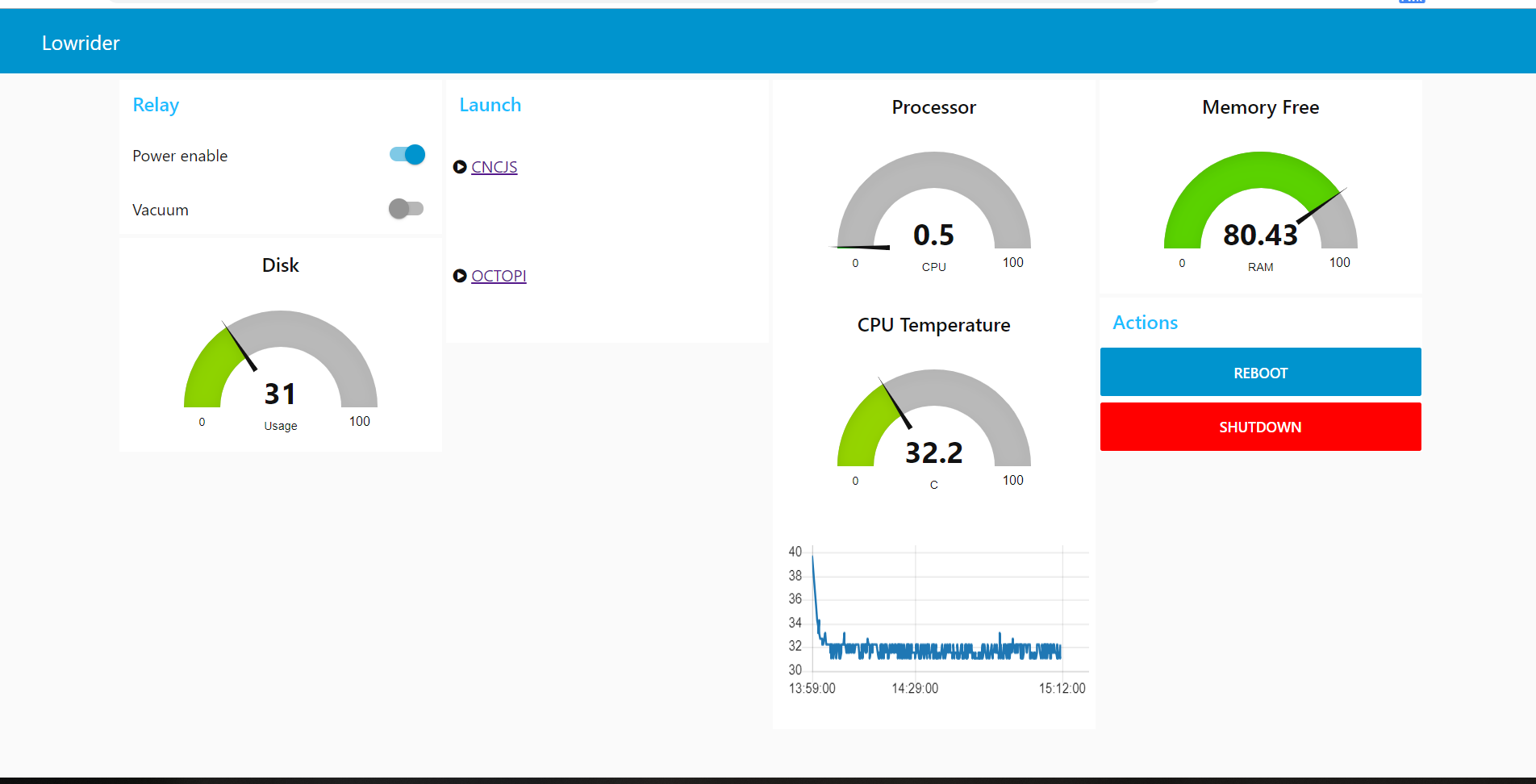

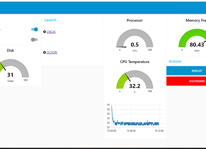

I’m trying to install node-red but this break cncjs. So I assume it have to do with nodejs version compatibility.
I am not sure. I haven’t used node-red in a long time. I tried to install node.js several times, in different ways, and the only one that worked was downloading and installing a precompiled version. Here is the script that generates it for the image:
And here are the params it uses:
Got a running version now with:
Node.js - v10.15.3
CNCjs - V1.9.18
octopi - V1.3.10
Node-RED - V0.20.3
rasbian stretch
Raspberry Pi 3 Model B Plus Rev 1.3
I’m up and running with cncjs! Thanks @jeffeb3!
