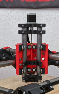

This is $350
and looks a lot like the MPCNC core.

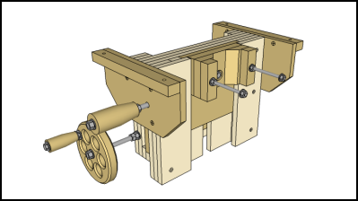

This design is interesting because it would be super easy to cut everything on the CNC. But I don’t think it would lend itself well to motorization because you have to lock in your adjustments.

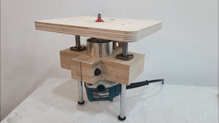

yeah I’ve seen those. I think his best design (the Odyssey) is similar to what I allude to when I mention buying linear rods and bearings. Basically get a pair of 16 or 20mm linear rods that have the ends tapped for bolts and some matching linear bearings. Bolt the rails to your table surface or plate then cute out a clamp for your router with holes for the bearings and your lead nut and you’ve got yourself a router lift. It would probably take 20 minutes to draw in cad then you could cut and stack parts out of plywood on the cnc or aluminum if you want to be fancy.
Something like this:

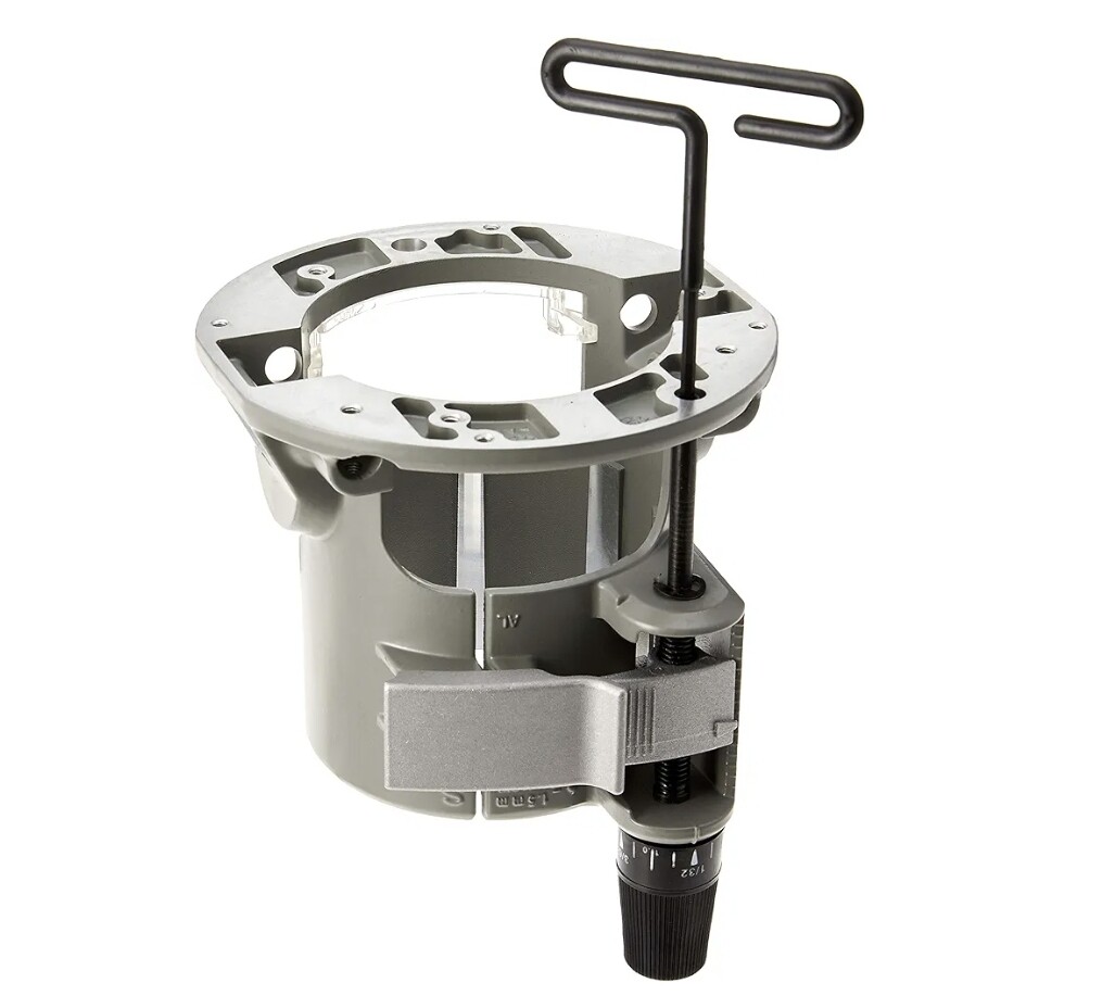

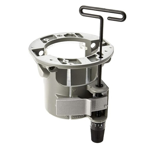

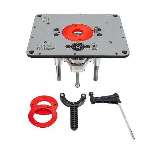

I have this one now since it came with my Bosch 1617 and it’s fine but I also hate it. The range of motion with the screw is pretty short so you have to manually release it and move the router to different positions. You also can’t raise it above the table to change bits.

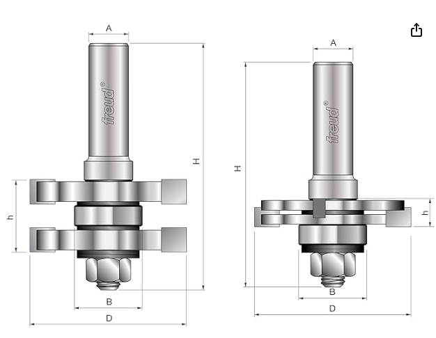

Could easily get to the same height. For example, some of the fancy bits that mate together. Pros will setup two router tables, but we could remember the z height and get back to that position.

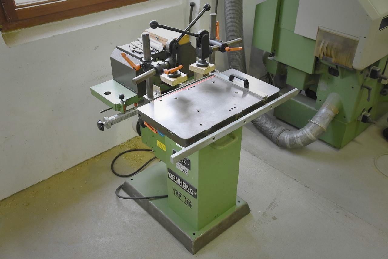

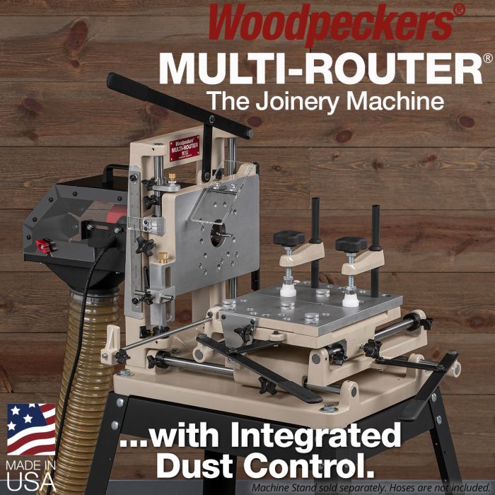

This is what I dream of you geniuses here figuring out - a programmable multi-router. Fans of craftsman furniture probably know who Stickley is and the guys in the prototype department use these things and they are pretty damn cool. Just think of all the crazy joinery that could be designed if this thing was programable.
That looks like a complicated Langlochbohrmaschine. :smiley:
Ooo or the PantoRouter we talked about before
These can be version 2 / another project lol
One of the big ironies of having a cnc machine for me is that building some of the crazy machines Mathias Wandel builds would be a lot quicker and easier but with the cnc machine I don’t need them as much.

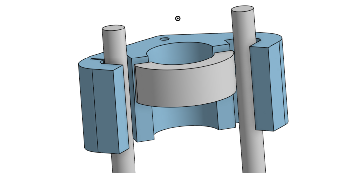

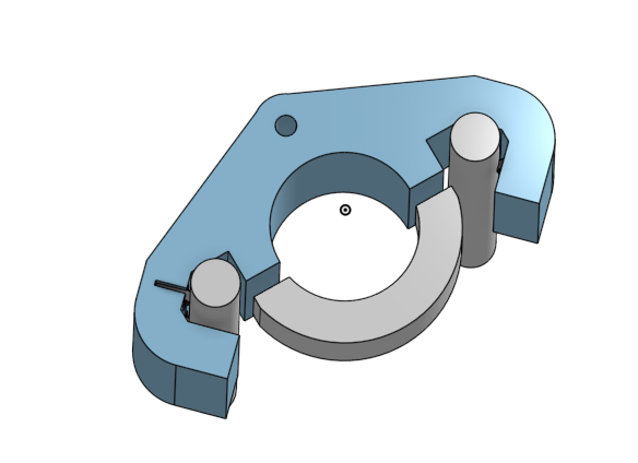

After shooting down the idea I decided to mess around with it a bit today haha. Here’s a link to my onshape document Onshape
Basically it’s like the LR4 core turned on its side. I haven’t done any of the bolt holes or the brackets to mount the conduit. I think I’ll have a one piece mount for both pieces of conduit and the screw on the top and bottom.
Any thoughts?

Yeah, their designs that I’ve seen use linear rods and bearings. Which if you want to use those the design is trivial and I’d probably just machine out of plywood or aluminum. The idea here is to used left over conduit and some 608 bearings.

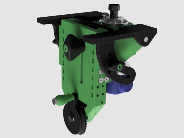

I had originally looked at making one of these printed tilting router lifts for my workbench, but it was all hard to get hardware for me.
In the end, I just bought a JessEm
