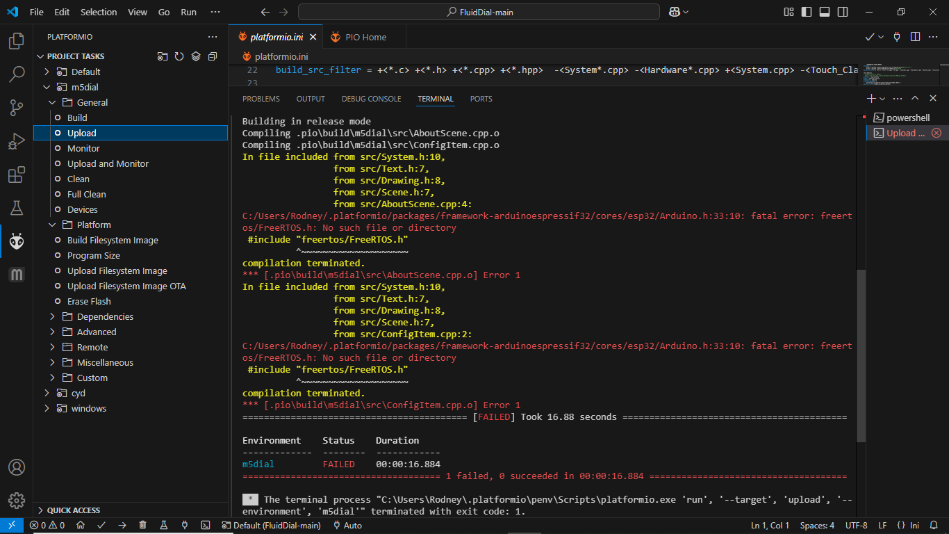

V1 Shop loaded Jackpot/ FluidNC and M5 Dial connectivity
I have errors, any ideas?
Thanks Rodney
UPDATE: Doug I think I got it, thank you. more questions may follow (hopefully not stupid).
When solving errors like this, it’s best to start with the first one, because solving it usually makes later errors go away.
The top error shown here indicates a framework is missing:
C:/Users/Rodney/.platformio/packages/framework-arduinoespressif32/cores/esp32/Arduino.h:33:10: fatal error: freert os/FreeRTOS.h: No such file or directory
I’d start by googling how to install “framework-arduinoespressif32”
I just closed everything and reinstalled from the beginning and walla! I have no intelligent answers but we’re moving forward. Thanks for all your prior work and open assistance Doug.
Thanks Rodney
OK, that actually makes sense. Something may have been installed on your first go through, that also required a reboot.
