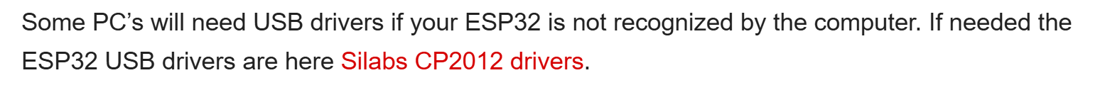

So my ESP32 crapped out on my LR4, bought a whole new board and my Jackpot came programmed for a MPCNC instead of LR (not sure if I ordered it wrong or it just got programmed wrong). I can’t get the drivers to load correctly on my usb port to connect through browser. Can anyone help? I wouldn’t mind learning the skills if someone has the time to help me figure out my USB driver situation. Idk if somebody can remote into my computer and help me get it sorted. If not I’ll have to return this board and order one correctly flashed.
Have you installed the drivers from the Docs? Jackpot CNC Controller - V1 Engineering Documentation
Also make sure your USB cable is a Data cable. Some cheap cables are for power only. Worst thing ever made.
You dont need usb flashing to change the mpcnc config to a lr4 config. Just download the correct config yaml from the v1 github repo
Very correct. I focused on the wrong part of the problem. Great catch @CesarH!
Here is a link to the config file for the LR4
