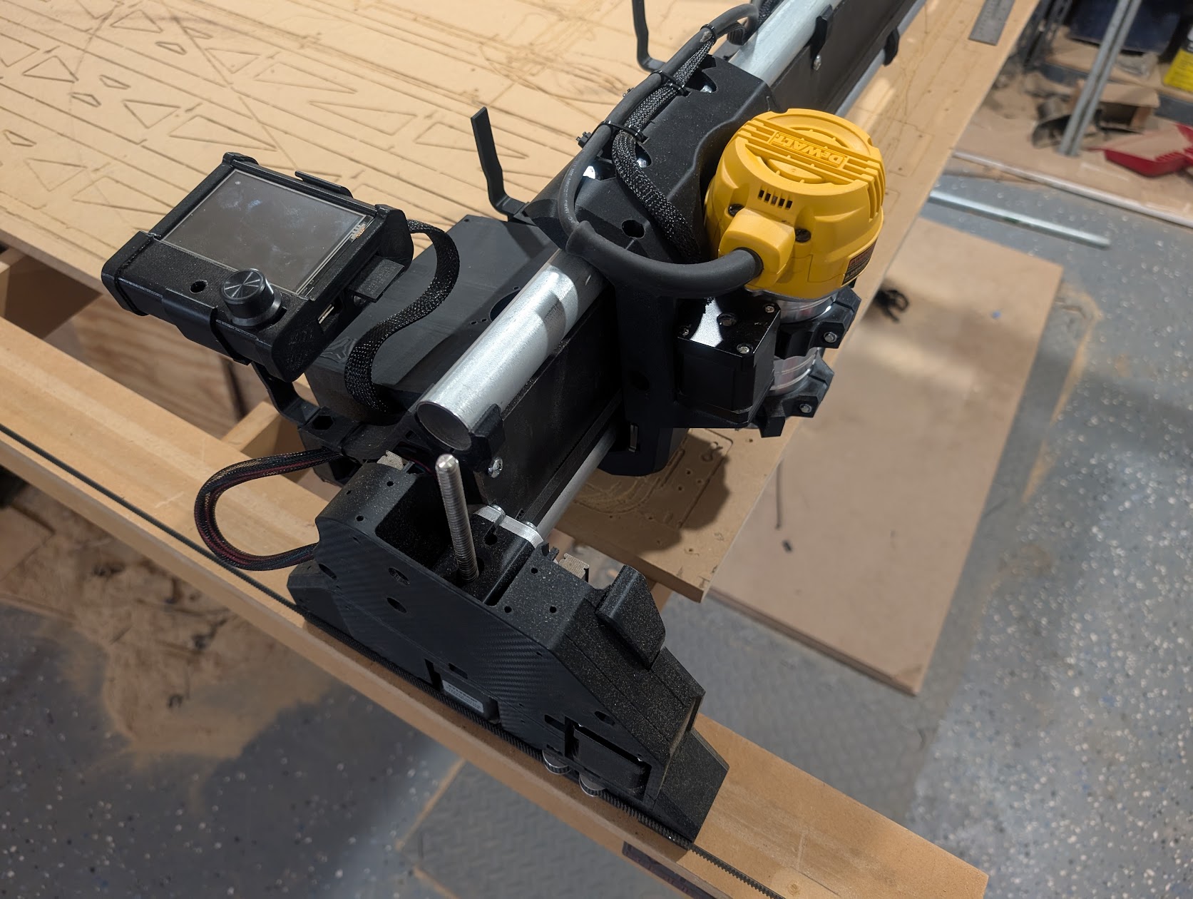

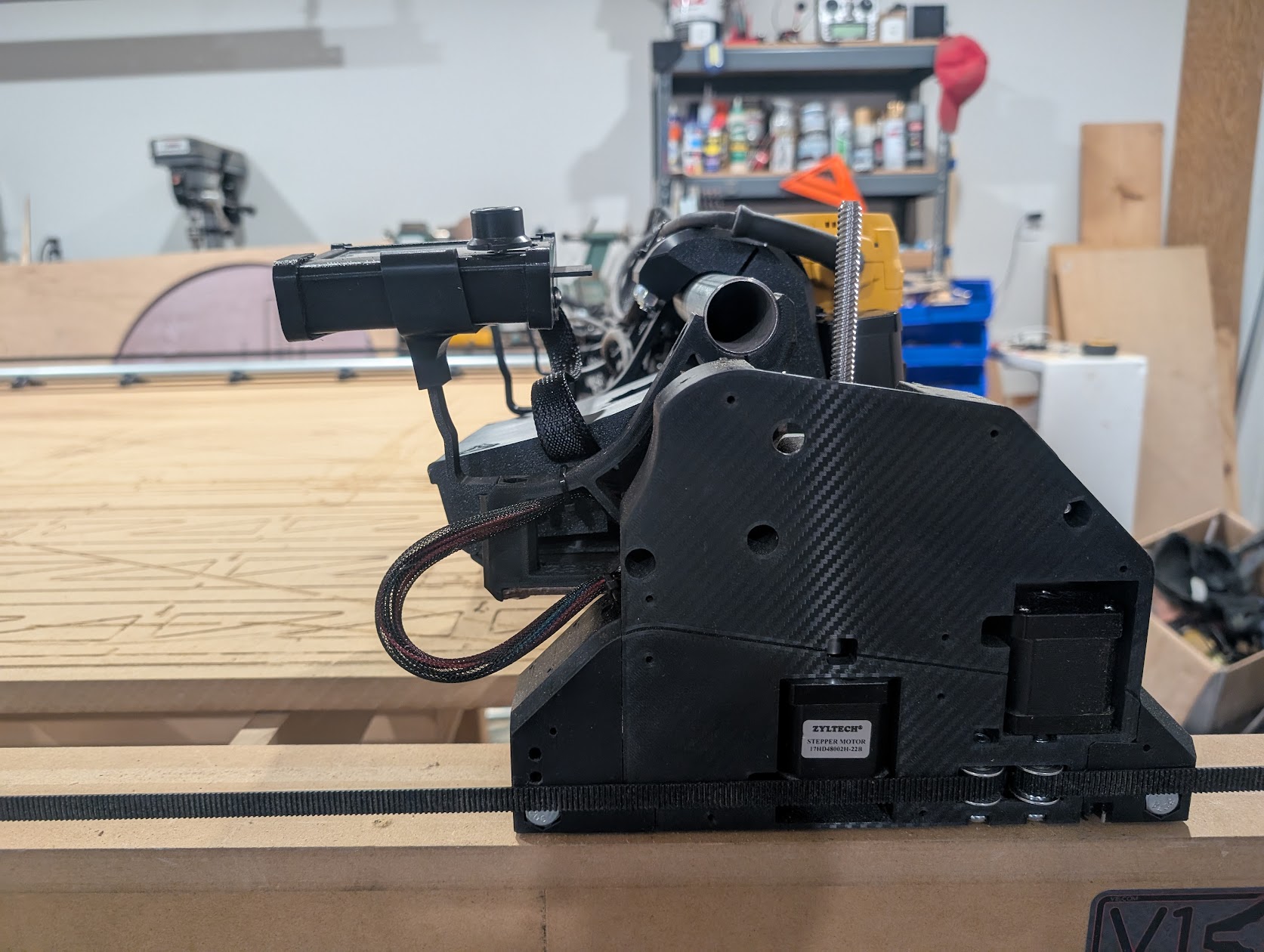

Used a ‘carbon fiber’ look on the faces of the outer YZ plates, jsut to give it that look.
everything is printed in PLA+

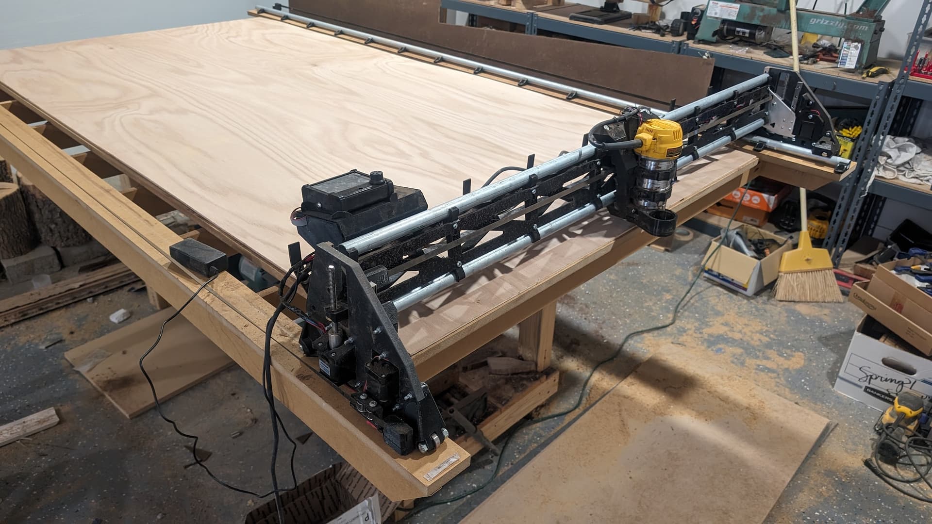

Since it’s an upgrade, I’m using my existing lr3 table, but I’m thinking of making it so it can flip up almost vertically for storage. It’s a 4x8 bed (so table is obv. larger than that), so cant quite flip it up fully vertically in a 9’ ceiling room
previous/current LR3 and its table

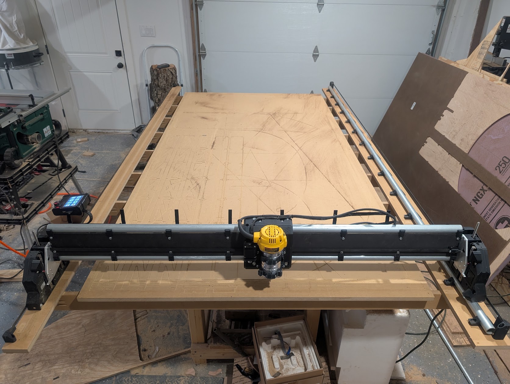

Finished the upgrade during my lunch break today.
Upgrade went smooth & the build was pretty straight forward.
I used the table (full sheet cutting area + some for approaching from the side) I had built for the LR3, just had to move the rail to the right of where the previous one was set. and will need to move my spoil board a little as well.

a few more pics from the side

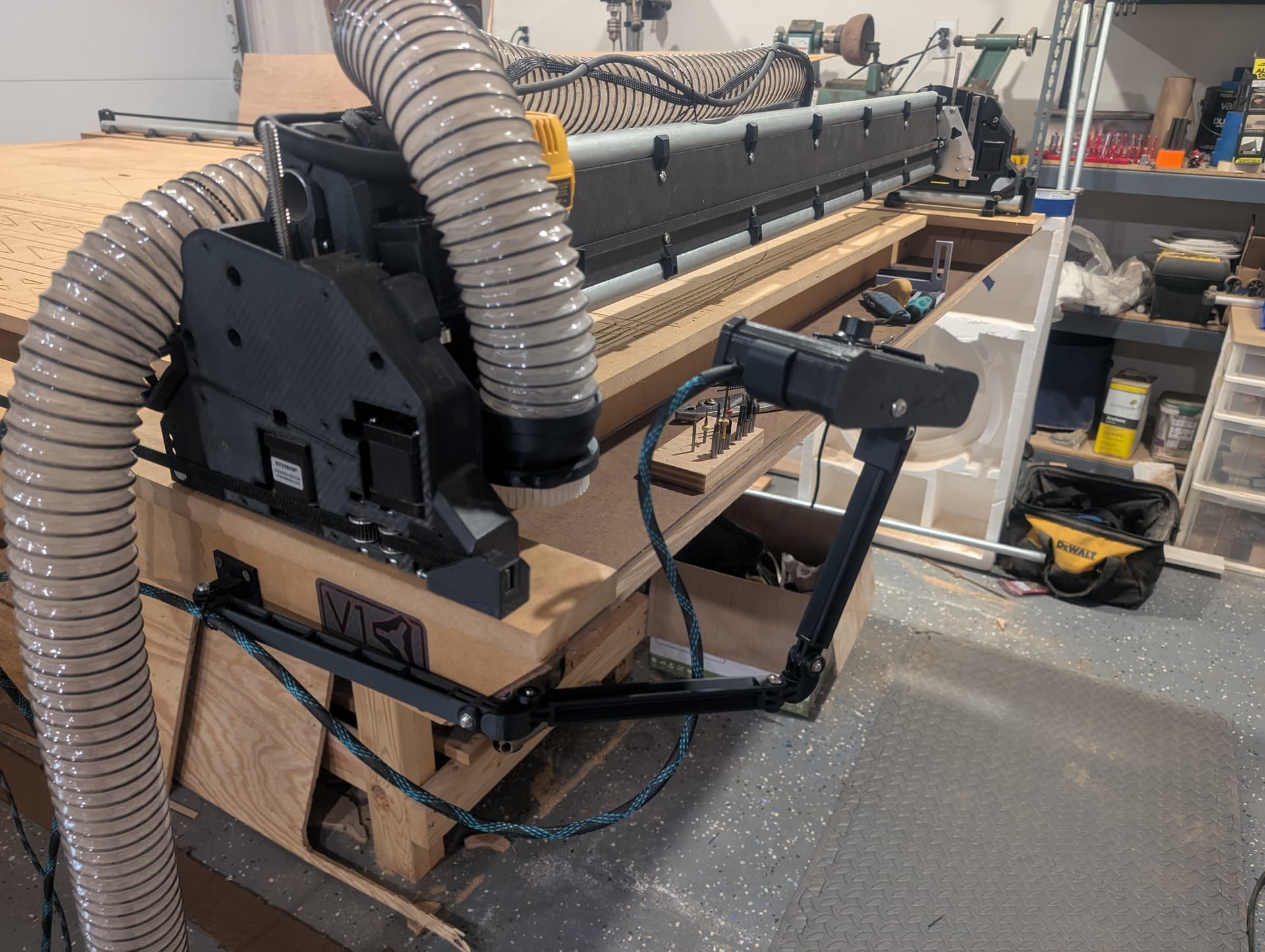

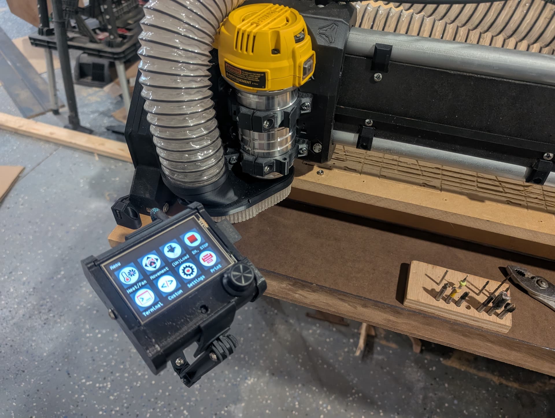

I got annoyed with the control panel being on the lr itself. So I added a GoPro mount to it and printed some arms. Let’s me pivot it out to the side if needed, and/or out front. Touchscreen can also be just plucked off it and reach anywhere like a pendant.
