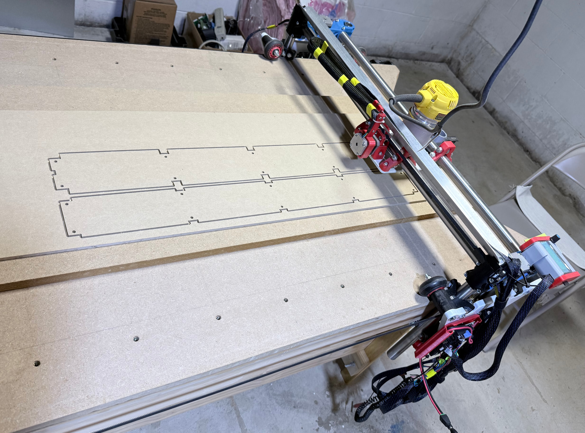

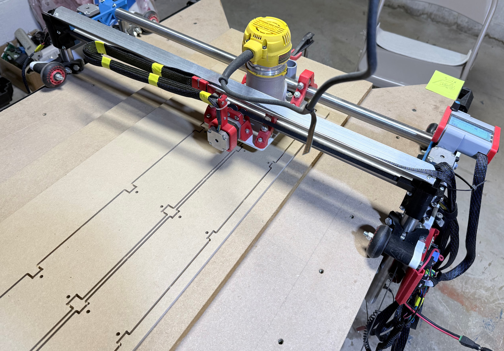

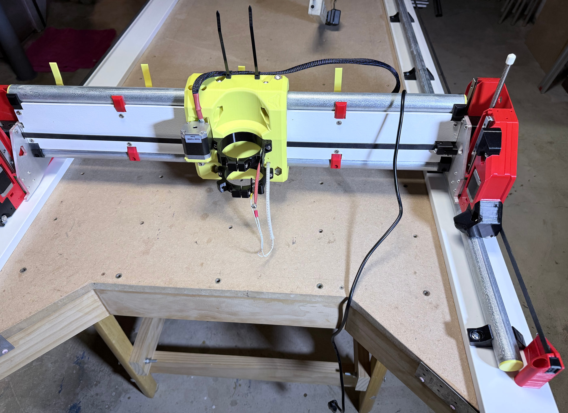

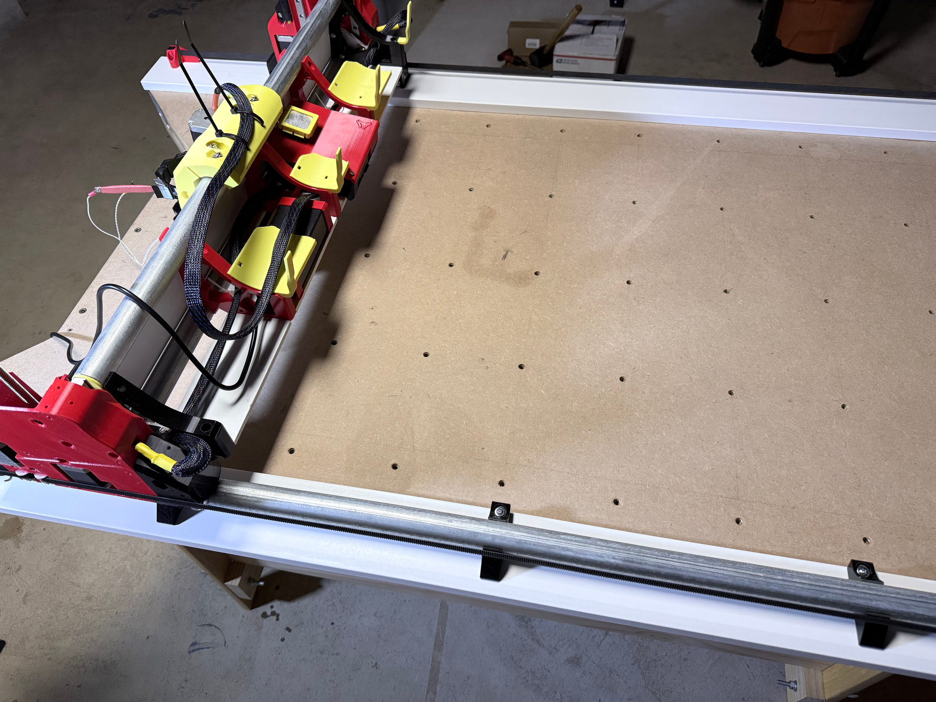

Upgrading LR2 to LR4
The first step - using LR2, did a Strut Plates:
The second step - convert everything to LR4, using parts and table from the old machine.
All printable parts were printed using the pretty old Creality Ender 3.
Many thanks to V1 Engineering Team!!!
:smiley: :+1:

Have you tried any cuts yet? Notice a difference?
The main differences are:
  1. FluidNC vs Marlin. WebUI on laptop vs 3.5-inch Touch Screen - I love it!!!
  2. Dual endstop on Y and Z - easy homing setup + Z probe. Finally, I did a good alignment of squaring!
I am still in progress to finalize my building, so there are no real cuts yet, but the Crown test with V-bit was successful :slight_smile:
Thank you very much, Ryan!
