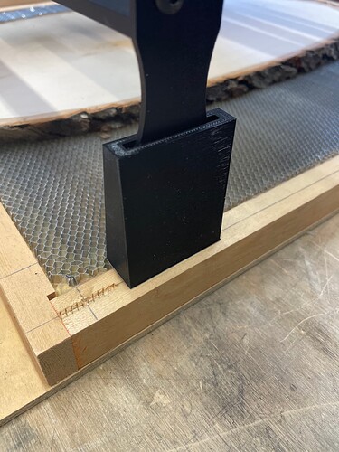

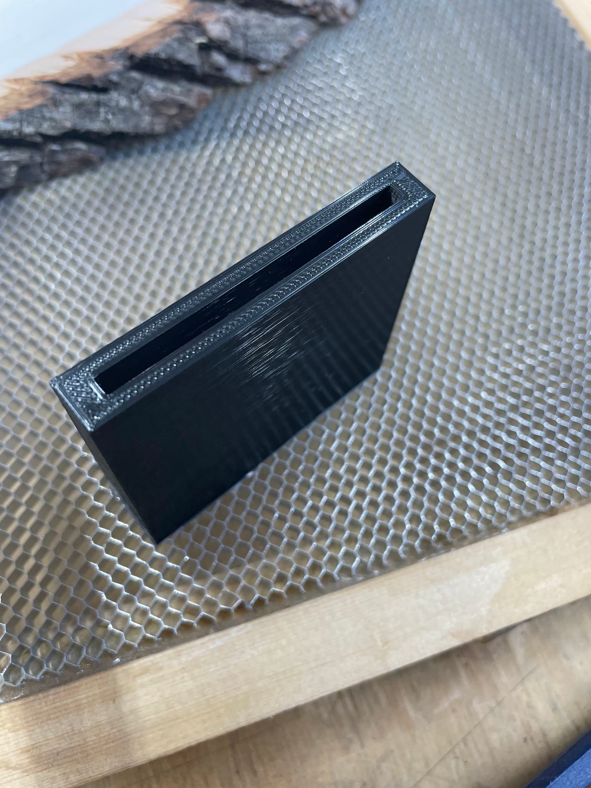

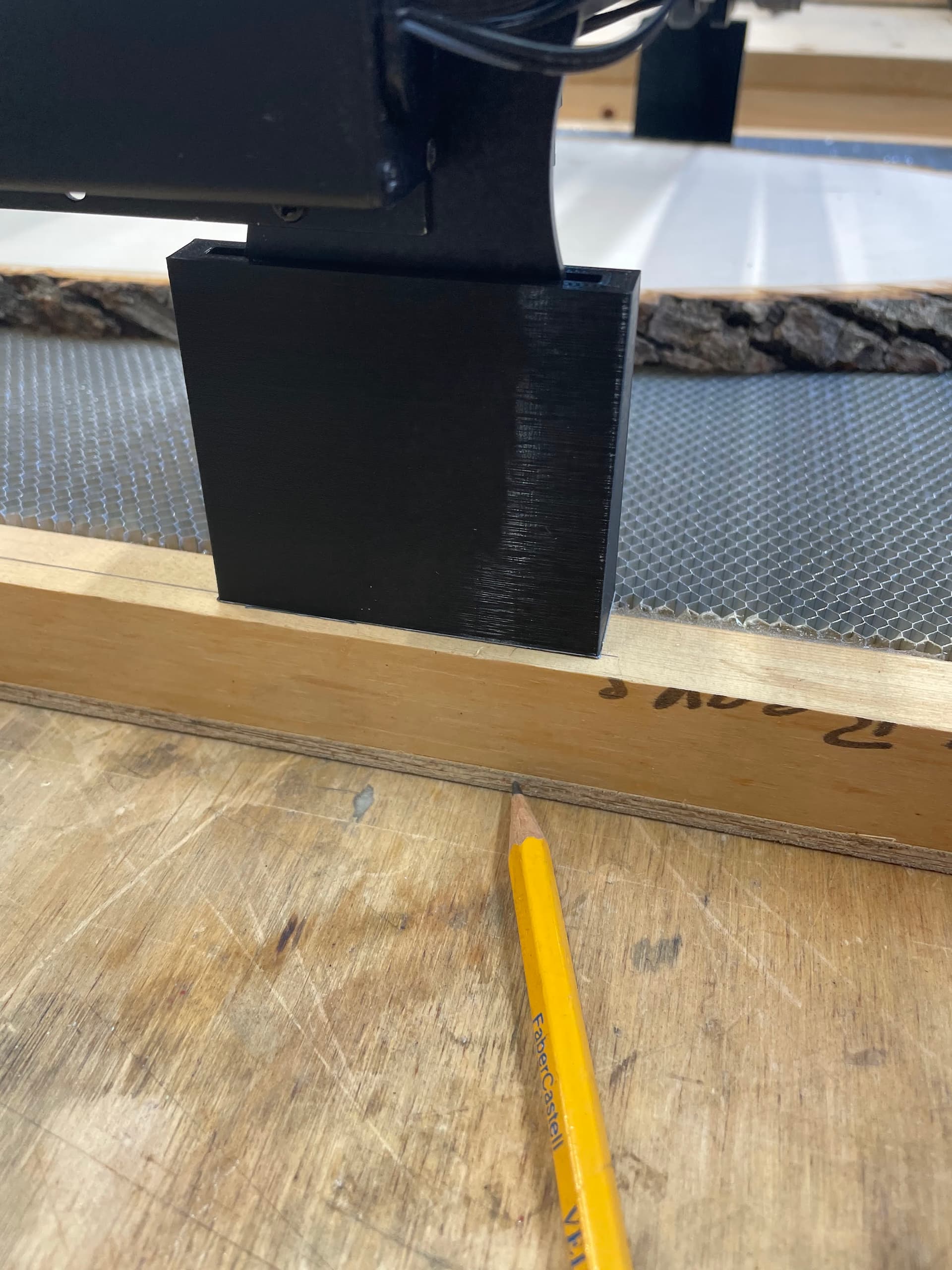

But! I did make an upgrade to my JL1 and will post the parts on Printable later tonight. I wanted to engrave on thicker and longer pieces that could fit under the frame of the JL1. So I made these:
Three of them are the same size and fit the narrower legs of the unit and the last one is for the leg under the controller board. They raise the base 50mm and using the other Dave’s sliding Z-axis I can still go right down to the surface if I need to. I was thinking of gluing them to the legs with epoxy, but have decided to just use them when I really need to raise the machine.
You can see the wood slab that I intend to engrave on the honeycomb in the pictures.

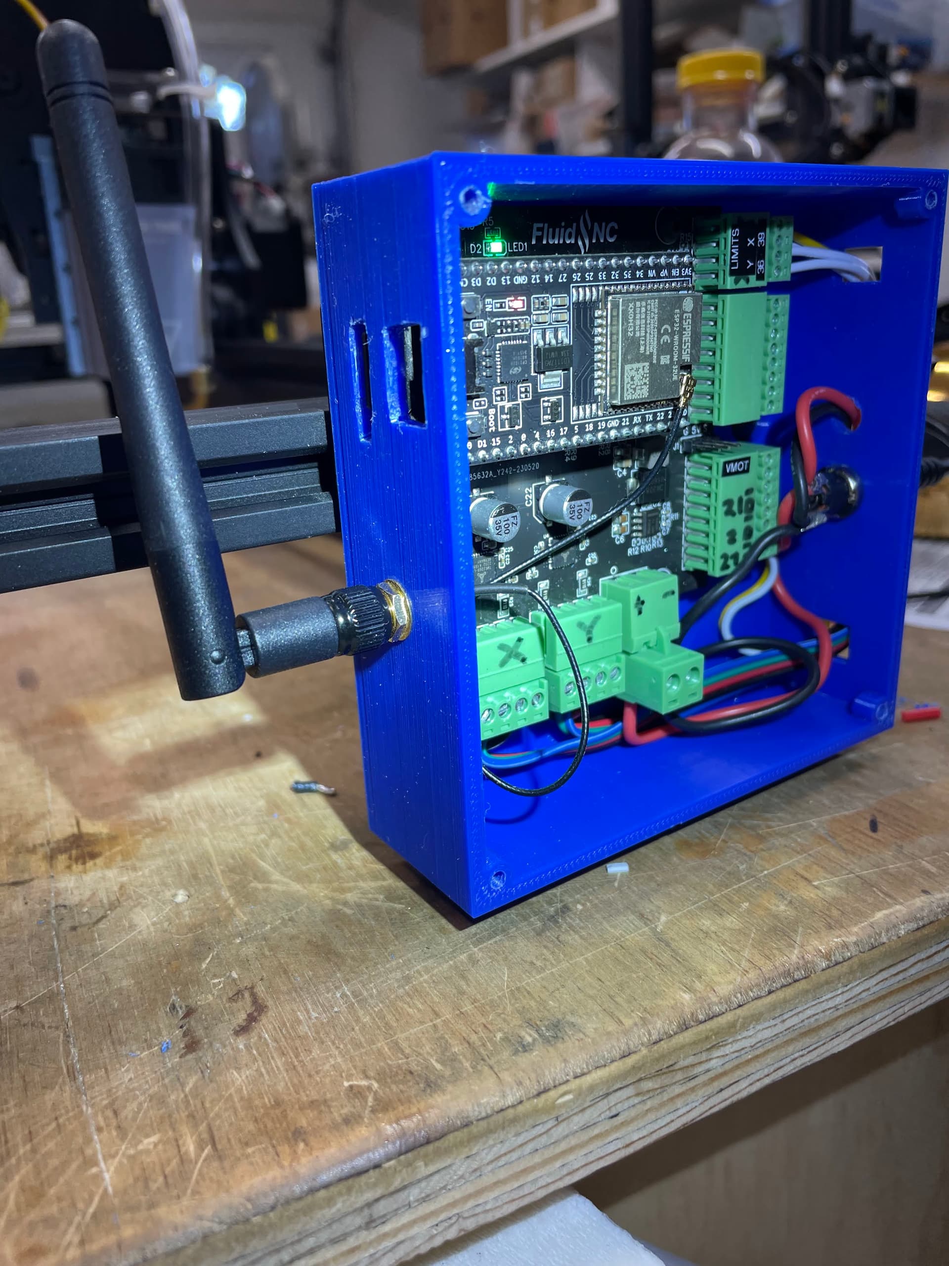

I have finished the controller box for the BDring FluidNC TMC2209 Pen/Laser controller, so that it attaches to the existing mounting holes of the JL-1. Here are the picture (without the matching lid).
I have updated the model in FreeCAD to correct the misplacement of the ESP32 access holes on the left side of the box.
If anyone would like the model as a STEP or STL file I’m happy to post them. I will be also making a posting on the LightBurn forum as soon as I put the files into Thingiverse and Printables.
