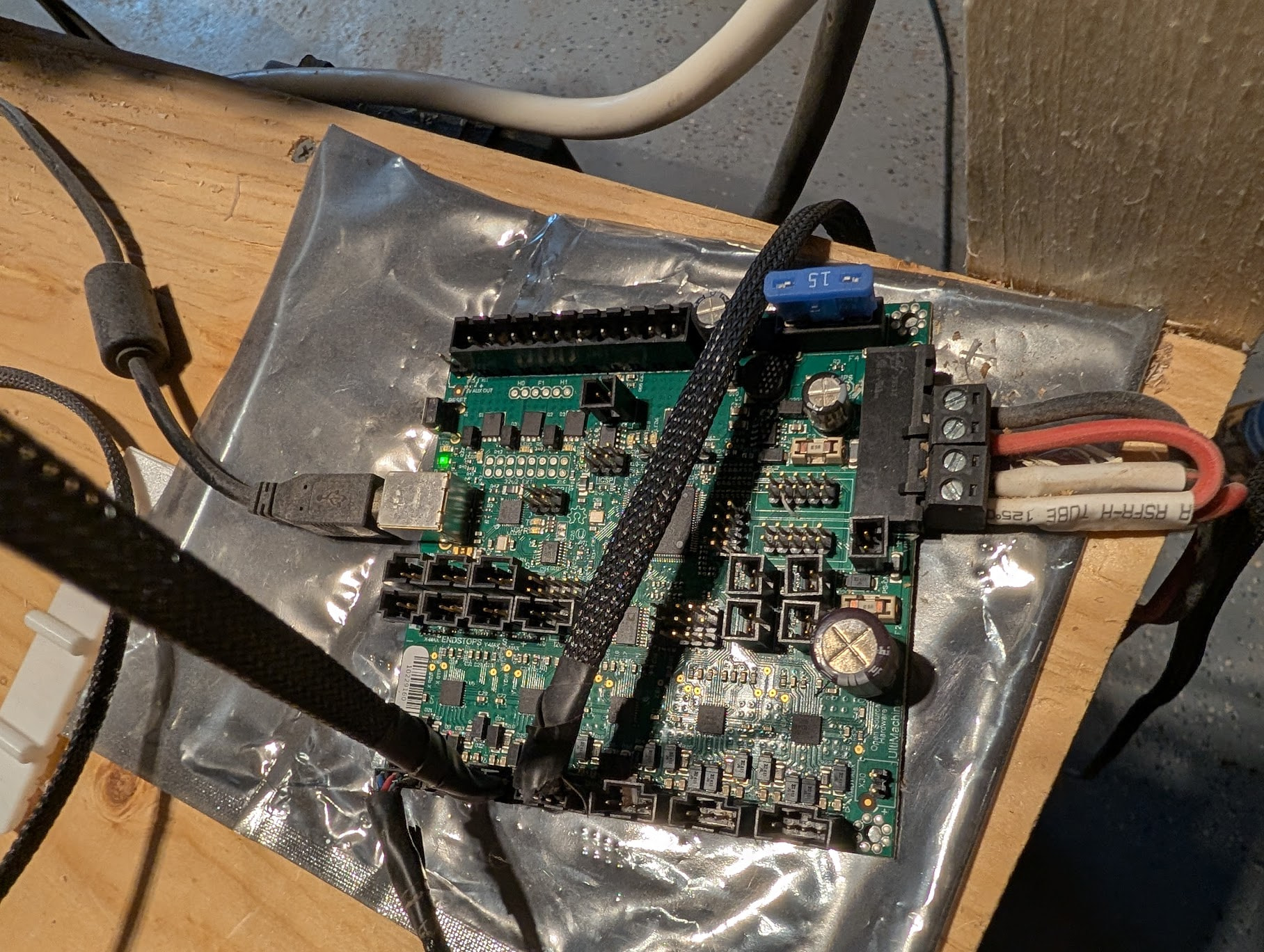

If I can use the motors and rambo board, that will make life a lot easier. I should be able to easily source pulleys, wires, nuts and bolts easy enough.
Even if you decide to go with the LowRider, you can still reuse the nuts, bolts, and bearings.
Be sure you’ve got he full Rambo and no the mini. The full Rambo has 5 drivers so should be fine for the LR4. There is also a mini-Rambo with 3 drivers, which isn’t enough for the lowrider.
