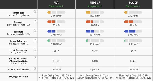

In this filament chart from Bambu PETG CF is slighter stiffer than PLA with better heat resistance and toughness. PLA CF is very stiff but lacks the toughness and heat resistance.

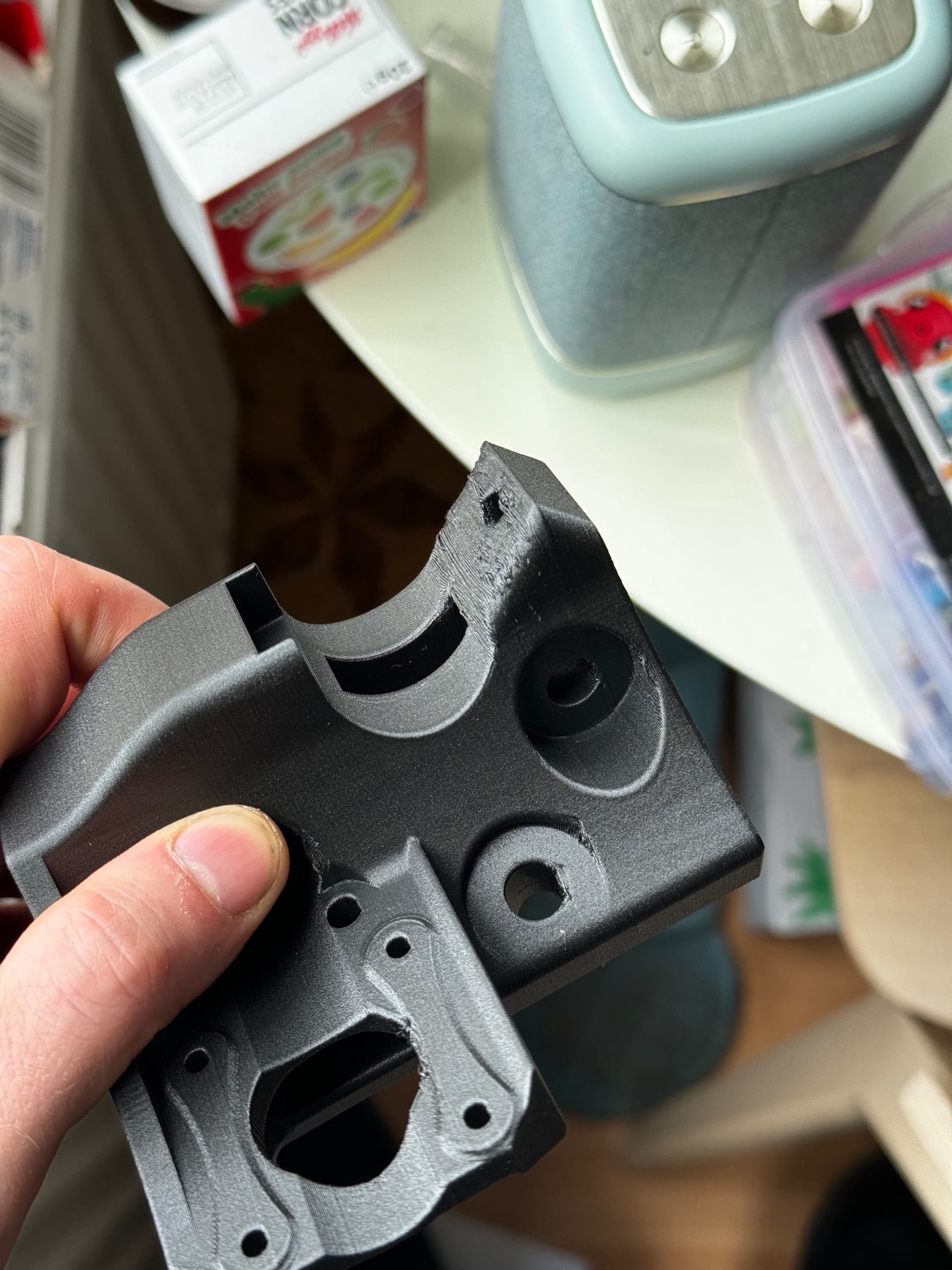

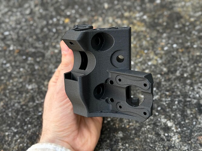

First test print of PETG CF. I dried the filament for 8 hours at 65C a few days ago. Printed open air on my A1 Mini.
I couldn’t see any warping once the print had finished (which happens with normal PETG sometimes).
The part looks very nice. Overhangs are not bad.

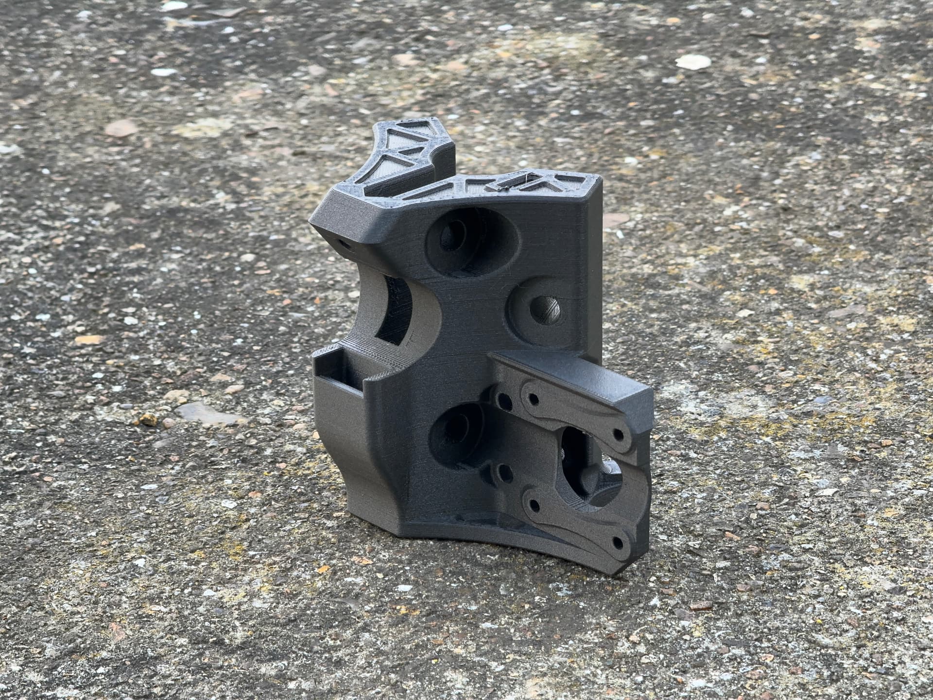

So I’ve been printing out my corner parts for the Primo build in PETG CF. They look fantastic. But I’m concerned about the rigidity. I’m using Eryone PETG CF which has no data sheet. Some filled filaments use small fibresn (good) and some CF powder (bad).
I don’t think the corner parts will make much difference to the cutting when printed in PETG CF. But for the Core and Clamps I think standard PLA might be a smarter option.

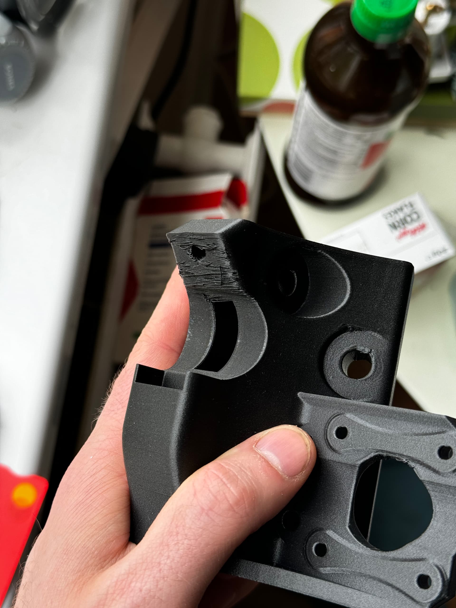

@vicious1 Are these parts usable? It’s gotten hot in the last few days and now I’m struggling with good overhangs.
Yeah they should be fine.
