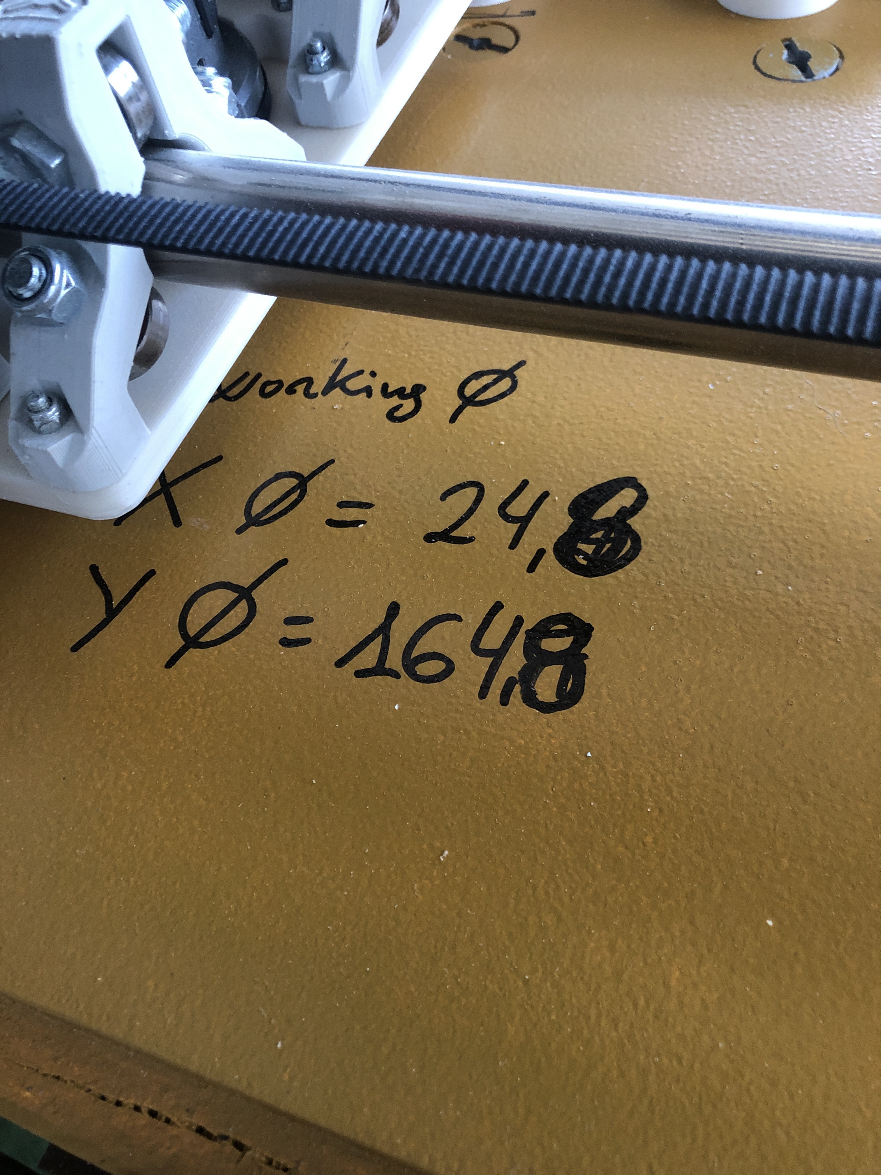

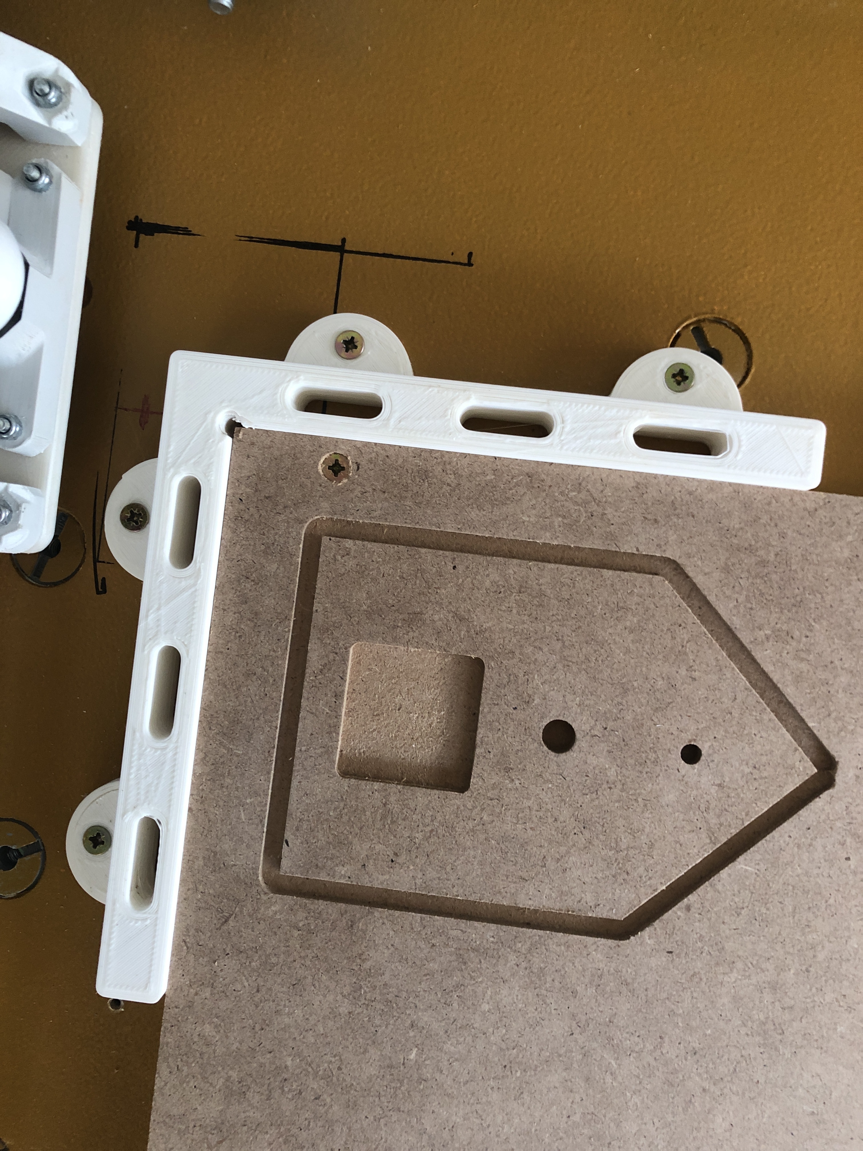

I also designed a squared holder for my spoil and working wood…with a hole in the corner where i’ve established to be my working zero…and it works !!!:joy::stuck_out_tongue_winking_eye::+1:
Now I can repeatedly move my gantry to this X and Y coordinates to start always at my zero…

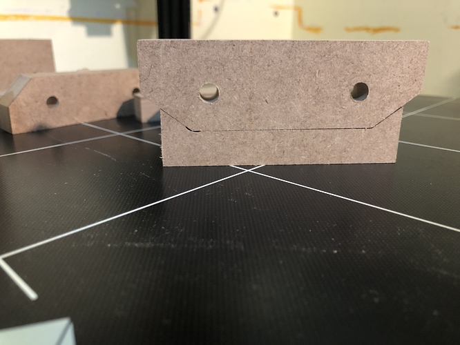

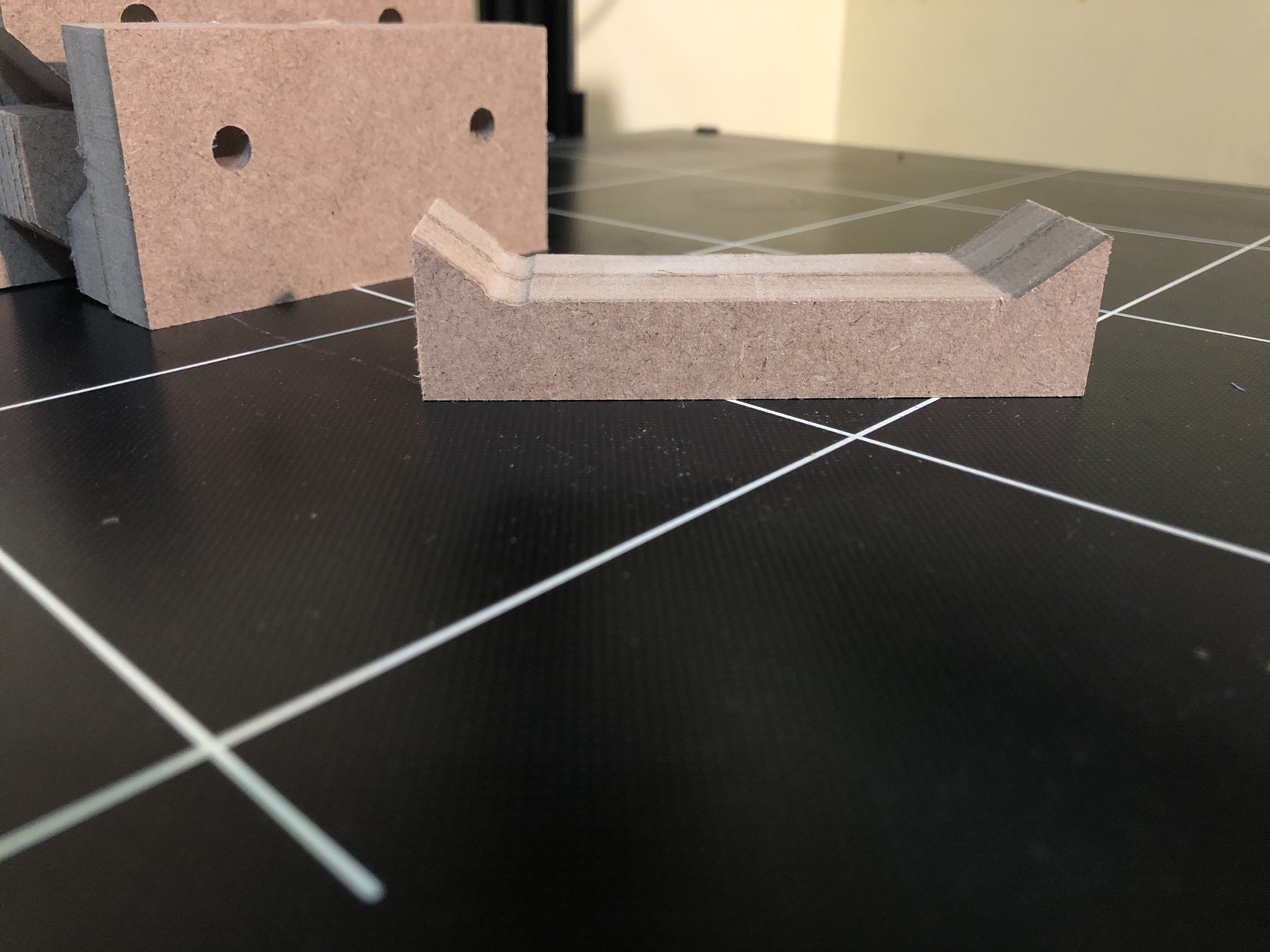

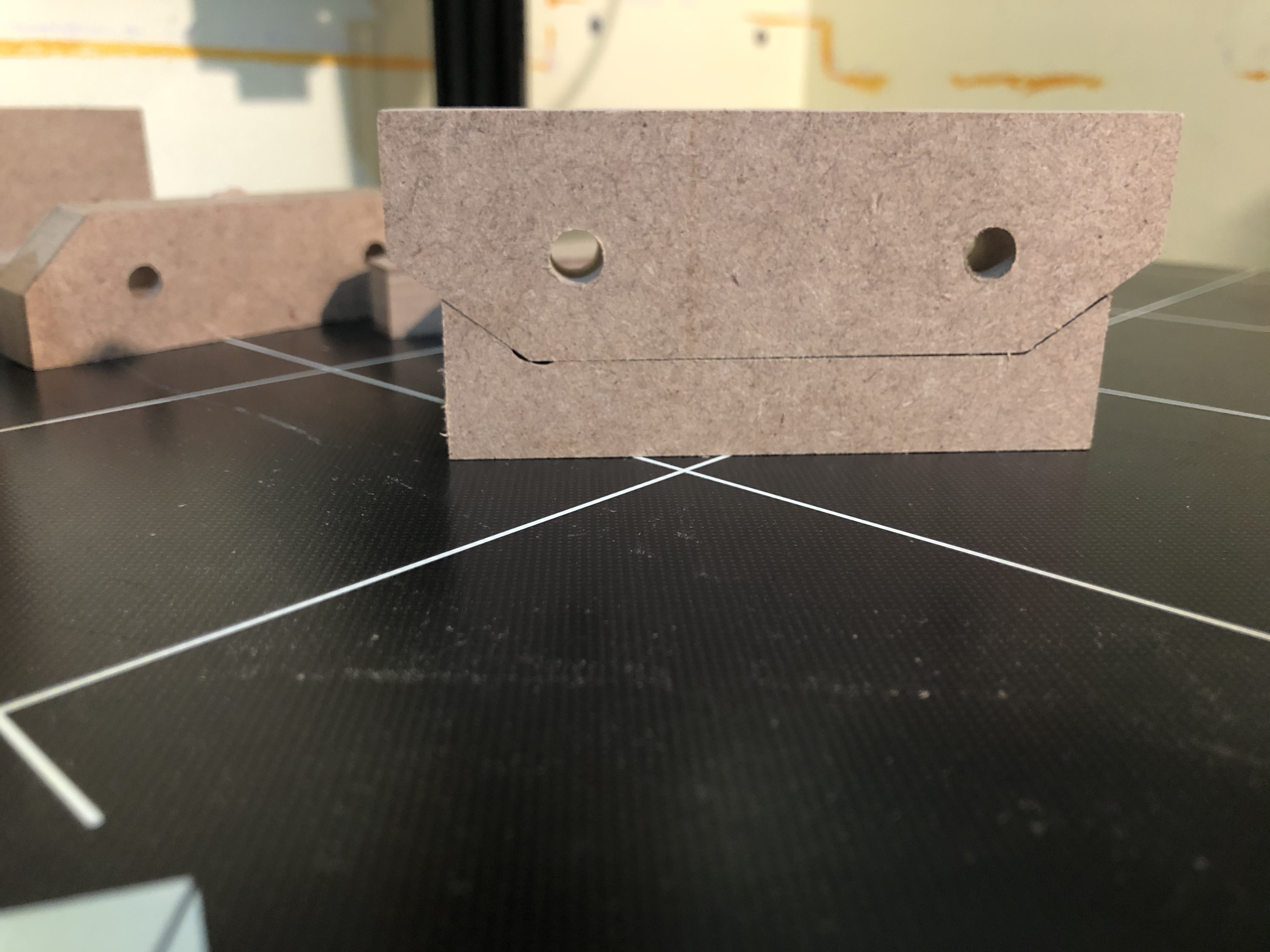

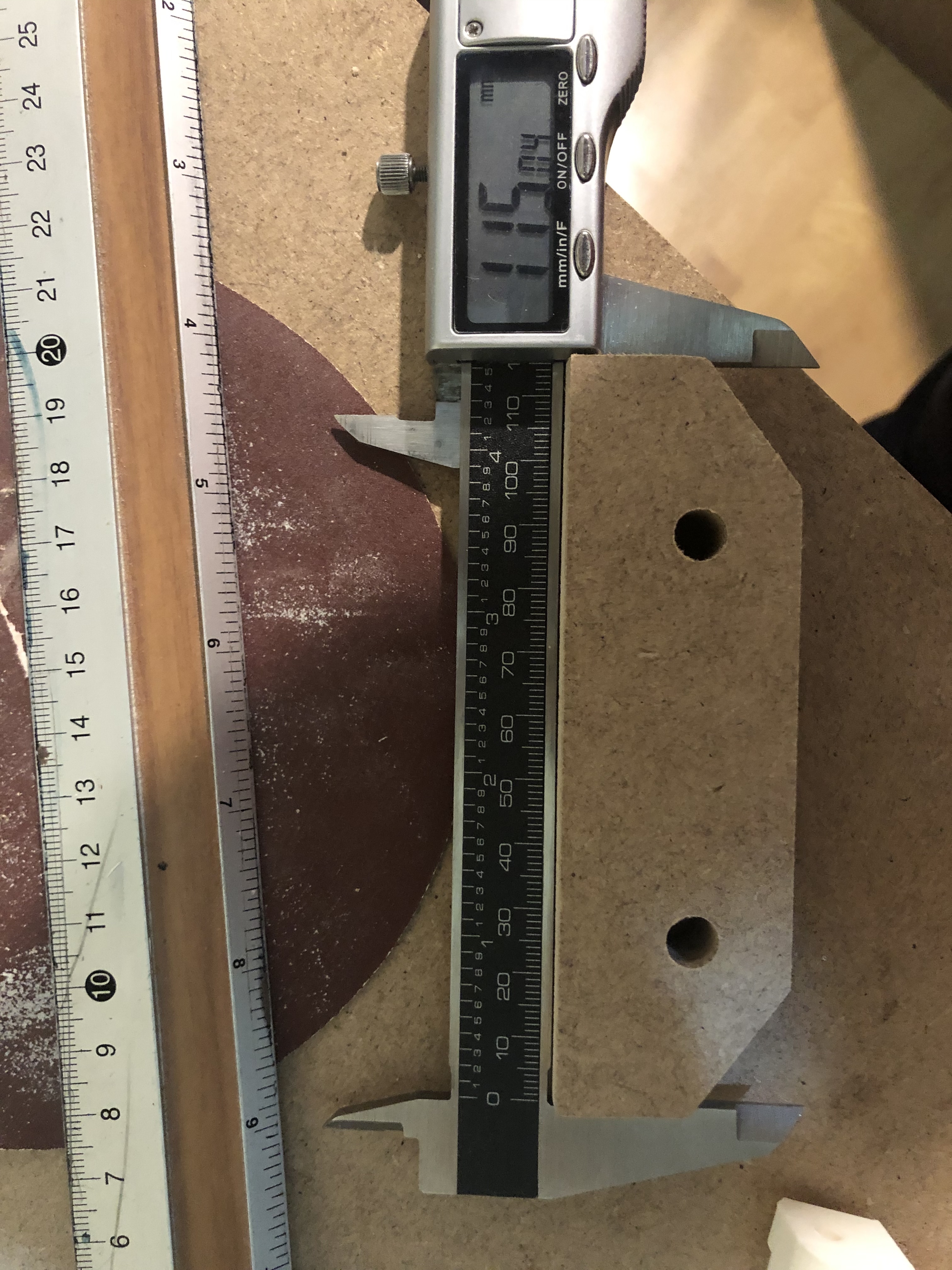

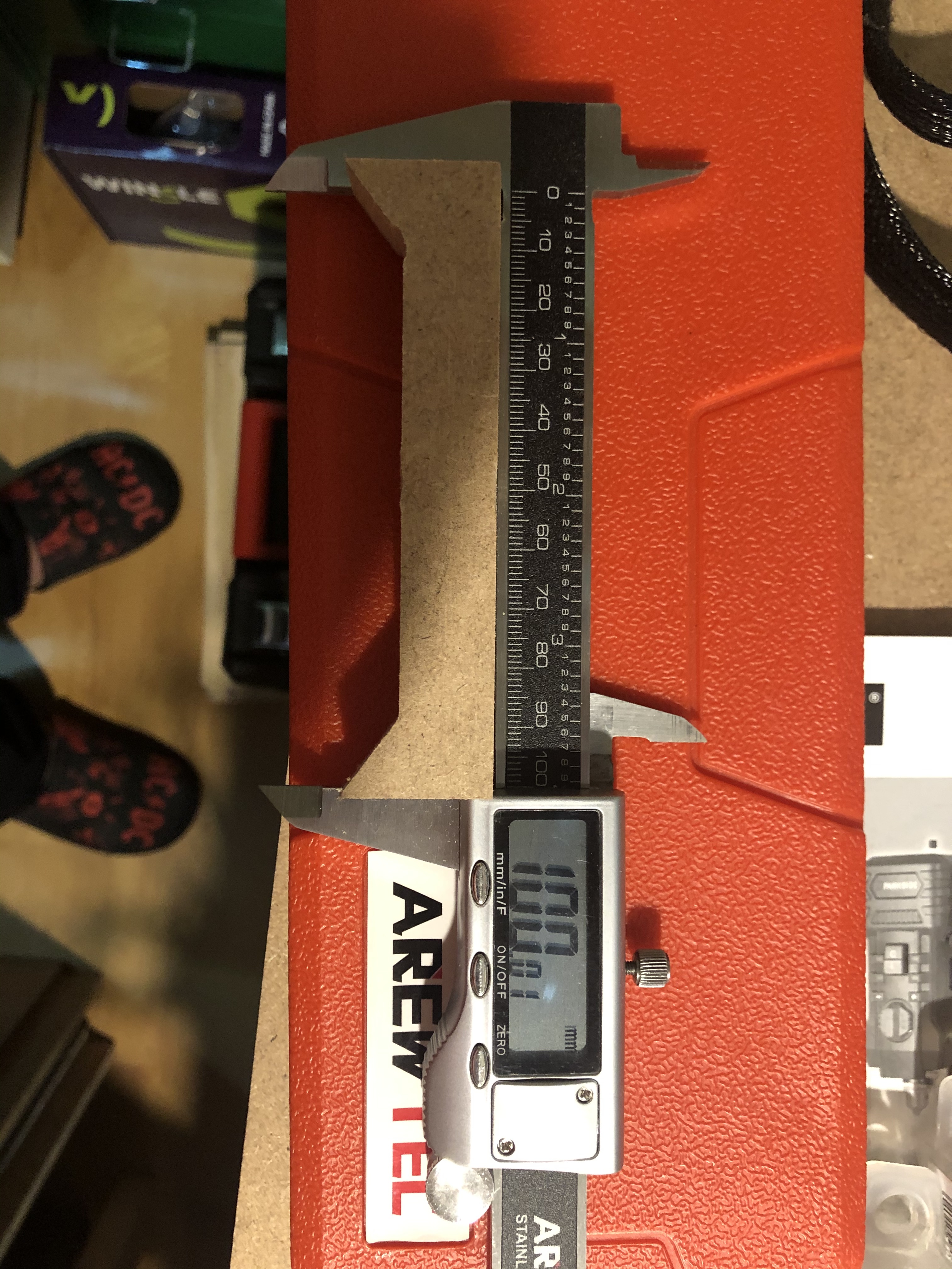

Helical holes are not 10mm as intended…guess the bit is not 6mm but what the plunged hole shows…around 5.9mm…so if it’s done 3 passes it’s lost around 0.3mm which makes sense to me. Something to consider when designing…
In which case, would it not be better to define that tool diameter in your CAM software, and still design the part to be as you want?
It has just as much to do with the operator as it does with me so congratulations to you as well my friend.
That will be my first option, doing another helical routing test and see if it solves the deviation…which it should…:crazy_face:…but yes you’re right there my friend.
Once the bit diameter has been adjusted to reality the results are of unbelievable accuracies…can’t believe my eyes…and repeated parts are consistently cloned…I’m a happy man with a finely tuned machine !!!
All done on a 6mm…actually 5,92mm single flute CMT bit …here are my parameters used…sure I can push it a bit faster but next cut will try at the same feed speed but higher DOC.

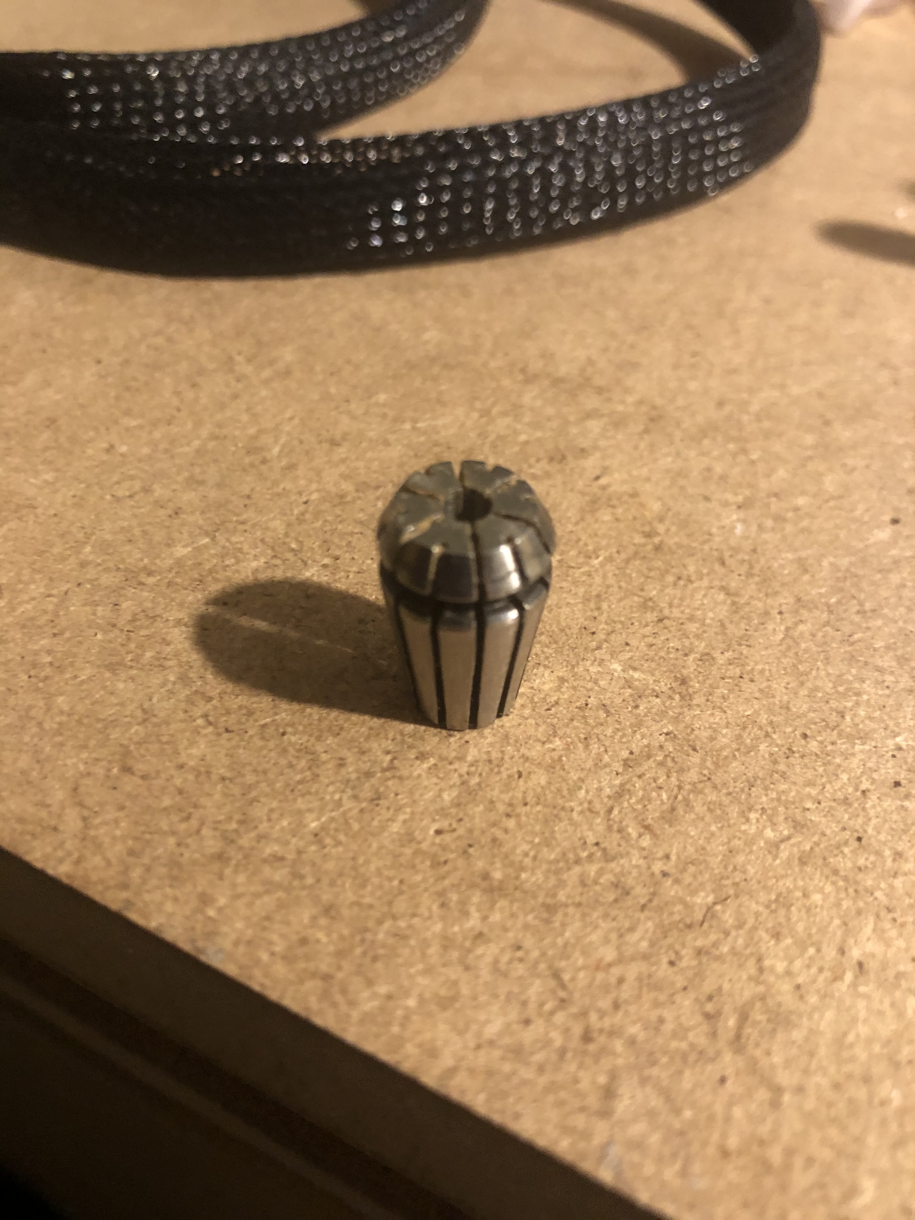

If your router has a standard 1/4" collet remember that you’ll need a “Collet Reducer Adapter” to go from 1/4 to 1/8.
Those adaptors have had rigidity and holding problems in the past. Better to find a collet for your router that is 1/8" size.
No worries, I bought some collet adaptors as the Katsu (Makita cheap copy) only comes with 6 and 8mm adaptors. So far they work the treat…but thanks for telling me. :+1:
These ER11 collets
