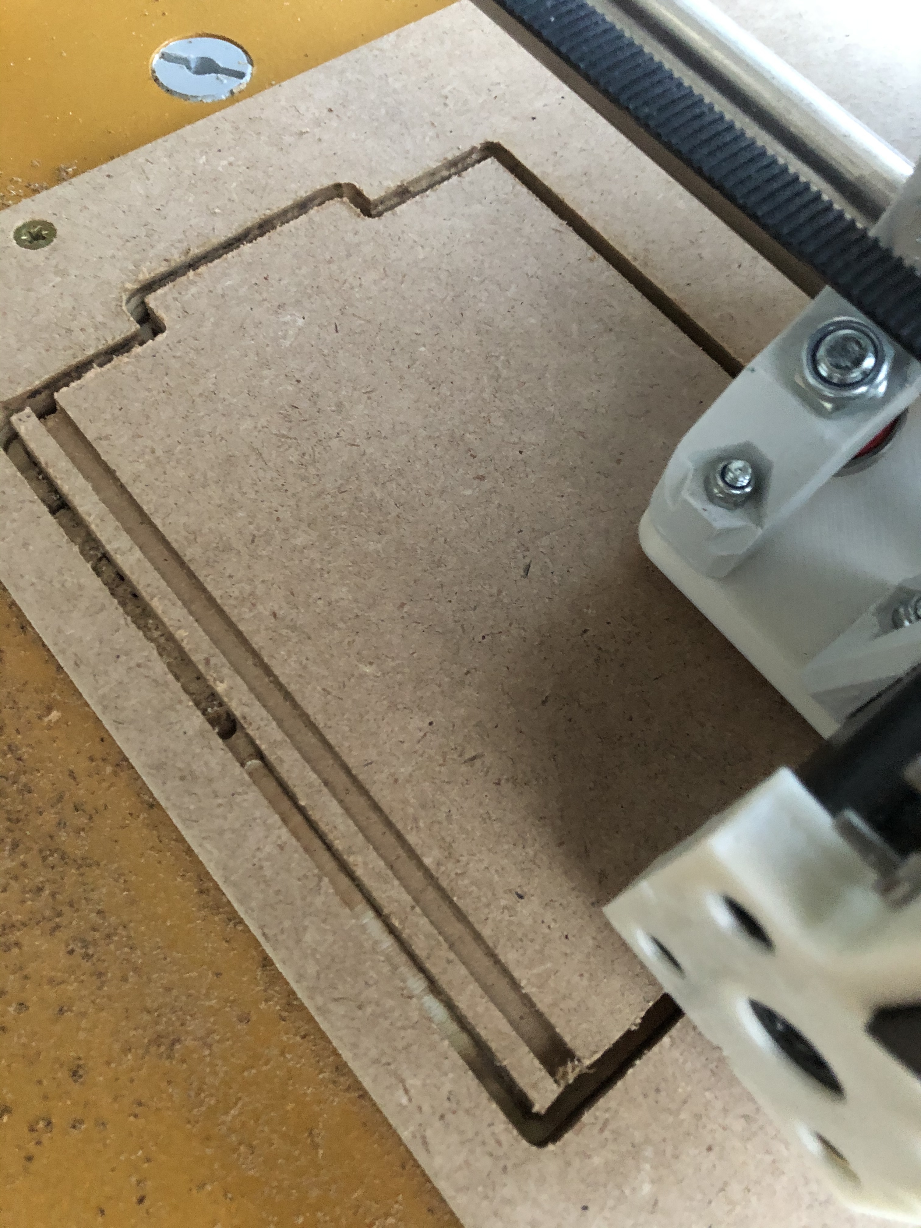

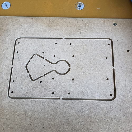

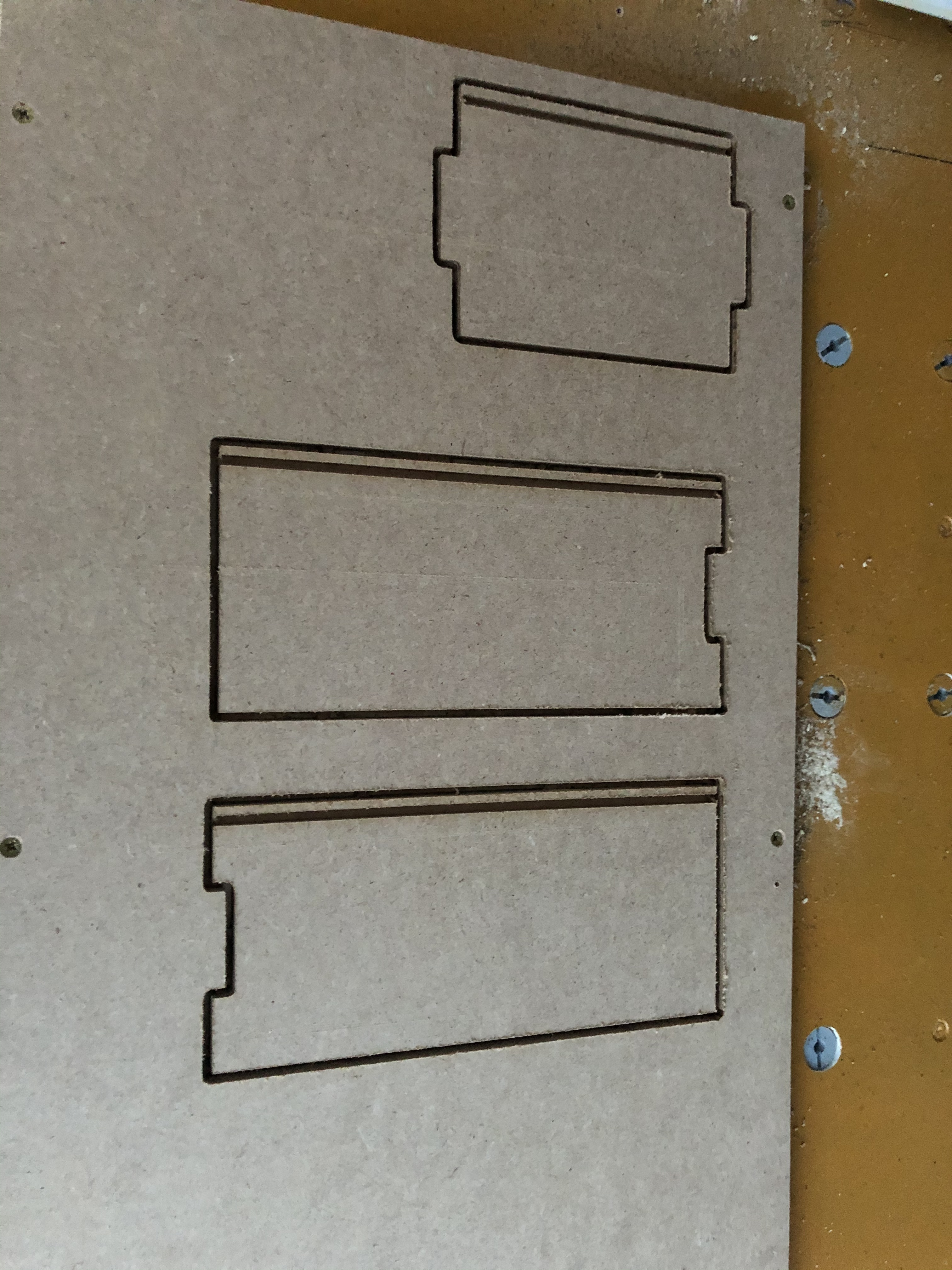

@Tsander here’s my first decent job…still needs some fine tuning but really happy with the result…I’m actually very impressed !!!
Finally went on a 2 flute bit, speed of 8mm/s, plunge of 2mm/s and DOC of 3,65mm and it worked without breaking the bit…I’m not too sure though if I have to keep router rpms at 22.000 or lower them…I’ve learnt the hard way that anything above that will break my bits on MDF.
Àlex

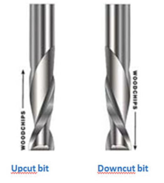

Hope this question is OKEY here since you are talking about upcut and downcut. I didn’t know that was a thing before this thread. I am not done with my LR2 build yet, so I’m just gathering information at this point.
Is this the only difference between upcut and downcut bits visually?
Also, I then noticed that I only got 4 flute downcut bits flat end mills. Are those good for plywood and wood in general?

@dailybombs I didn’t know either before going into this new world of CNC…upcut bits chip out so there’s less risk to catch up fire due to friction and leave a very nice finish at the bottom end, downcut bits and more prone to catch up fire on hardwood and chips are more difficult to evacuate from your job, but will leave a very nice finish on the top surface while cutting.
I’ve only used upcut bits so far, maybe when I’m more comfortable with CNC works will try the downcut ones.
Hope it helped you !!! And now get your hands on and finish the LR2 and enjoy it !!! :+1: :love_you_gesture:
Àlex
That is the only difference. The consequences may not be obvious though. I didn’t see any extra danger of fire, but pushing the chips down caused the bit to wander sometimes. Especially in right sides like plunging or drilling. It does leave a very good to finish though.
A 4 to flute is not ideal. With the speed of these routers and the speed of the machine, it will be getting pretty hot and not take very big bites.

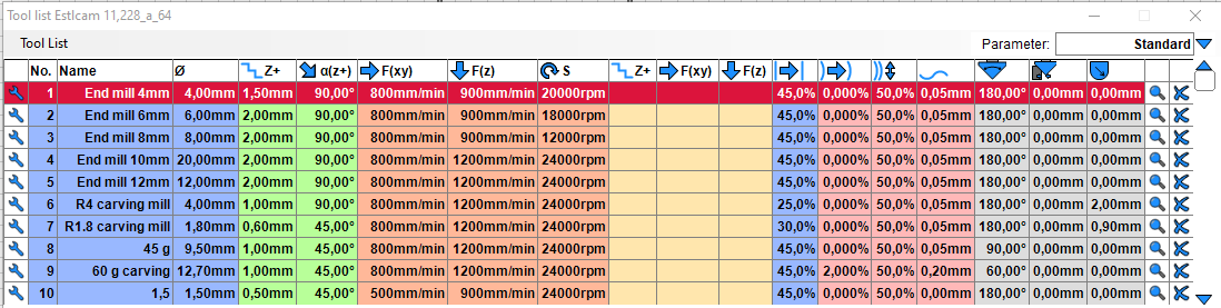

@AlexBondCat I am using 4-6-8-10 and 12 mm and ball nose bits upcutting CMT bits, no problem
@Tsander Tommy, what speeds are you using on different materials and DOC ? I’ve succesfully cut MDF at 3,6mm DOC and 8mm/s speed…2mm plunge…at 22.000rpm on the KATSU (Makita replica) router.
By the sound of the router sometimes it’s like it screams a bit, majorly when changing direction, should I slow down RPM’s ??? Or is it ok?
Cheers,
Hi Alex
@AlexBondCat I use Estlcam and her is my toolslist, hope it makes sens
Cheers
I haven’t had the time to really look at your sheet…will do it tonight, and thanks for it Tommy.

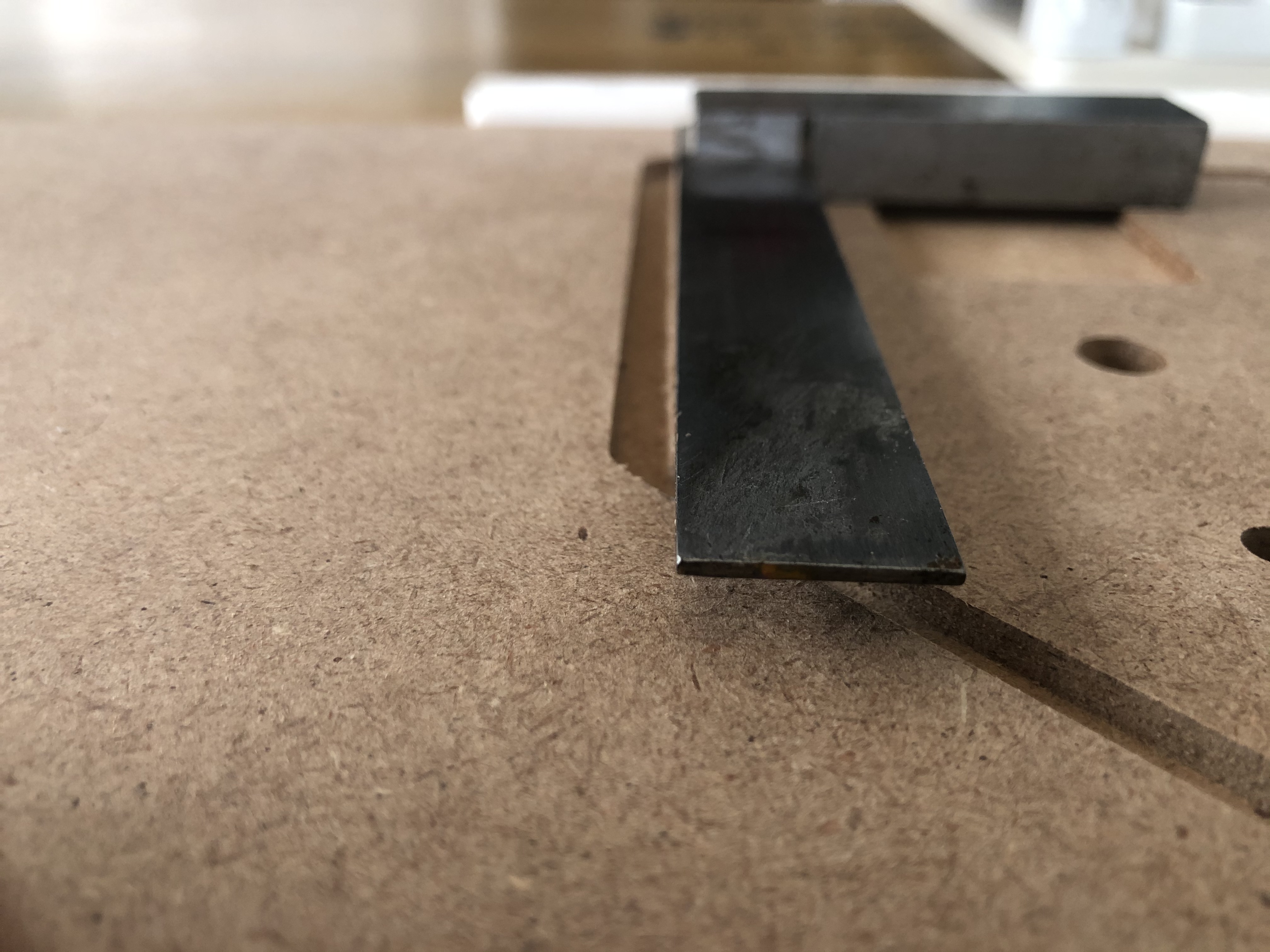

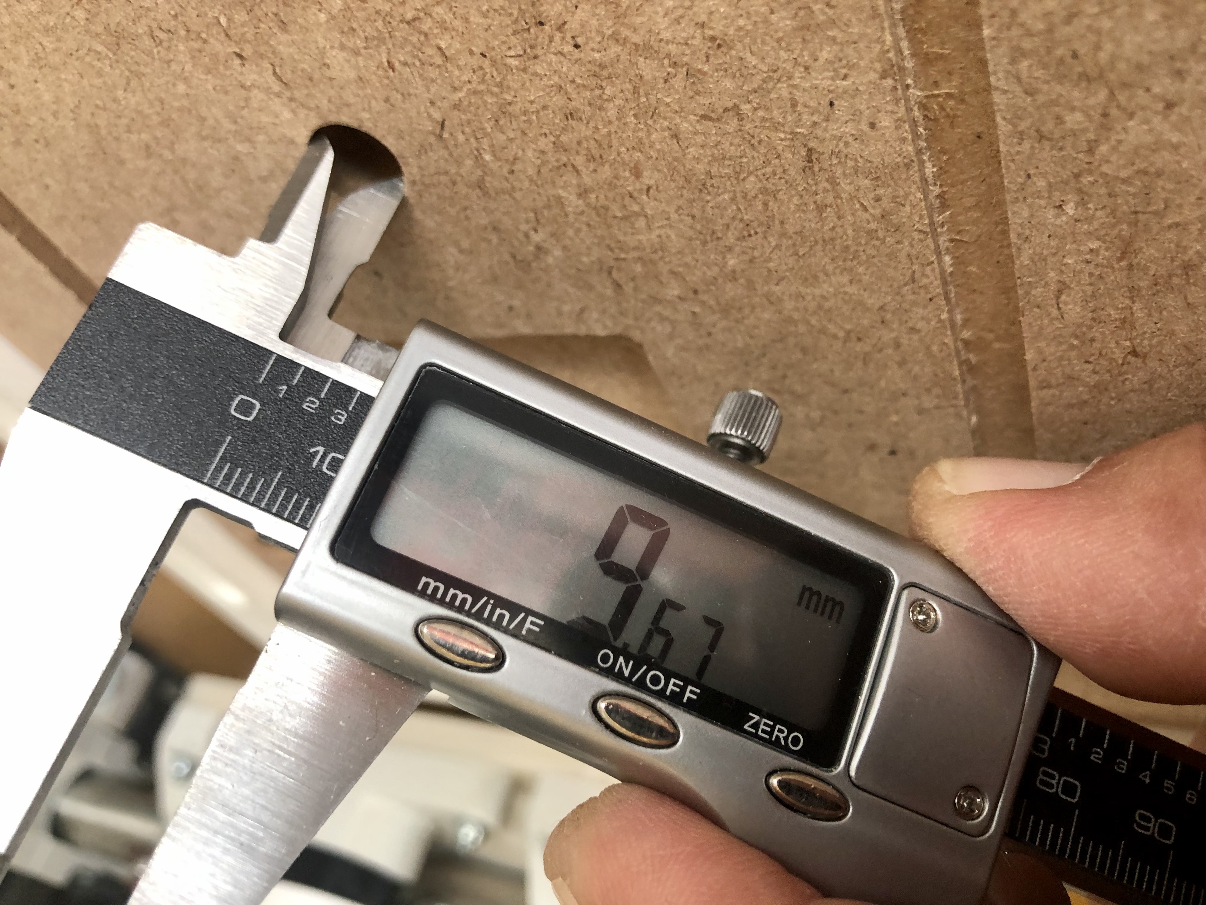

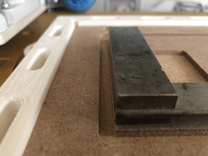

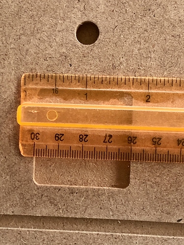

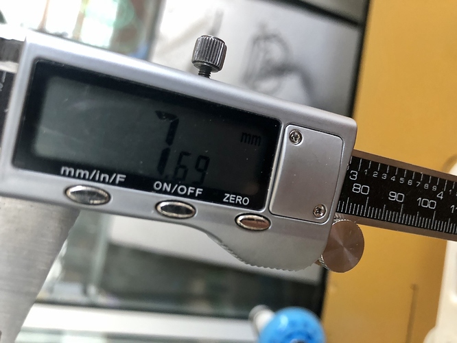

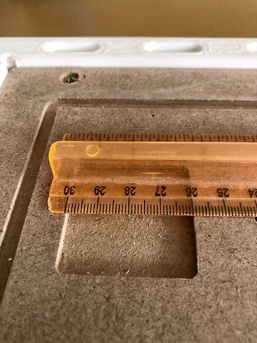

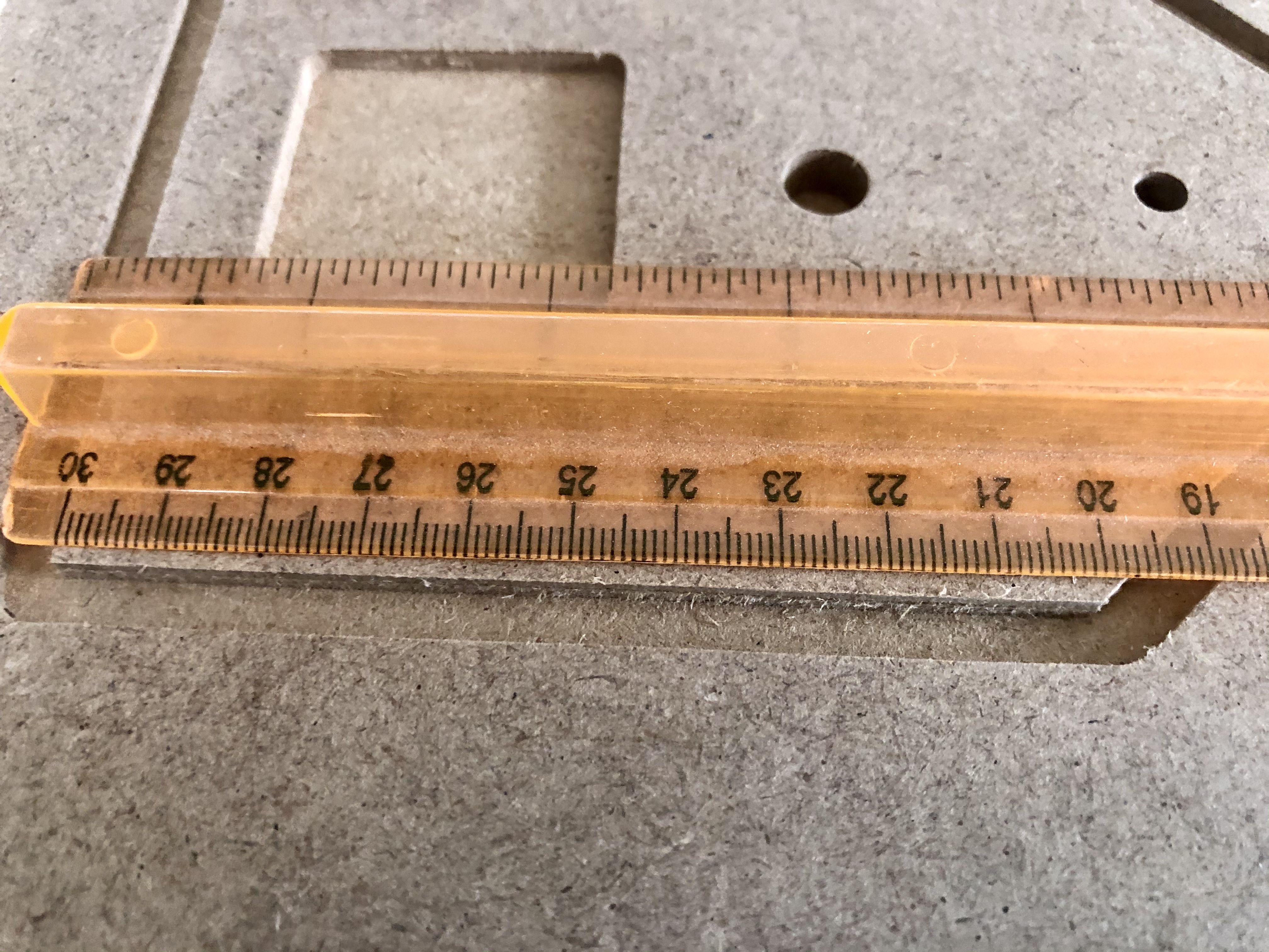

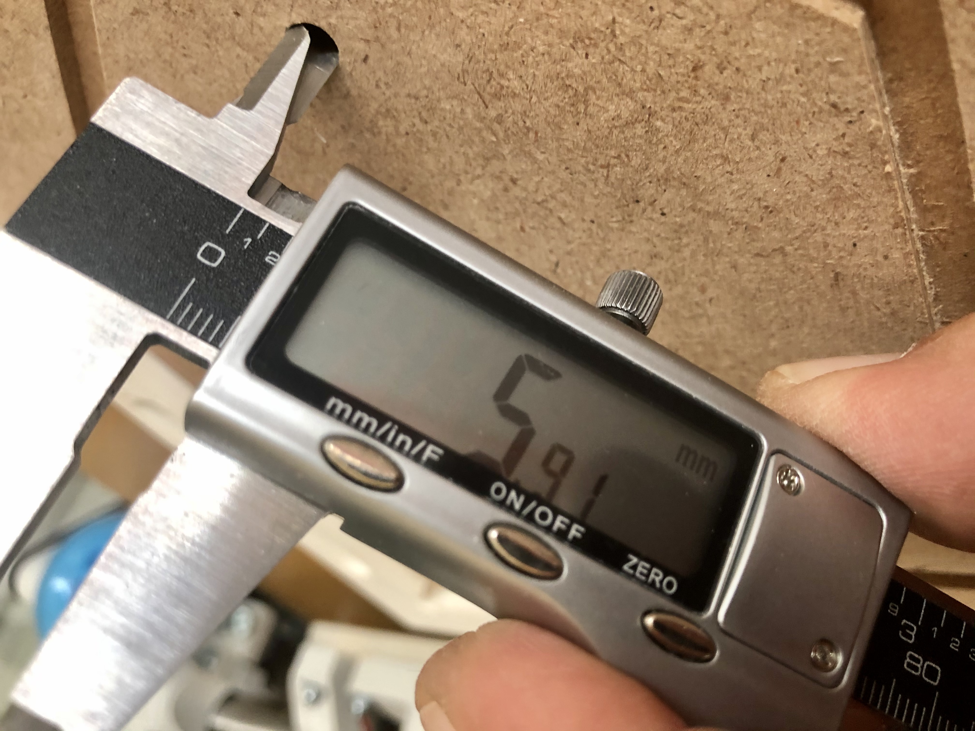

Followed your sheet parameters for the 6mm CMT single flute bit that I have and went for the squareness test I prepared…results are amazing, thanks @vicious1 for this nice engineering.
Here are the results…
