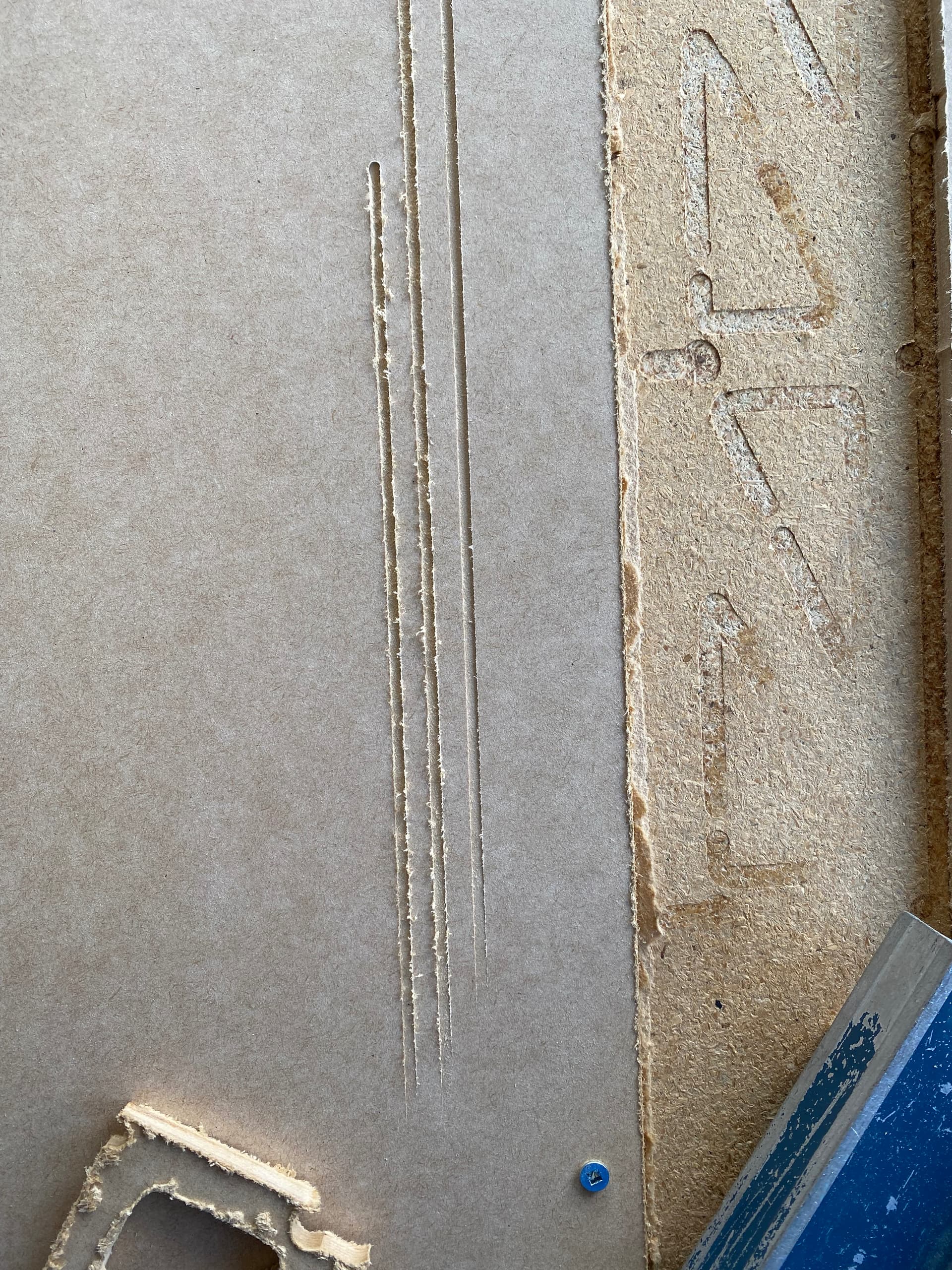

Hi all,
I semi-recently partially assembled a LowRider V3 with an SKR Pro 1.2 using a kit from the shop. I’ve had a chance to revisit this build and have been performing some calibration tests on the mounted unit. For reference, my LR3 is mounted to a 4x8’ frame.
I’ve run into an issue with my LR3, though, when I attempt to cut things along the Y-axis. I’m noticing significant Z-height drop as the gantry moves down the Y-axis. As an example, if I zero my bit above a piece, drop the bit 1mm into the piece, and drive 600mm down the Y-axis, the bit will “exit” the material around the 500-550mm mark. How this physically looks is pictured below:

A 1mm difference in table height is not uncommon at all. Some tables will have 2-3mm of variation, depending on the materials and construction method.
This isn’t a huge issue if you are doing through cuts - just set the job to cut a few mm deeper than the material thickness (it will cut into the spoil board in places, but that is what it is there for.
Before surfacing the spoil board, consider surfacing or otherwise leveling the table surface under the spoil board. Some people have used shims under the table surface to try to decrease the low spots.
You could z-probe in several places over your table to put some numbers on it (write down the trigger heights). I found my tabletop was out by 3 mm. So rather than take it off the spoil board, I actually planed the tabletop, then I surface my spoil board, but I only need 1 pass with minimal material removal.

I z-probed the table and noted a slight slant that culminates in a 2.5mm discrepancy at the x/y extremities.
Glad to hear this is something a bit more common than I first thought. I’m going to take both of your advice and plane my table and surface the spoil board for a correction.
The Z discrepancy between XMin and XMax can be corrected roughly by adjusting the Z limit switches, and more finely using the M666 command.
Do this before surfacing the table
Thanks for the tip! I’ll definitely get this correction in and re-check before surfacing.
