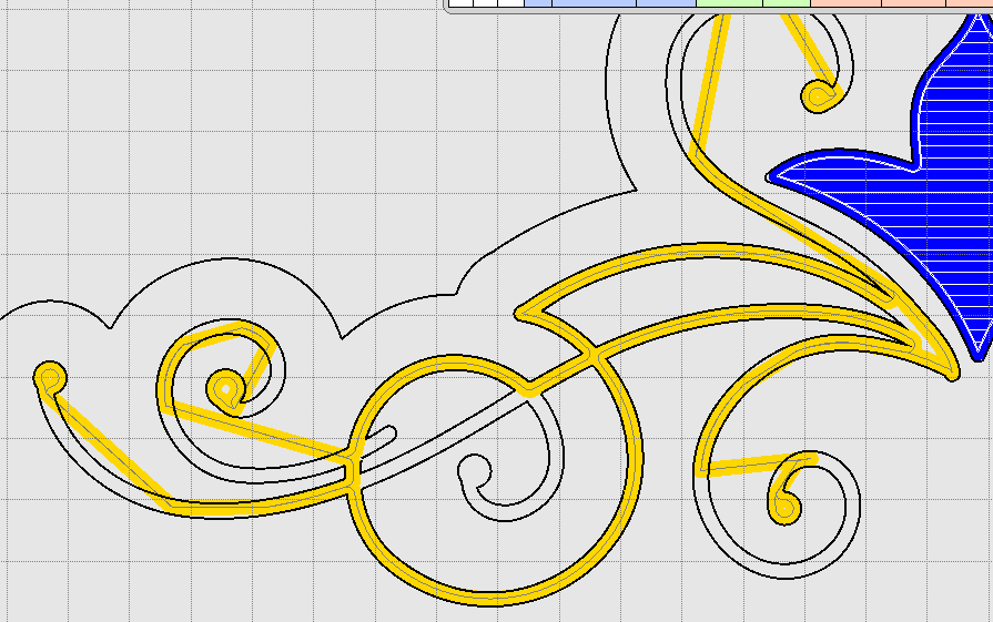

Um......tool not following paths
Has anyone ever had a tool path “shortcut” to another section like this? I think I’ll switch this to a central line and engrave instead of cutting as a “hole”. This art was optimized for the 1/4" endmill but I wonder if at certain radius it won’t work so the tool just goes to the next spot where it’ll truly fit.
Try a smaller tool diameter to see if that fixes it
Might try using the finishing pass without a tool definition to slightly increase the cut, which might allow the tool to follow the pattern. I can’t remember if you need to make it negative or positive - but one makes the toolpath slightly wider. (like 0.2 mm)
Smaller tool did/does fix it yes so it must be a matter of the larger tool just not fitting on some of the curves. I’ll try making the artwork a path to engrave instead of a hole. I’ve just never seen the tool path just jump right across the non work area like that. Usually if a hole can’t be completely cut it just cuts what it can and then leaves the rest uncut.
I think the geometry problem of trying to know if the bit fits, along with knowing how to skip along an arbitrary shape to the next part where it does fit is a difficult one. Estlcam probably doesn’t work in this corner case. At least it actually did make the result obvious. I’m sure there are more subtle times when the user doesn’t notice it.

With straight tool Holes the primary tool always needs to fit between all the drawing lines. If there is any question (not in this case) zoom in to the tight spots to make sure the path is 100% inside the lines.
I don’t understand how engraving lines can reproduce that drawing or how that is somehow easier than using a smaller tool or using the Resize tool to scale the drawing up a tad (100+%). Carving that drawing with a V-bit is another option.
That is exactly what Estlcam does when you add a Pre-pocketing secondary tool path, the pre-pocketing tool will cut whatever it can and leave the rest for the primary tool to cut.
While Kelly’s drawing isn’t a great example, if you zoom in you will see that the second curlicue knob? needs pre-pocketing. If Estlcam is consistent (haven’t tried it) the pre-pocketing tool can be the same as the primary tool (no tool change required).
When I set up the original artwork I found a stroke width (in Illustrator) that ‘fit’ the 1/4" endmill. Once the drawing was complete I converted the stroke to an outlined shape and merged intersecting shapes into one. My guesstimation of the stroke width that would work with a 1/4" endmill was a pretty good plan except when curves get added to the equation. I guess the open shape pinched in too much such that the 1/4" mill wouldn’t fit anymore. By using the original path instead I can choose any bit to run along that path as the path is determined by the centre point of the cutter, not the space the cutter must fit into. Technically I could load any bit shape or size I wanted to and the same gcode file would run no problem.
The other question still remains though - why did the path just jump straight through the non cut material to the next place the cutter ‘fit’?
My bad, I assumed the line spacing was variable width.
