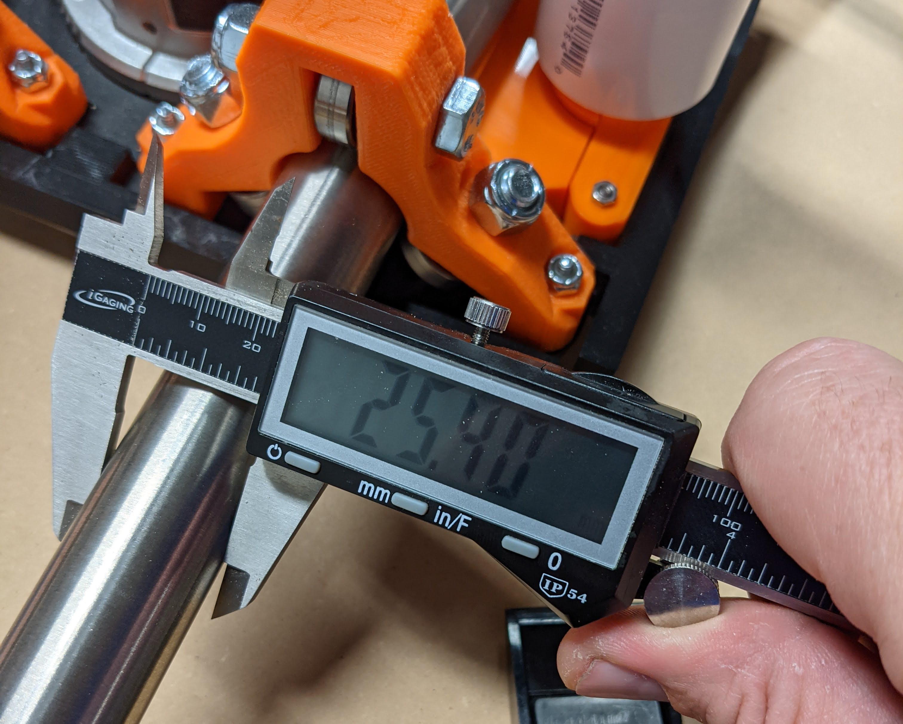

My LR2 is almost complete and I’ve noticed that one end of the gantry is twisting as it raises off the blocks. I re-read the instructions and it stresses not to overtighten the screws in the printed XZ part. I loosened every screw on both sides of the gantry to the point where the z-tubes were slipping out and it did not seem to affect the twist. My current suspect is the y-plate, so I plan to take the bearing assemblies off of the plate to make sure the mounting holes are level vertically. It looks good visually, but that’s all I can think of that would introduce torque along the x-axis. Has anyone seen this or have other ideas?

Are you using 1" tubes and then 25.4mm prints?
Yes. I edited my last reply as you were typing. My tubes measure 25.4 and those are the files I printed.

Saddles are in there. Harbor Freight thinks my tubes are 25.4 and the interior of the printed piece is 25.5. Is that close to what yours measures?
Yup, those measurements seem to be the same and this little stand off that the fastener goes through is 13.84mm

Thanks for the idea. Scaling makes sense, but I just loaded XZ_Main.stl into Cura and it said it was 151.4mm wide. I measured the part with my calipers and it was 152mm. That seems to be within the tolerance of my cheap Harbor Freight calipers.
