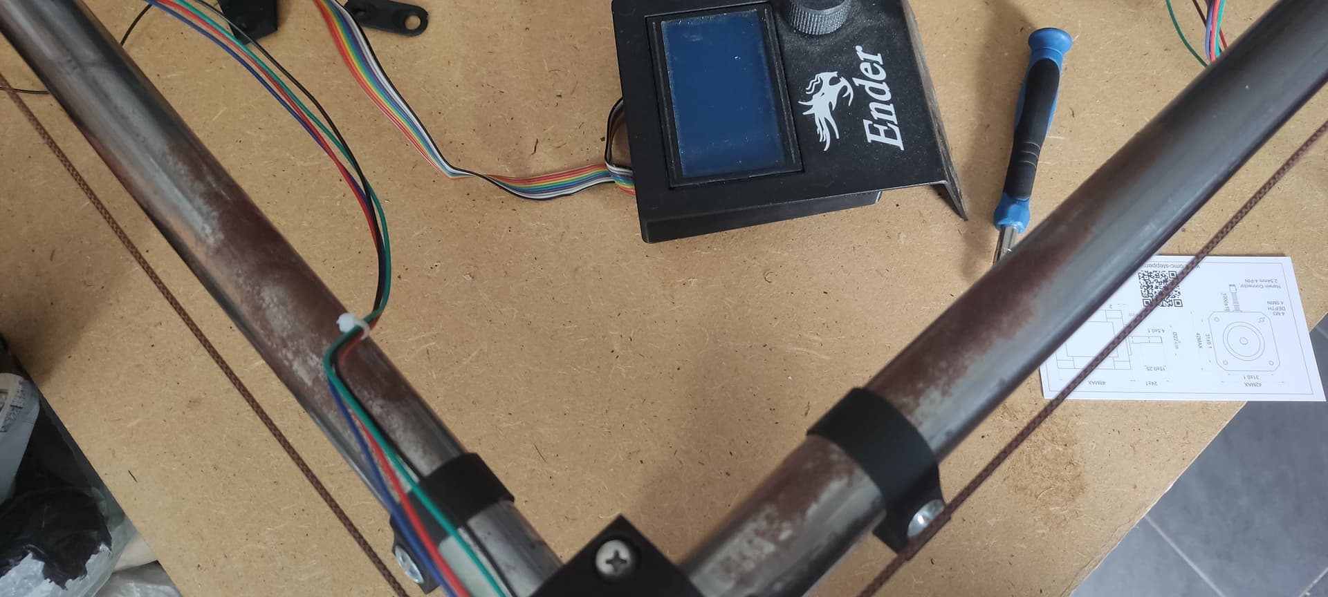

Hey, guys. I have been getting my MPCNC up and running in the last couple of weeks and I have been noticing some oxidation of the tubing over time. It’s a very thin “coat” of rust.
I was wondering what the proper way was to protect the tubing over time.

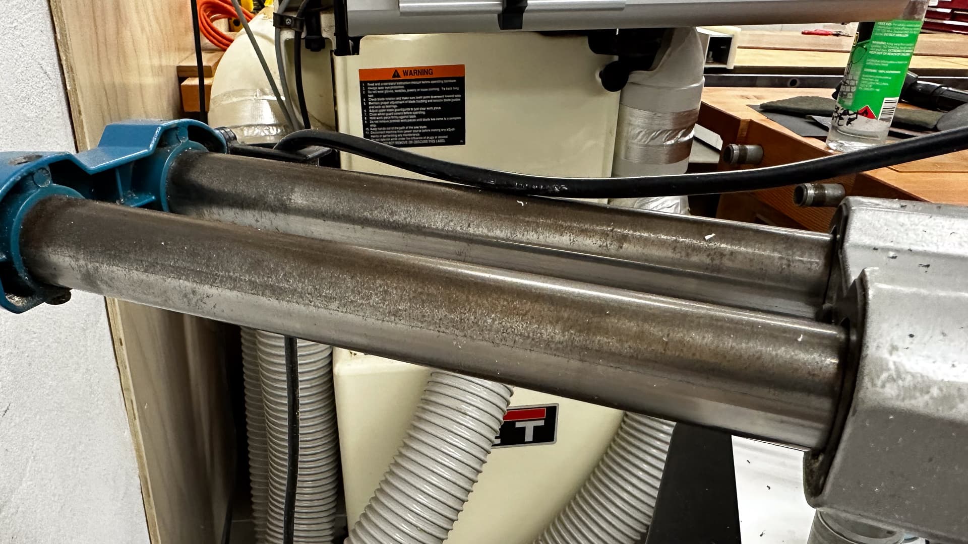

I’m not sure how clear this pic is, but only the top surface is at risk. Waste of bacon aside, I don’t think there’s a problem internally.
Whether that’s because for some reason the salt settles out of the air, or the layer of dust holds the moisture I cannot say, but this is my sliding compound mitre saw - you can sort of make out the gloss from the waxed surface and that there’s no rust on the underside. This gets very regular wax treatment, lubed with ptfe spray and is covered when not in use. The rust pitting is not as bad as it looks, more of a discolouration on a ten year old machine.

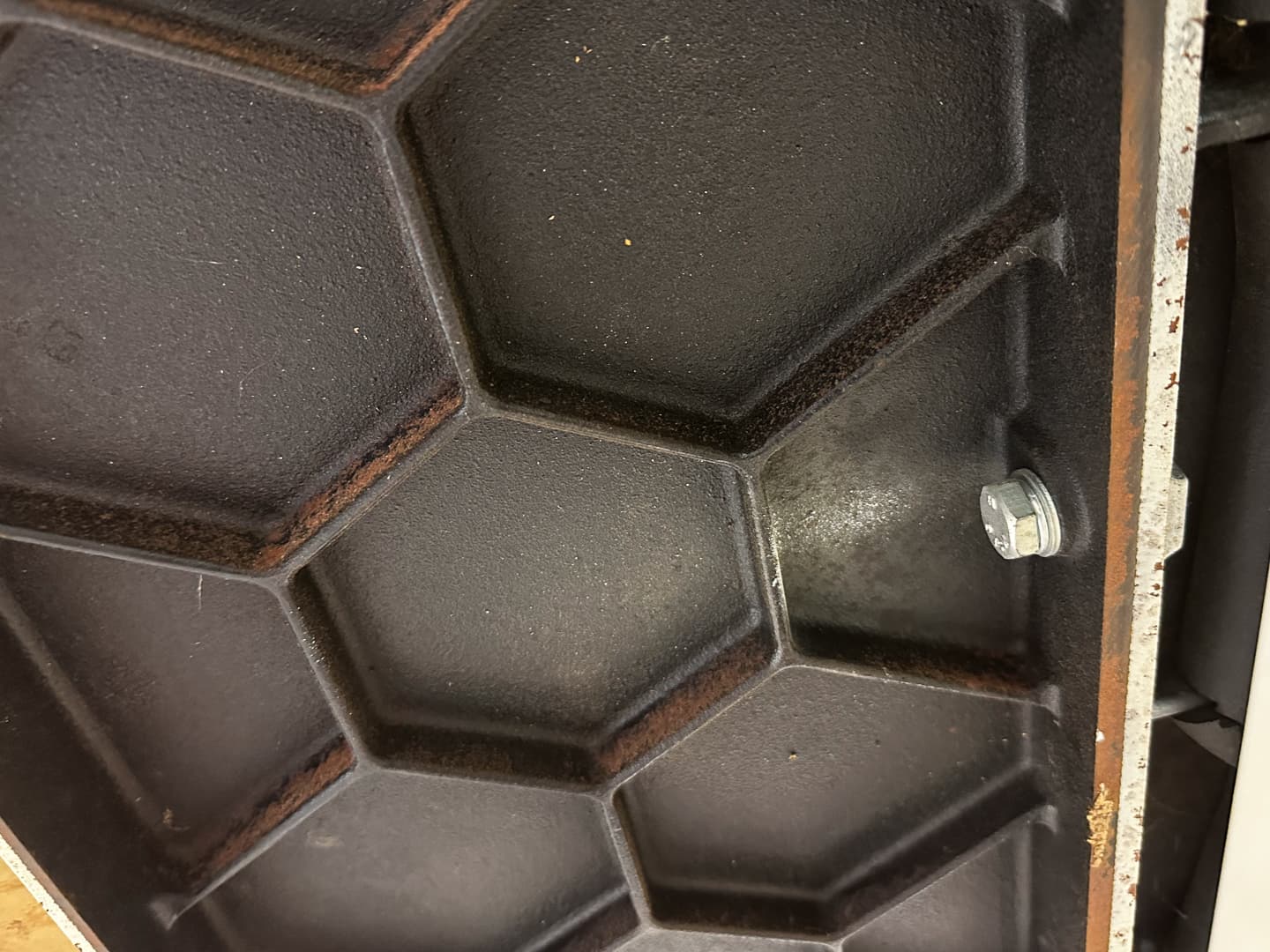

Now you’ve got me crawling under things to find out. It’s not top specific, but very exaggerated. Under my tablesaw wing for instance - twenty-five years or so and painted looks like this. The top has a ply sheet on it when not in use and is waxed yet after six months or so you can rub your hand over the cast iron and it will be covered in red dust (rust) - at that point I clean it all off with mineral spirits using scotchbrite and rewax.

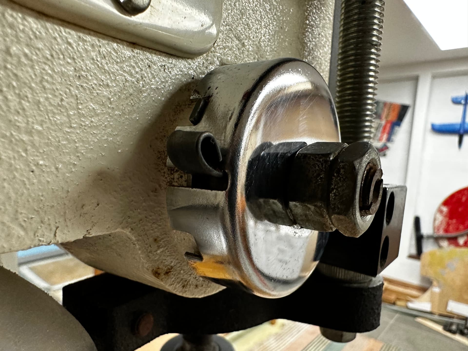

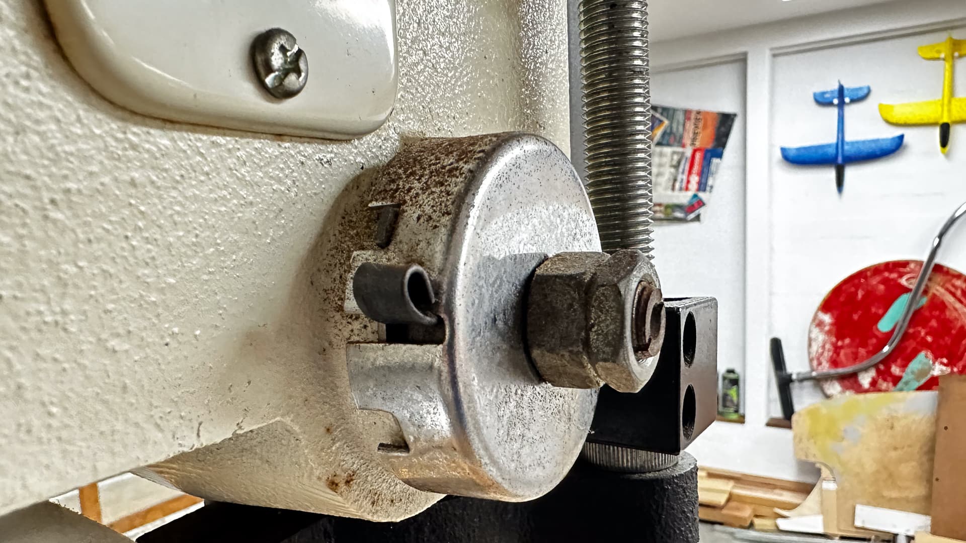

More telling are the little details like this chromed spring retainer on my drill press - I probably haven’t given it a polish in ten years, so it’s overdue for some preventative. Will give it a dose of the aluminium foil and report back in a few minutes. Note all surfaces are slightly affected, but the top one is a lot worse.
EDIT 8 MINUTES LATER.
I’ve had a chance to tear off a corner of my foil hat, go downstairs, give this part a quick rub. I don’t know what the science is or if it really is voodoo magic, but this is it - foil only and a smear of wax (hence the “scratch marks” which are actually just wax. If you view both images at full size you’ll see that the foil has somehow penetrated into the rust pores, or at least pulled it out from the hollows (it’s still there, waiting to come back! :wink: )
