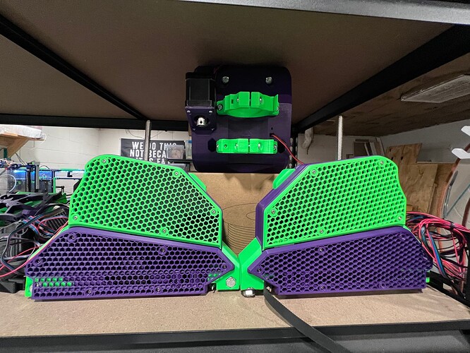

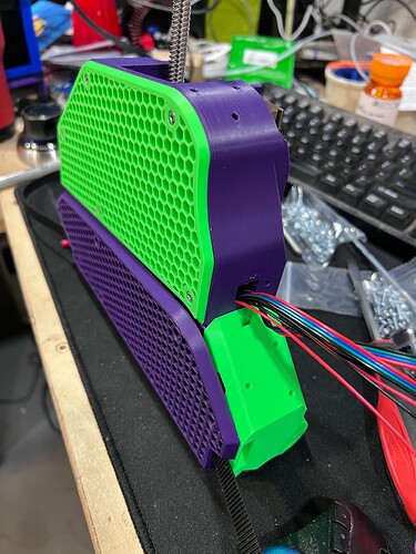

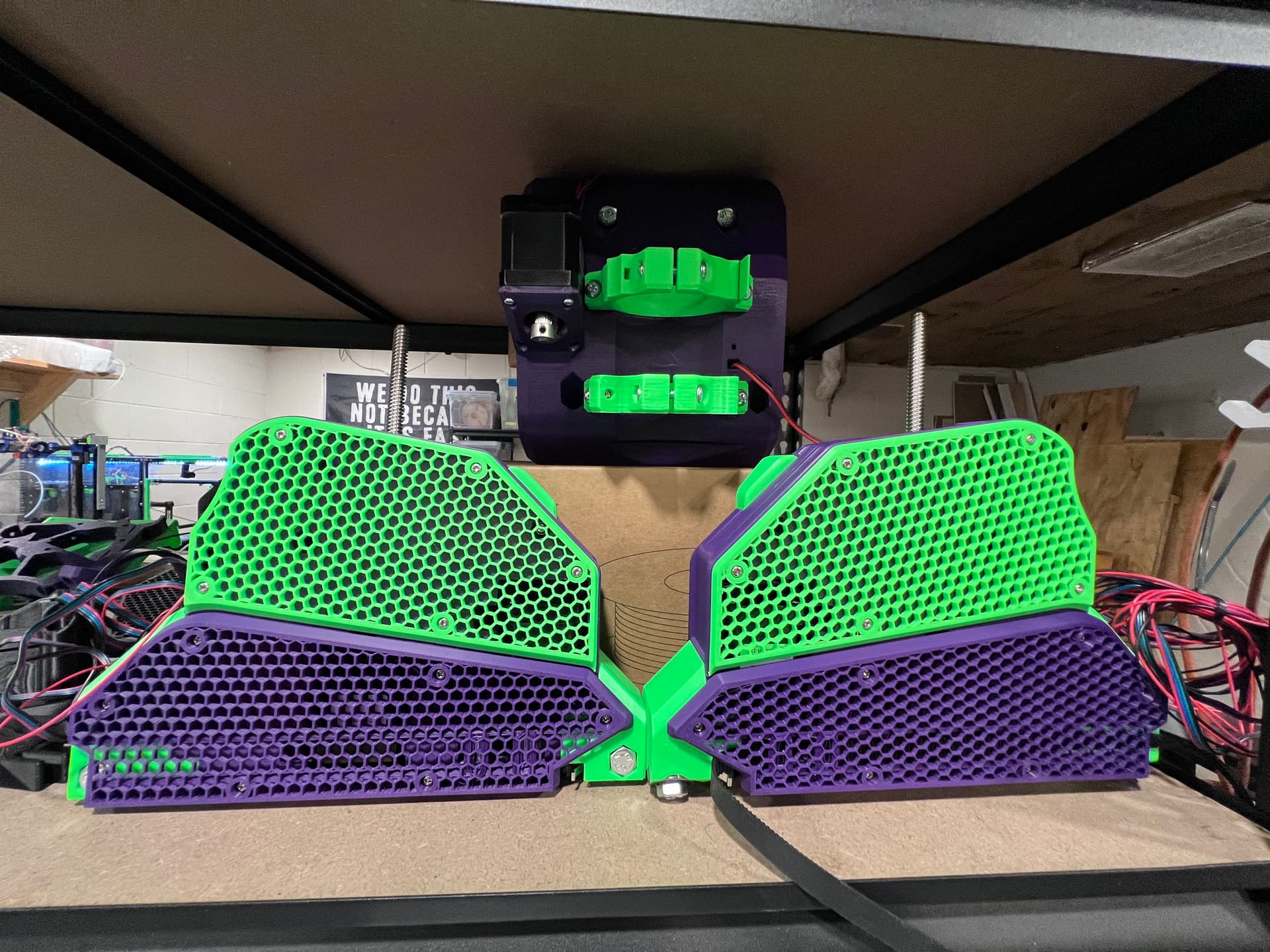

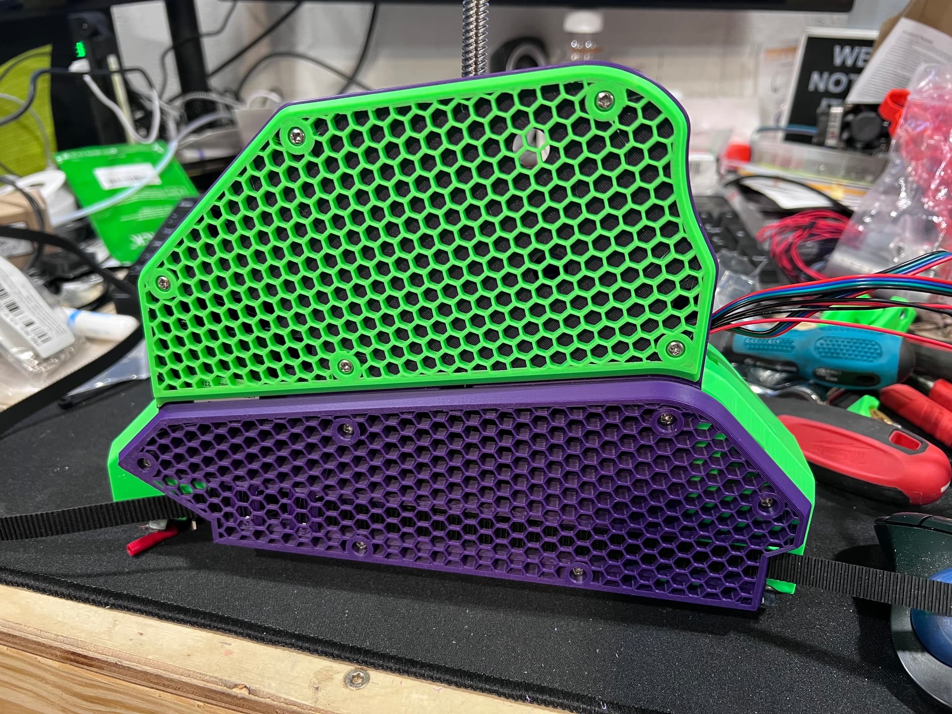

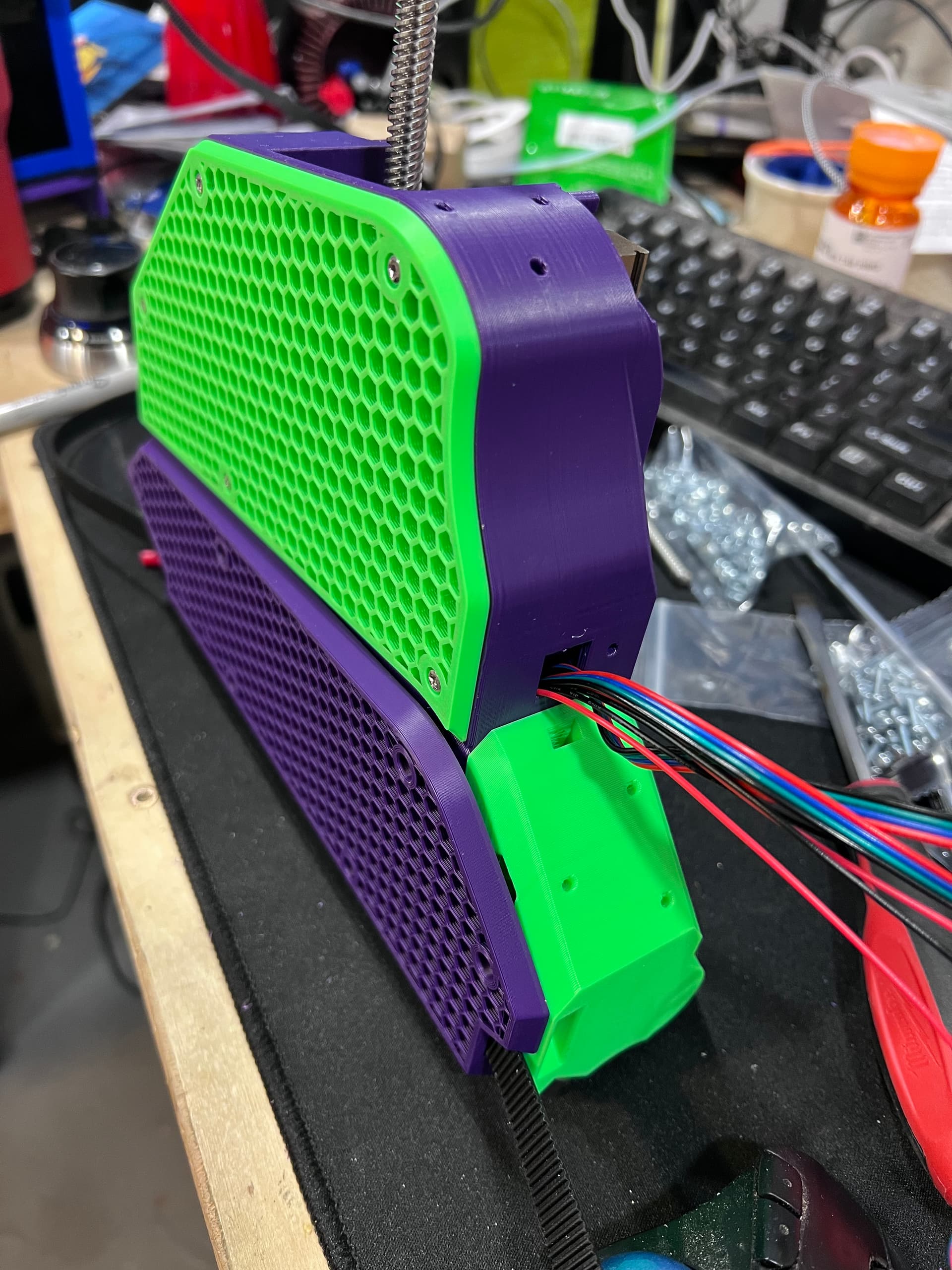

Trying out a different Color Scheme

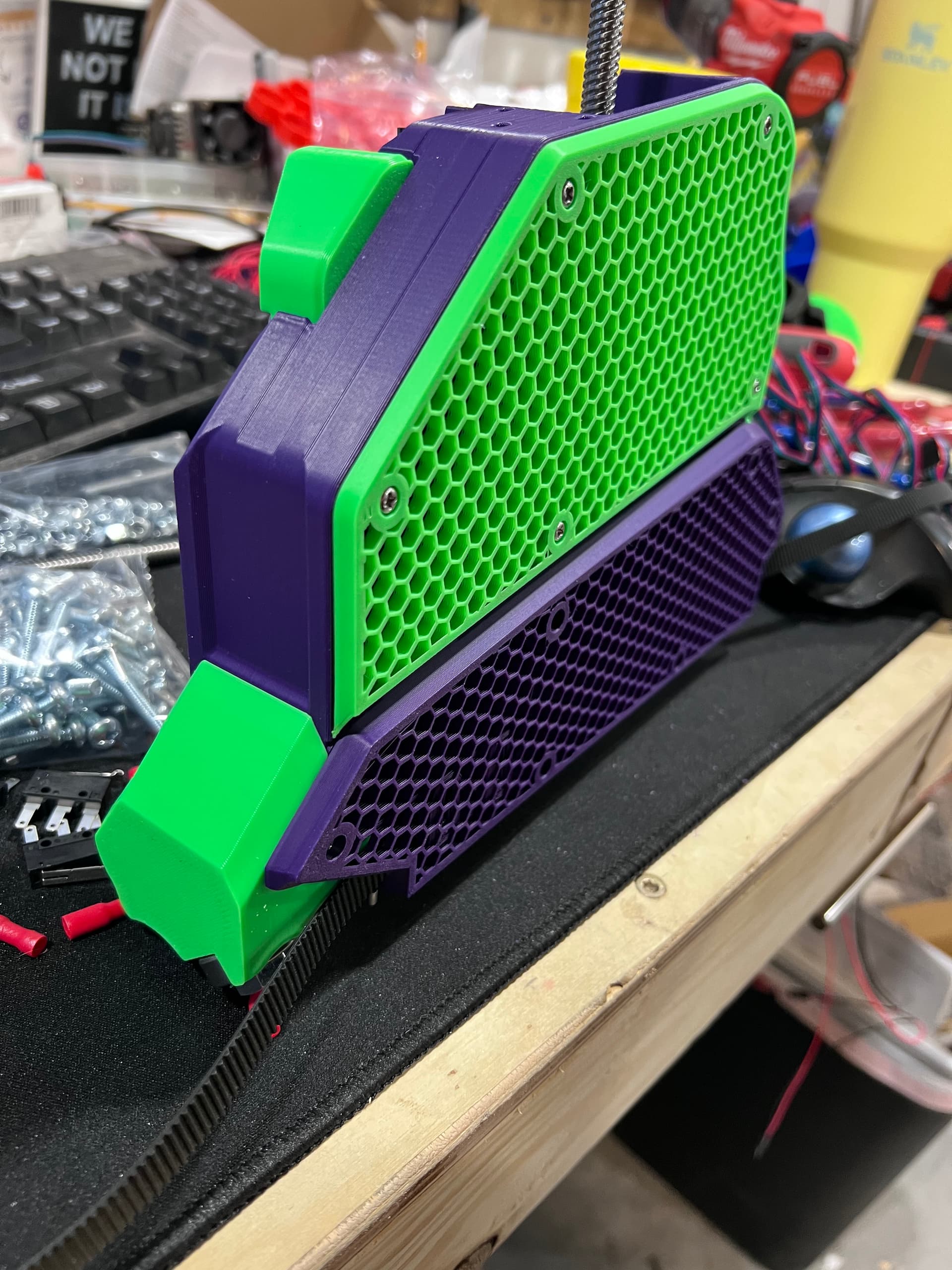

Decided to build a machine to have in stock. Figured I may as well have some fun with it while I am at it. Color Choices were Bambu Indigo Purple and Elegoo Neon Green. I think it looks pretty good. Hopefully later I will have some pics with the beam to post.

i was looking for that fender cover where can i find them
yes i found peters plates but iwas looking for the honeycomb ones and didnt find them anyware
Ah ok, I follow you now. When you load the peter plates into your slicer, choose 0 top and 0 bottom layers. And choose honeycomb infill. These were printed with a .4mm nozzle, 4 walls and 12.5% infill.

Ok need some opinions on this. I was about to put the beam together and realized its going to look like :poop: with plain wood struts. I don’t want to cut aluminum or acrylic (raises the cost way too much without it being an ordered unit) so I am thinking paint the struts before install.
Which color should I paint them. For 2 or 3 I will take a printed part to the hardware store and have the paint matched and just get a sample can, that’s more than enough to paint 2 struts.
1 - Black
2 - Purple
3 - Green
Yellow
MARDI GRAS!!!
purple, core is already black, and the router mount is already green.
Core is the same purple as the YZ plates
oh, it looks black in the picture. then I’d go with black.
