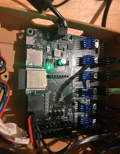

I have three boards with a BC port issue here, one I just fixed it had a poorly soldered mulitplexer, the other two look good under the microscope.
Just make sure the heatsinks are not touching the big silver capacitors, can’t tell from that picture.
silly question. How do I do this
they are not touching.

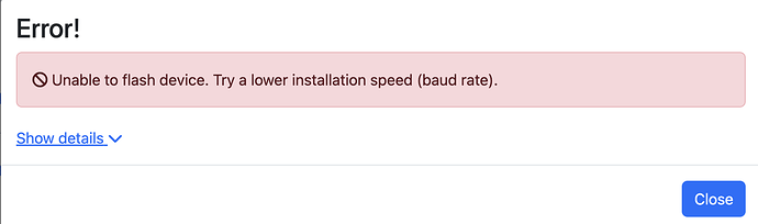

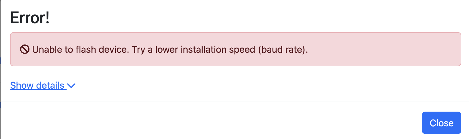

The webinstaller does the same thing, https://installer.fluidnc.com/. Connect, upgrade fluidnc, full wipe, use 3.9.9, then upload all the files from the zip.
Make sure your USB cable is a data cable and not just a charge cable.
Also click the little blue drop down to show details, you might need to hit the boot button for three seconds.

Have you installed the drivers from here?
Im going to try reply to all the messages systematically.
ive managed to do this part. Now I’m struggling on the webui to upload files. The previous webui was drag and drop. The upload button is non responsive.

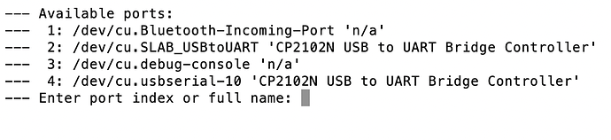

You need this USB driver to connect to the Jackpot.
You then want to connect to Port 2: -
-- 2: /dev/cu.SLAB_USBtoUART ‘CP2102N USB to UART Bridge Controller’
