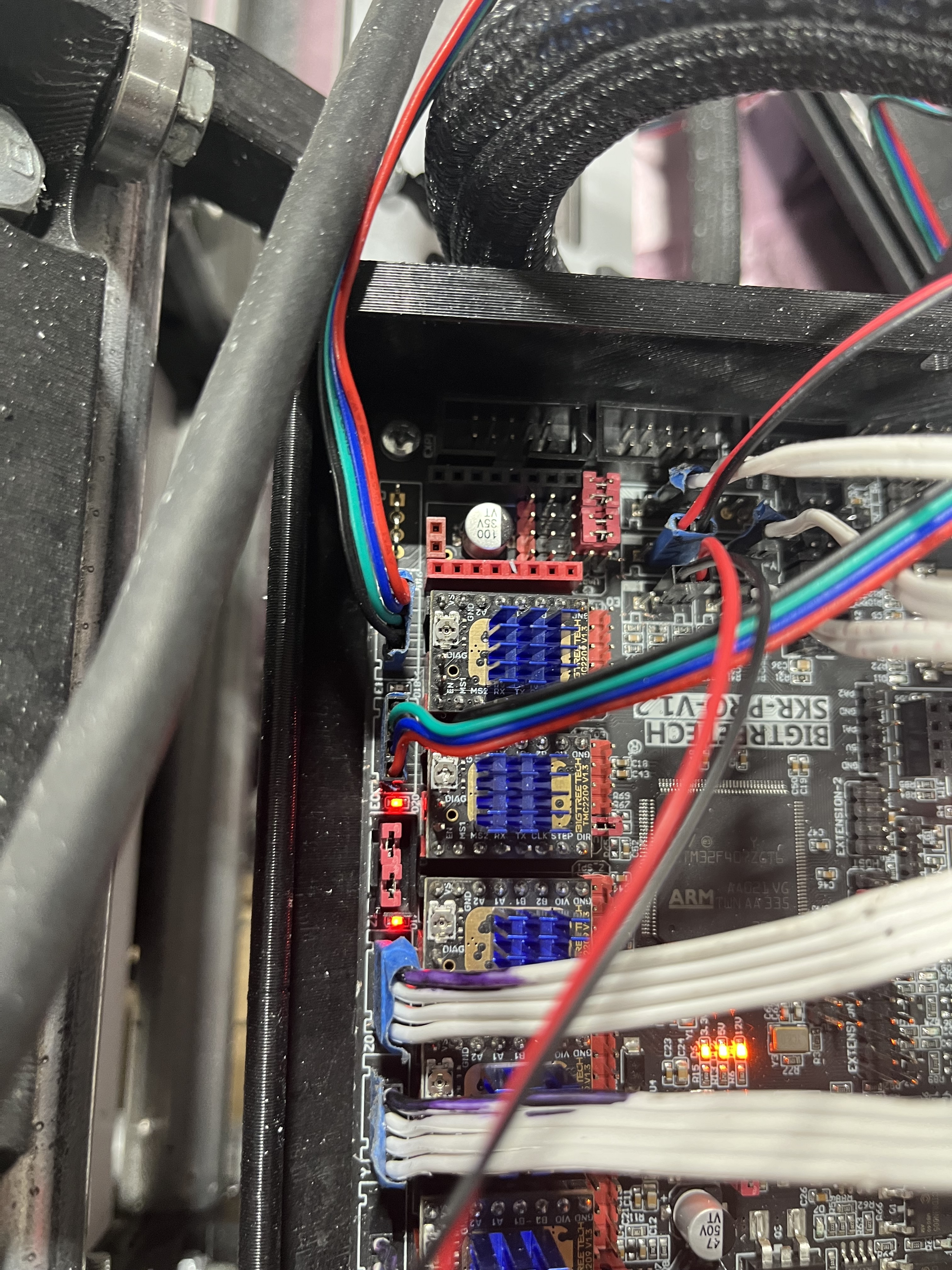

Long story. Have and been using Lr3 Skr board. Estlcam and Repetier Host. Was cutting a job last week, no problems came in next day to finish, and problem started. Would start cut with no arc movement, remembered arc comands.fixed… Restarted cut job cut no problem but end of cut Z did not raise to clearance go home, cut across project.Reset poweron LR3 but would not home Z. Switched Zsteppers and endstops With Y steppers and endstops Zwould home with y home button, Y would not home with Z home button. Thought maybe SKR Board problem, Ordered new SKR Board, Hardware Kit,end stop plugs,stepper extender wires. Installed Board but noticed Z0/Z1 illuminated,Z1 jumper in place illuminated,E0/Y2 weak Illumination when endstop triggered. Installed new endstops and plugs still same.Still no Z home. Any Advice?
REINSTALLED original SKR board with new steppers , endstops and endstop plugs, All endstop leds off until triggered(Z1-jumper in place stays on )? Z2 no movement with home or manual jog.

Have many things going at once and not fast typer. does this look right?
Have you installed the V1E firmware onto the replacement board yet?
And is the M122 output shown from the original board, or the replacement board?
Have not installed anything on new Skr board. Bought V1 shop, I thought it was all ready when purchased or am I wrong?
The M122 diagnosis is from the original SKR board and I see at the top X , X2,Y,Y2,Z.
Is this a problem and can I change it?
Did a M122 on new SKR board and top row shows X,Y,Y2,Z,Z2
If you bought it from Ryan, and if you told him which machine it was for (LR3 vs MPCNC), then it should have the right firmware, but you could check on the screen at startup to be sure.
Yes, this seems wrong for the LR3. You can change it by re-flashing the board. Download the SKR Pro DualLR version of Marlin from the GitHub page linked on the documentation page (you will have to click on the “show all 37 assets” button near the bottom of the asset list to show the DualLR version). Put it on a 32GB or smaller SD card, insert it into the SKR SD slot when the board os powered down, then apply power to the board. The filename should change from .BIN to .CUR

progress update. got my jackpot board running, finished my cutting jobs so I can confirm wiring endstops and steppers work correctly. Back to original problem, have reflashed both the original SKR Pro board I have been using and the new SKR Pro board I purchased from the V1E shop. Both boards have Z1 and E0 leds illuminated.no endstops are triggered. Z1 and Z2 stepers will jog up or down but only Z1 will move with home button. (Also noticed dim illumination on E1 when endstop triggered. only on the new board.) New board pictured. Any suggestions where to start looking?
One last thing , How to add Ryan and or V1E Shop?
The z1 endstop is showing as triggered, thats why it doesn’t move when homing, you have a bad connection somewhere. Obvious culprits are the crimping of the pins and spade connectors, otherwise the wire itself or the endstop,
These are the forums Ryan reads. If you want to tag him, reference @vicious1
Diags. Always start with the diags.
What do you get when you send M119 from the terminal when you aren’t triggering anything?
After that, manually trigger each endstop and repeat M119. This will tell you what the controller thinks is happening with the system, and from there we can advise what to do.
This likely indicates an open circuit on Z1 end stop circuit. As Z1 is typically wired to the farthest away end stop (XMax side), and that side typically requires an extension cable, I would start by checking the connections at the extension cable, as well as making sure that the switch is wired Normally Closed (NC) to COM (outer connectors are wired, middle connector is not wired). Does the Z1 LED change status when you trigger the Z1 switch?
I have been moving all endstop plugs around on the board, X to Z1. Z1 to Y2. Y2 to Z2, many combinations with power off, led illumination stays the same when power back on. manually triggered switches illuminated correct leds. Endstop and plug problem is eliminated I believe it is a board/firmware problem but not sure what to do now.
