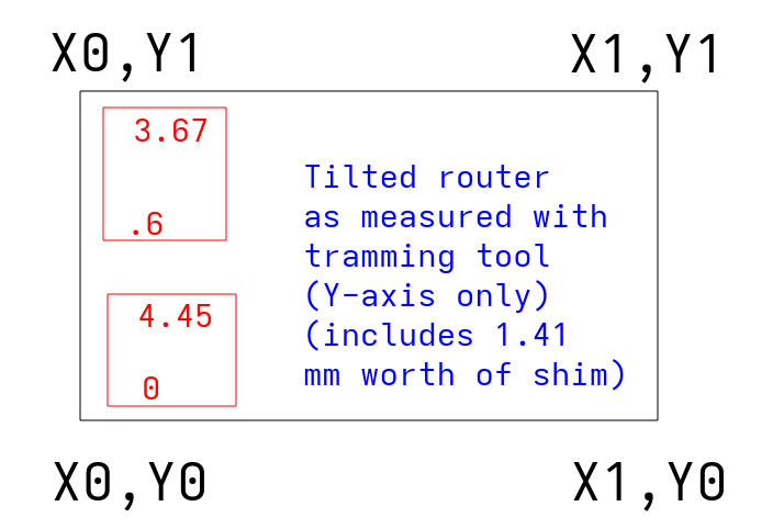

I’ve been chasing down a problem trying to get my Primo trammed. Every time I measure the distance with a tramming measure tool and feeler gauges, the measurements look like the router is tilted towards me on the X-axis side. When I shim the router, either by putting aluminum shims in the top or bottom ring of the router mount, the tilting gets worse:

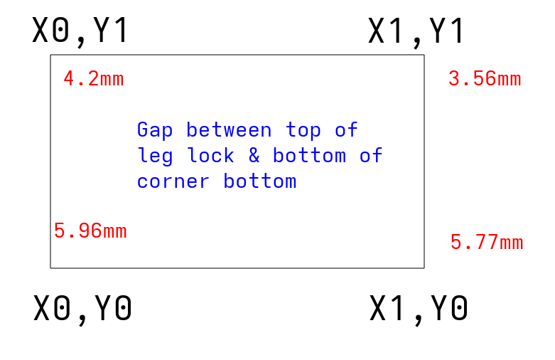

I redid the entire core, trucks, tension, squaring, etc., until I found what I think is my issue - the Z-axis leg conduits are different heights. I went in with the feeler gauges and found these height differences from the top of the leg lock to the bottom for the corner bottom:
I took off the spoilboard (12.1mm MDF), cleaned the hell out of it, noticed a tiny magnet stuck under it, reinstalled the spoilboard, and the issues above persisted.
At this point, should I be trying to get the corners and edges of the spoilboard to level off enough to compensate for the different heights of the Z legs? Given the 2nd illustration above, I’m guessing I need 1.46mm worth of shim at X0,Y1, .19mm worth at X1,Y0, 2.4mm worth at X1, Y1, and enough at the 0.5 marks between each of them to ensure it doesn’t have any bowing.

Edit: I’d ignore the distance from the foot to corner. Measure from the spoilboard to the bottom of the core with the z-height set to a consistent value. Take out your router, and zero your z-axis is probably the best solution… That’s the important distance anyway
On my mpcnc I loosened the corner clamps and when I rotated the conduit I could see the router rise and fall.

Maybe a dumb question but how much tape (or tin can shim material) do I need to tilt the router towards the lower X axis and where should it be on the router? I’ve tried it a few times with a few different thicknesses and locations on the mounts, but it never seems to do anything other than tilt the router further away from the lower X and towards the rear X.
Think of it this way, you can only shim away from the core.
Shimming the bottom opens up the front angle, shimming the top opens up the back angle. You can move either left and right a lot.
Place one little shim and it will make sense.

The way people talk about tramming a router sounds like it only needs a few shims. I think I’ve put in 15-20 shims, maybe around 1.4-1.8ish mm worth. This degree of tilt looks like something is WAY off kilter and I honestly don’t know what to do to fix it.
Should I just keep on trying more and more shims in the router mounts? If that isn’t the answer, I really hate to sound needy here, but can I please get some exact steps on what to do and where I’d do it on an MPCNC? Assume I know nothing about CNCs if it isn’t on the MPCNC docs or on a post I made on this forum.

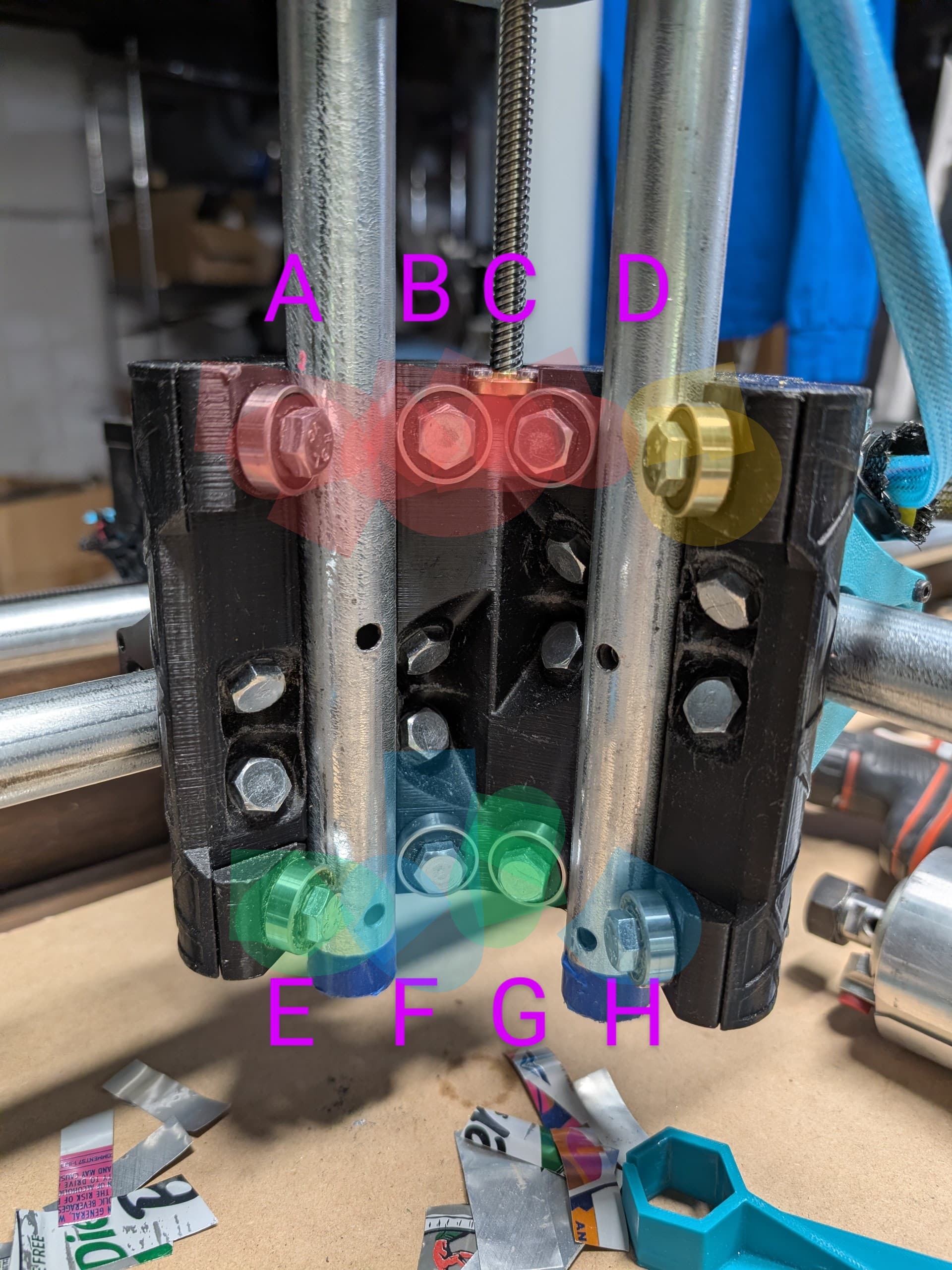

@Tokoloshe / @vicious1 - here’s what my current bearings feel like. All percentages are relative to my perception of how much force it takes to turn the bearing.
Red = LOTS of torque required to turn the bearing. In firm, complete contact with the Z axis conduit.
Yellow = 60-75% torque required to turn the bearing relative to red. In solid contact. Not as hard to turn as the red ones
Green = 30-40% the force required to turn the red ones.
Blue = Easily flicked to move. Not free-spinning, but just baaarely in contact.
IIRC these are all based on getting the nuts and bolts just in contact with the plastic enough so that the nuts/bolts don’t spin when turned with a finger.
Should I be going for equal tension on all 8 bolts or should some of them be tighter than others? I’m guessing the ones in red should not be that tight, but should they be down to yellow, green, blue tightness?
Edit: I loosened all the bolts to equal tension, enough that I could spin the bolts with a thumb and the bearings were just barely in contact. The tilt is still there.

They should be able to be turned by hand, but it should not be easy, so rather try to hit yellow/red.
Getting the bearings to just that right yellow tightness + 0.96 worth of shim in the 7 o’clock part of the upper router mount + 0.8 worth of shim in the 2 o’clock position of the lower router mount = trammed enough for my needs!
