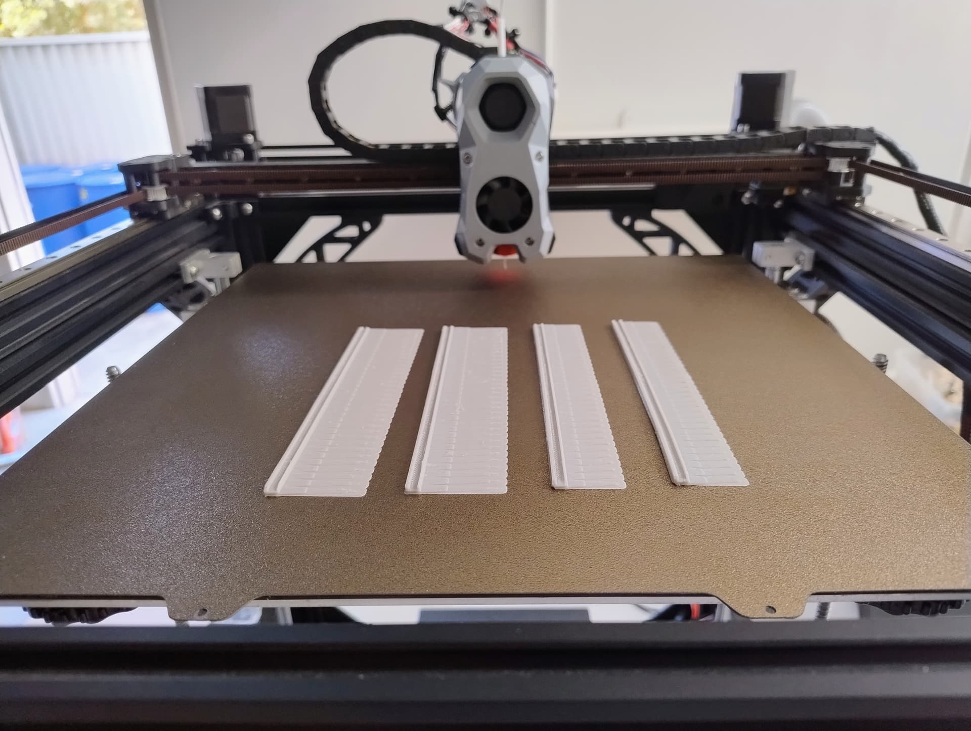

Well I have lost my TPU cherry today but can’t say it went smoothly. I am using a standard 95A TPU.
I am using a 0.60mm brass nozzle and printing with a restricted volumetric flow of 3.6m3/sec. Twice I have had a filament blockage mid print but not at the nozzle. For both prints the first layer went down well. The blockage I get is after my extruder but before the hotend where there must be enough play to allow the flexible filament to kink up.
I am thinking to try a print with no Pressure Advance and no retractions so the filament doesn’t go backwards as much. These are currently set with PA=0.04 and retractions = 0.4mm @ 30mm/sec.
Any advice or experience you guys can share? Is Pressure Advance used on TPU prints?
What printer/extruder? What speeds are you running? Pressure advance should only be needed if you’re running fast with a lot of time spent accelerating. The few TPU prints I’ve done I’ve kept movement pretty slow so I didn’t bother with PA. No idea if that helps or not.
Absent any other ideas, I’d try running slower and turn off PA. You could also try upping the print temp a little which will make it easier to feed.

I would turn the retractions off and leave pressure advance on. TPU can be pretty fickle and sounds like you are getting heat creep bad. Also loosen the grip on the filament at the extruder. with 95a you might be able to go up to around 5mm³/s. I believe that’s where I cap mine at. that will let you move it through a touch faster so its not sitting there quite as long.

The heat creep one is a good point. If you’re printing too cool then the nozzle pressure might be too high for your flow rate. Either lowering the volumetric flow rate or increasing the temperature would help with this. On the other hand if it’s a heat creep issue softening the filament between the hot end and the extruder then either of those changes will make it worse and you should either lower the temperature or print faster (or improve hot end cooling). Tricky.
I agree with this. But I think its more his retractions pulling the hot filament where it shouldn’t be. I have always heard to turn retraction off for TPU. But it may just depend on the hotend/extruder setup. I seem to remember hearing that the stealthburner wasn’t the best for cooling, but I always thought that was for the part cooling not the hot end cooling, but maybe both. I’ve never used that tool head before.

There are a few threads on the Voron forums, FB groups and Github with people saying that the clockwork 2 extruder gears don’t get a good grip on TPU and slip.
It’s probably pretty tricky to diagnose exactly what’s going wrong, but it could be slipping in the gears, could be buckling between the extruder and hot end and that could be due to filament path, heat creep, excessive nozzle pressure, not enough gear tension, all sorts.
More luck today. I got some successful prints with the following changes:
  • Retractions turned off with PA left on = 0.04
  • Loosened filament grip at the extruder
  • Increased print volume limit to 5mm3/sec
  • Increased print temperature to 230degrees
Got a set of both 22m and 32mm bristles. But when I printed 2x 32mm bristles together I got another blockage at the extruder. I think Jonathan is onto something by suggesting heat creep making the filament buckle at the extruder. Jono, my extruder is the Galileo but I have also used the Clockwork 2 successfully with hard filaments.
I didn’t dry the TPU as it was new out of the box and it feel like I have been living in a filament dryer here lately. Over 40 degrees of dry heat most days last week!
Anyway thanks for the feedback. Going back to PLA for a while now but happy to have got these bristles done. Cheers
