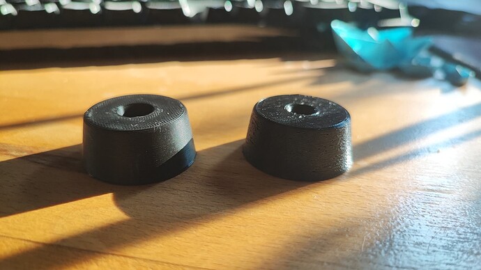

I tried printing TPU on the Mini. The first try was a disaster, using the settings for PLA, the TPU getting stuck because a Bowden Extruder does not really like to push to the nozzle.
Second try was with the settings for AmazonBasics TPU in the slicer, with half the speed and 235°C instead of 210 and it worked like a charm. Let’s make a guessing game: Which one is made from TPU, which is PLA (it’s kind of obvious, but I am still proud :stuck_out_tongue:)?
One on the right is TPU?
Never printed TPU yet, but your results are encouraging.
Yes, the right one is TPU. It does look a little less smooth, but judging from other pictures online of TPU I think that’s just the way it looks like. :slight_smile:
Not bad at all for TPU on a bowden! Must be a nice, constrained filament path on that mini?
Yeah, I guess it is. :smiley:

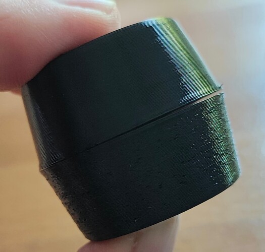

First (bottom) vs. fourth print (top). I think the humidity of the filament was better, since I had it in the drybox overnight and only printed the fourth foot today. Nearly non-distinguishable from PLA.
Drying makes quite a difference with TPU - for me it needs proper heat drying, but if it lives in a drybox in moderate humidity that is obviously good enough to make a big difference!
Not the first time I’ve heard about humidity playing a factor with TPU. I have two spools of NinjaTek, that I still haven’t “played” with yet.
I thought I was impressed with v1, until I see it sitting beside v4. 4 is now making 1 look bad. And 4 is making me want to get mine out, and print some aircraft wheels, which was the reason it was purchased in the first place.
What is your layer height there?
0.2mm.
I also thought 1 looked good, but midway of 3 it changed to look better. That was the filament that was already in the tube. So I reprinted the first three. :smiley:
I’m digging it. TPU sucks up quite a bit of moisture. Dry, dry, dry.

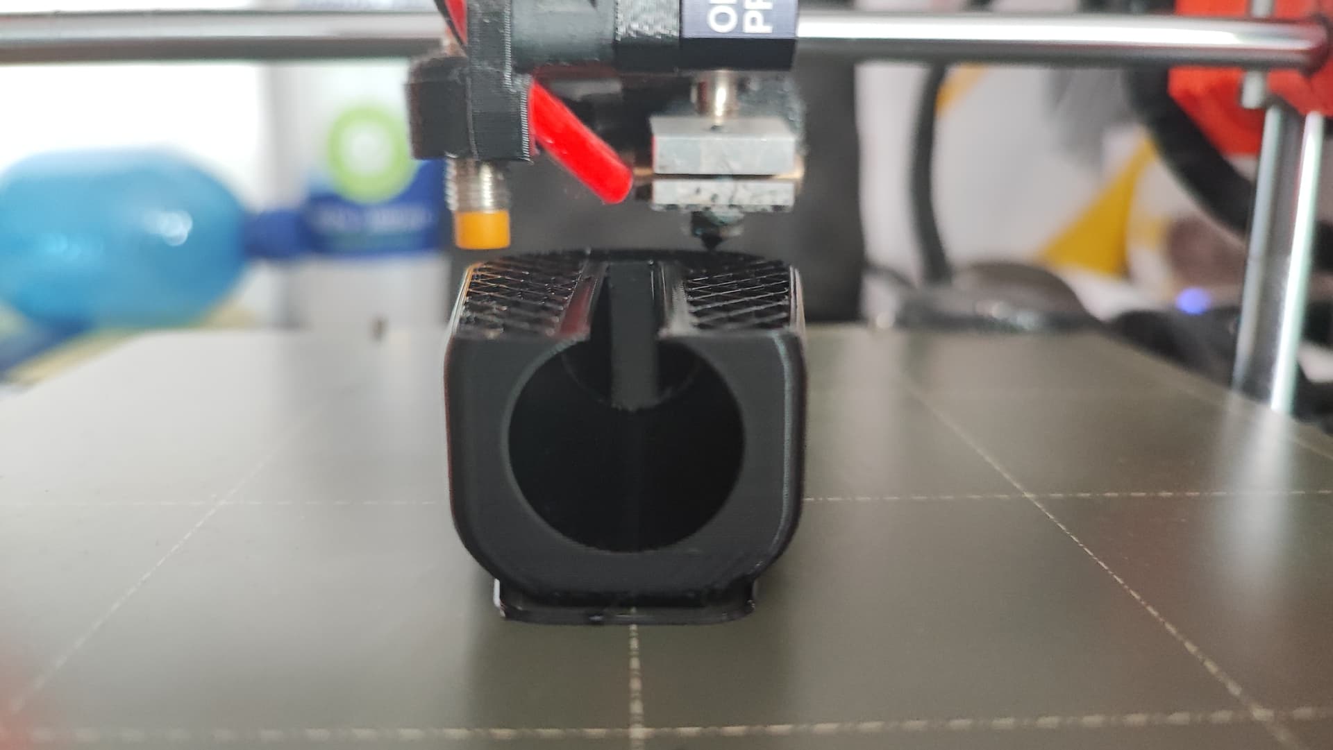

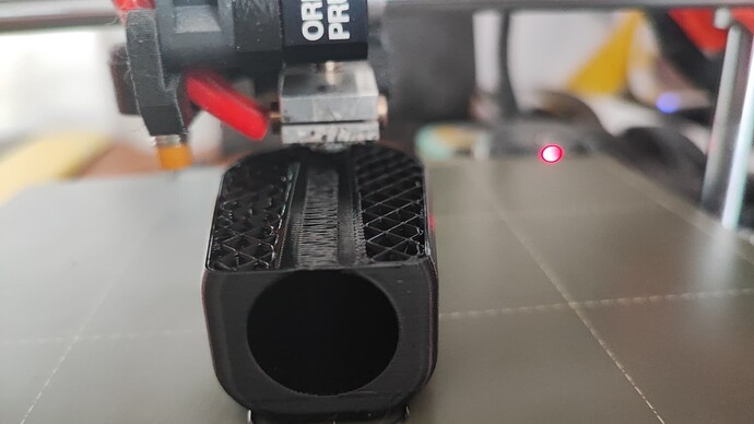

I printed some vacuum hose adapter parts using Hatchbox TPU on a Prusa i3 MK3S+. I read a bunch of articles first and then set up a Simplify3D profile. The major trick is apparently to turn off retraction. You get a lot of stringing, but your hot end doesn’t get clogged.
Overhang? Bridging? TPU doesn’t care.
I am pretty amazed.

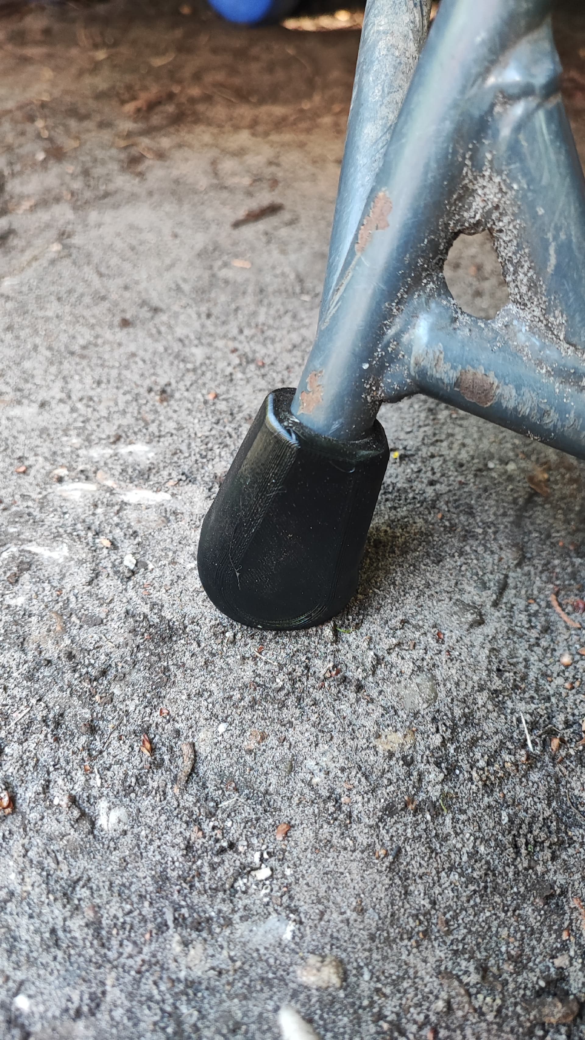

It’s going to be a foot for my cargo bike’s stand. Costs 7.5€ if I bought it, now it’s 50 cents.

Yea, tpu is very hydroscopic. Needs dried out before any print, even if it lives in a dry box.
Could have used more than 15% infill, besides that it turned out great.

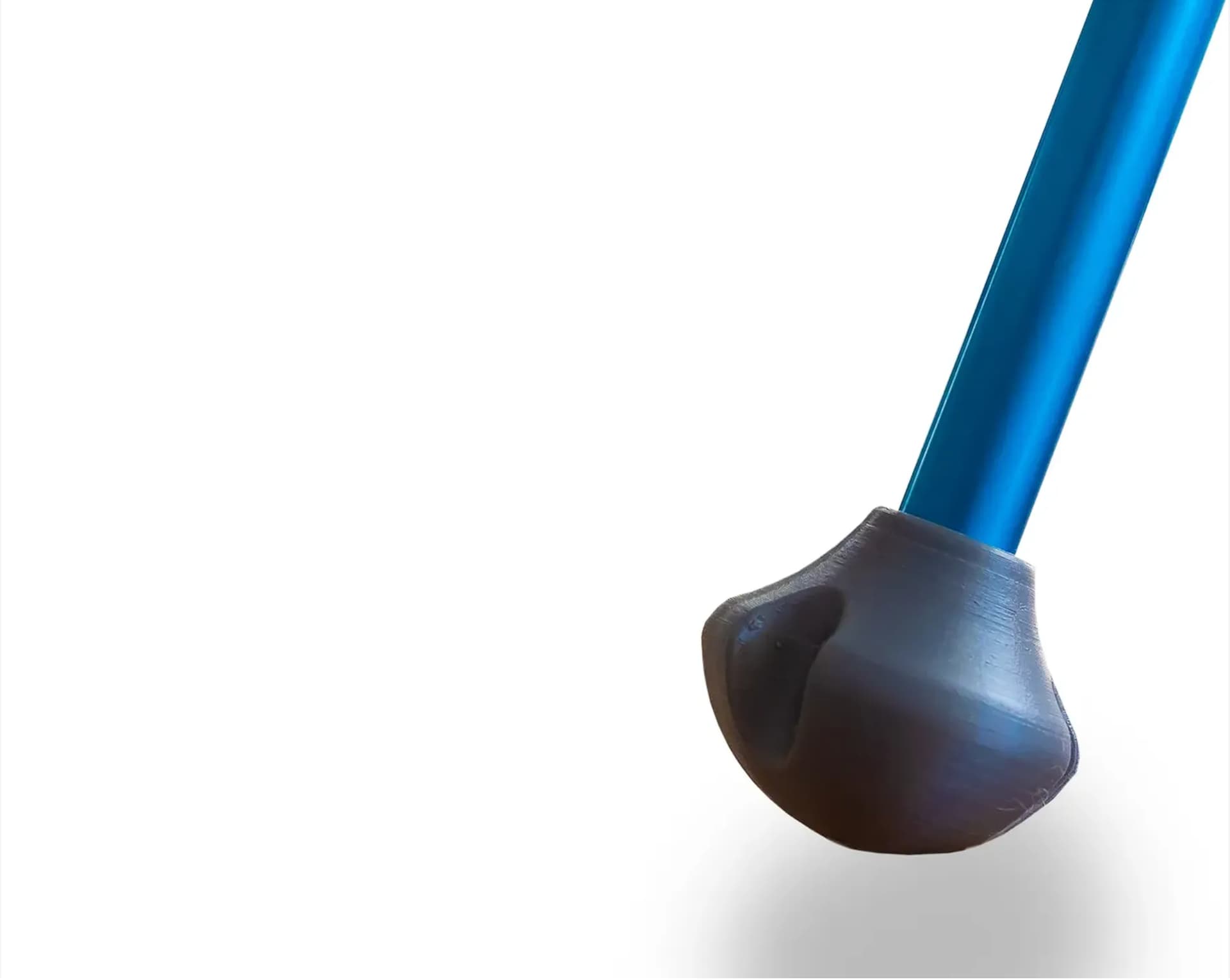

These were $45.00 to buy! :flushed:
Easy to print though! :rofl:
[(https://www.printables.com/model/119841-ball-feet-for-helinox-chairs)
I noticed that I have wet filament after the first few layers when printing TPU. That’s the one section where it is not in tubes but in the Bowden extruder of the Mini.
