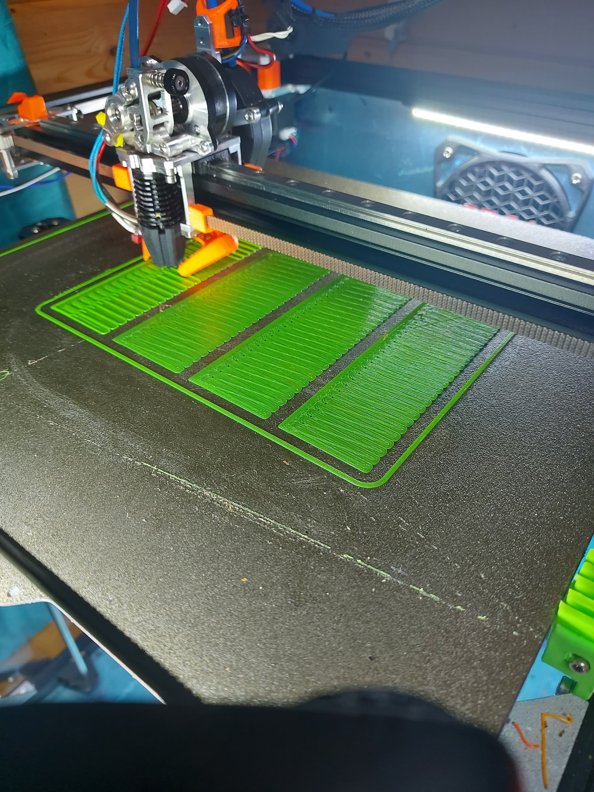

I am curious what durometer TPU people are using for their bristles. I printed some just now for my V3 floating dust shoe with 95A and it seems stiffer than I was expecting. Haven’t tried it yet though.

Large portion of the LR4 bristles should be one layer thick. Able to share pic of your prints/slicer?
Tried to find hints or recommended printers settings for vac hose bristles at https://docs.v1e.com/lowrider/#printed-parts. Couldn’t find there, but did find printer settings hints in the Printables description for the router specific vac parts. Personally used 0.6mm nozzle, 0.32mm layer height, 5 walls for the TPU bristles to help minimize infill and retractions that increase risk of jamb. Bristle finish seem smoother for it. Thoroughly dried overture tpu 95A filament came out more flexible than some of the earlier bristle designs Ryan shared with beta folks. Have some high speed printing TPU that’s easier than regular TPU.

I am only now printing the V4 bristles. The ones I had posted about are for the v1.1 floating dust shoe that Doug made for the V3. The V4 bristles are designed a lot different than the ones in Doug’s design so that’s likely why I thought it was too stiff. Once the v4 ones come off the bed I’ll compare. I printed the V3 ones at 0.2mm and the bristles were solid infill. The v4 ones I did 0.28mm height with 1 wall.

I’m printing some bristles at the moment I’m trying 40mm and 42 to see how they behave. If they are too flimsy I will thicken them up a bit.
The bristles finished and I printed an extra set in case I need to trim it shorter. The LR4 style bristles are definitely more flexible so yes 95A works well. The combo remix LR3 bristles fit into my dust shoe and look good, only problem is the shoe cracked when pushing it onto the mount so I’ll try reprinting in PETG for a bit more flexibility.
