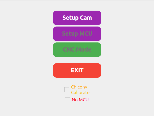

I’m now using a Raspberry Pi Zero 2 with a 640×480 Waveshare touchscreen attached, and I wrote a small GUI for it. The Raspberry Pi is connected to a USB hub, which connects both the webcam and the MCU. Since I’m using USB for communication, I need fewer pins on the MCU. Because of this, I decided to use an ESP32 instead of a Teensy, although they should be interchangeable, as both are supported by PlatformIO. I haven’t started working on that part yet.

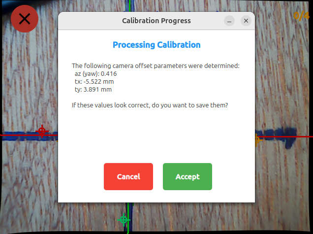

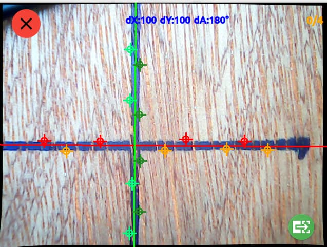

Most of my recent work has focused on webcam calibration. The webcam will be mounted in the top corner of the router. Once calibrated, it can precisely measure marks on the workplane, allowing you to set the origin based on the workpiece or pencil marks.
In pi/scripts/test-gui-laptop.sh you can run it from your laptop with a webcam. Which simplifies the development. I’ve included a brief description in my README.md, which can be found here:
Here are some images from my GUI idea

Can you explain a little bit more… the WEBCAM is for what?
The Pencil Cross is the Master on your WOOD.
And then you go with the Webcom over it.
Best possible looking, and you make some measurments to check how many mm or angel you are wroong from the MASTER PENCIL CROSS ?
And you ESP32 is only for GUI and DISPLAY and they talk with some more Pins to the Teensy to bring the Measurement Result as a OFFSET ?

Here I made a PDF to explain my approach a bit better. I hope it helps. I implemented so far the camera calibration and the GUI basics. Let me know what you think.

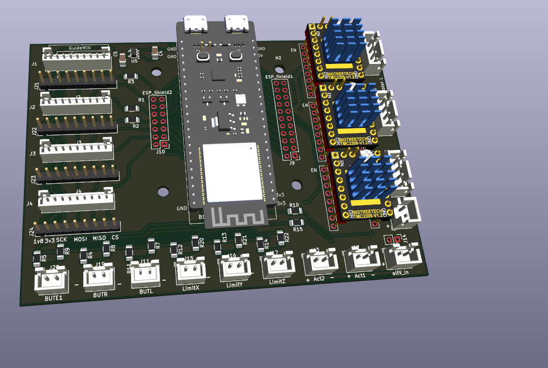

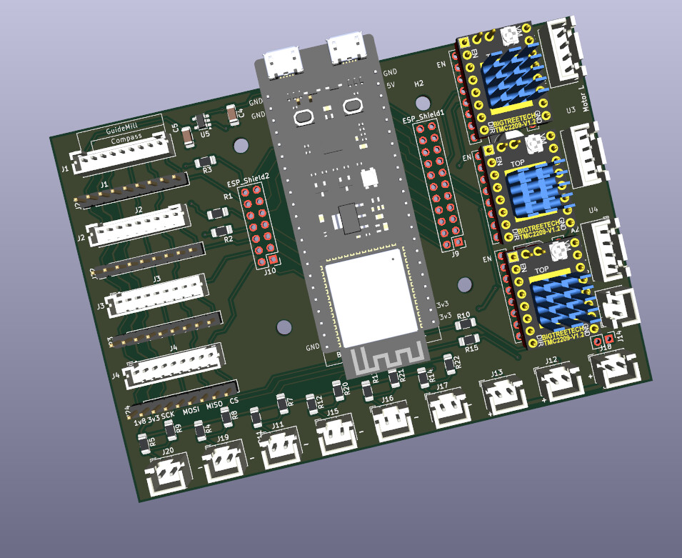

I now made some progress.

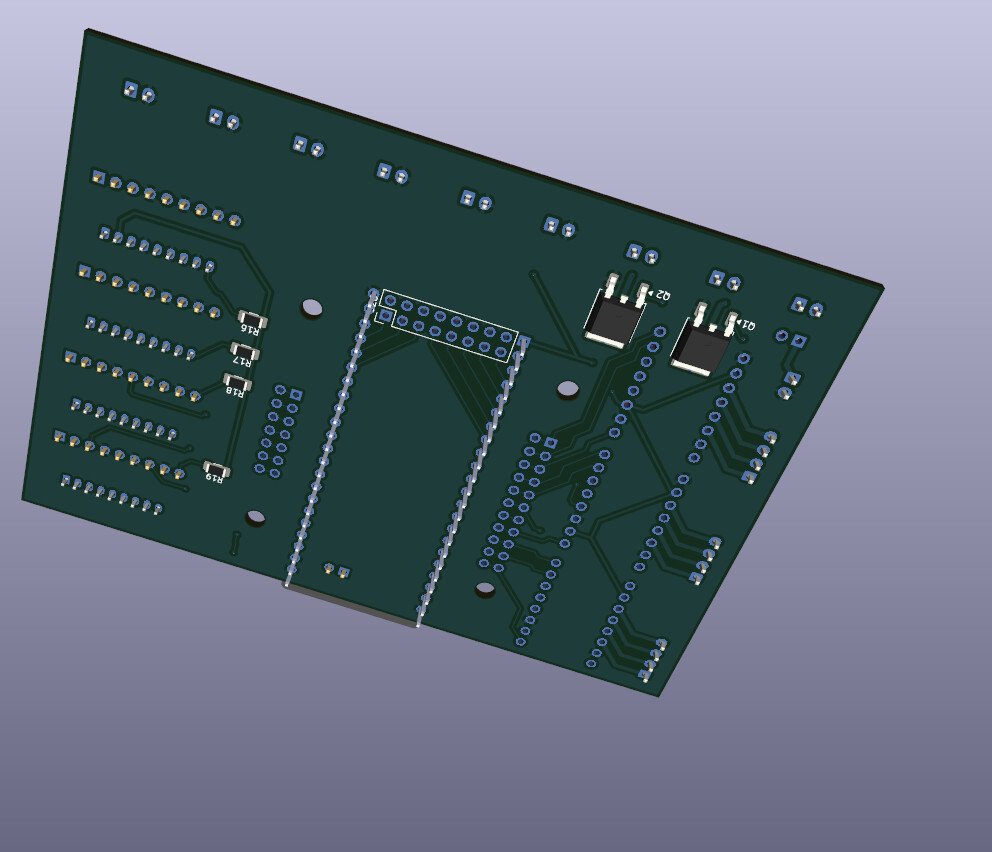

  1. I developed a Board that replaces the Teensy with an ESP32-S3 DevkitC 1. I changed it because I get the ESP32 for 8€. But because the ESP32 does not have SD Card my Board just works in combination with my Rpi and Touchdisplay. The ESP32 has only 8mB Data storage so the Raspberry will stream the gcode to the Esp32. I also added an extra Button. And two actuators. They are fully dimmable. Could be used for a blower fan and or light. The Encoder has gone because the control now comes from the touchdisplay. Still a lot of work to do because I have to transfer the whole UI part from the Teensy to the RPI.

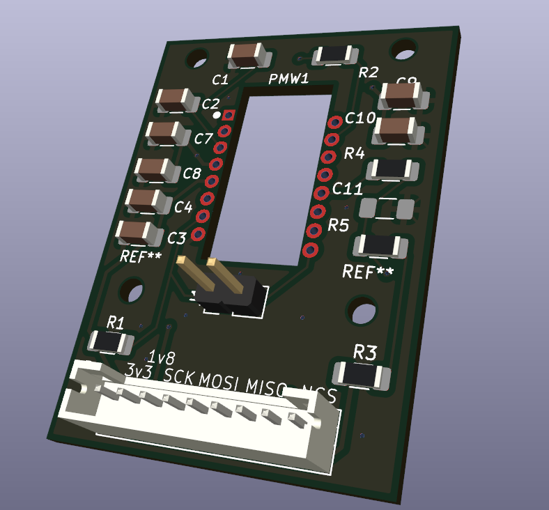

    1. I redesigned the Sensor board. I changed the resistors to 1206 type because they are easier to hand solder for me and I had some laying around. Also the 1,8v supply went on the main board. So I have one IC powering all 4 sensor LEDs. But on my main board the Sensor connectors are fully compatible with the original Sensor modules when you use an 8 pin connector instead of an 9 pin. I also added two types of connectors. Because I had problems sourcing 2mm pitch connectors. So optional one coulde use the 2.54 pitch connectors. Wich are widely available.
      Both boards are made to be as easy as possible to hand solder them. Only thing which is a bit tricky is the ic for the 1.8v power supply
