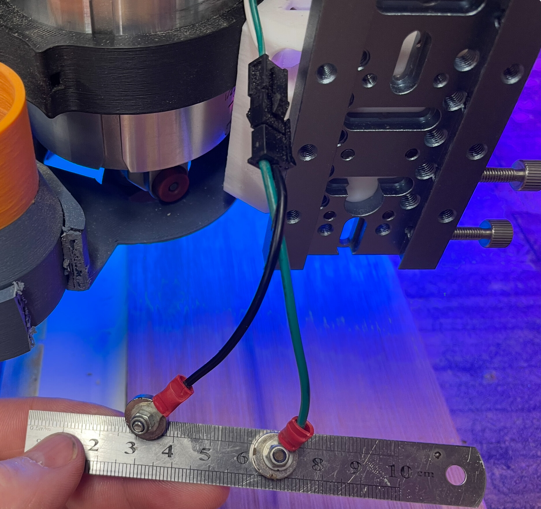

Here’s mine, I use magnets and a steel rule. One goes to the rule the other on the router chuck

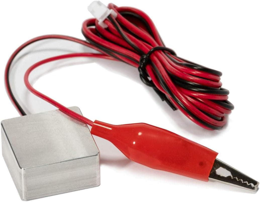

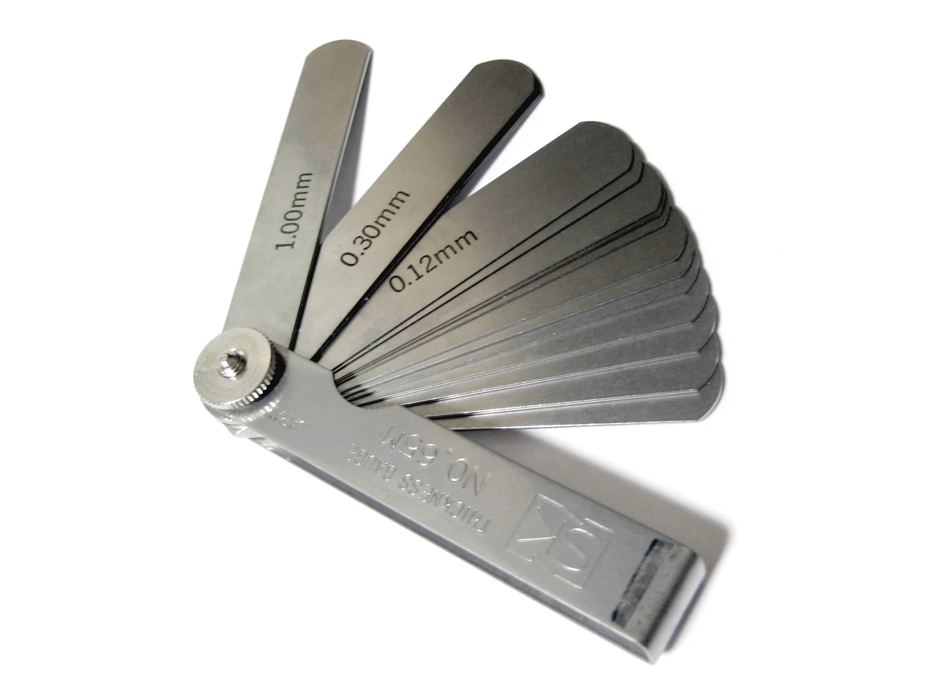

If you want a touch plate similar to what V1 sells, I’ve seen touch plates built from a feeler gauge like are in this set:
And and you can use any conductive materal of consistent thickness, even if you don’t know its thickness. You can use your machine to determine the thickness. Probe against the plate, remove the plate, lower the bit until it is just touching the material, and look at how far you lowered the bit.
As for the wiring, it is best practice to wire the sensor pin to the plate and the ground pin to the clip. That way, if for some reason the bit is grounded, your probing will work.
I’m not sure where V1 is posting the probing code these days, but you will have to make a simple modification in that code for the specific thickness of your plate. I believe the probing code is slightly different depending on whether you are running FluidNC or Marlin.

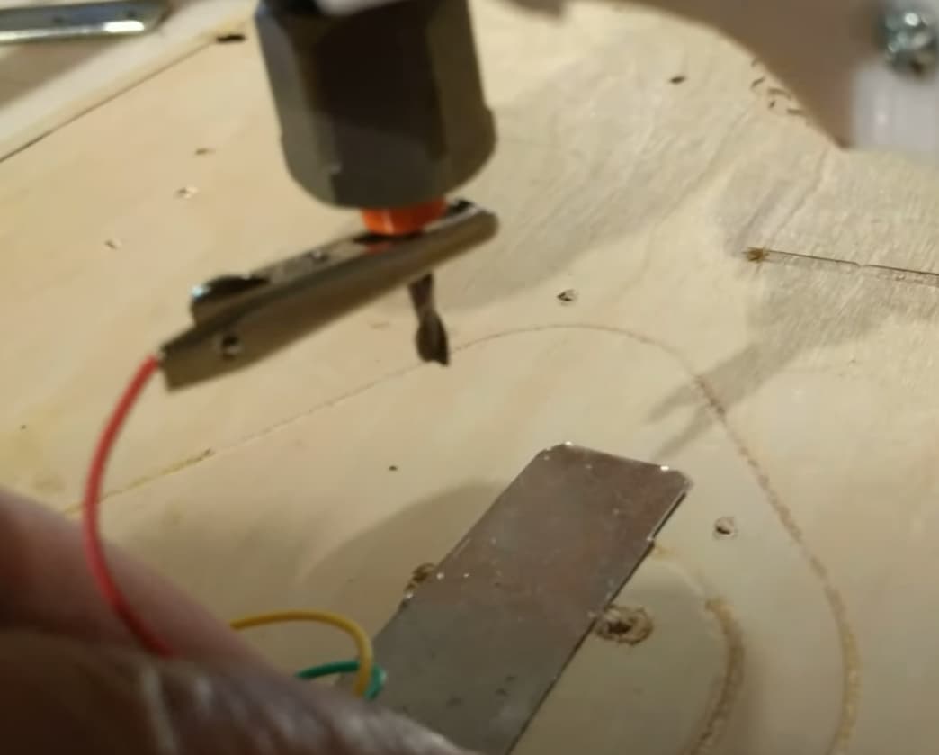

This is probably the least expensive option, just aluminum duct tape and wires with alligator clips
https://youtu.be/aT_9LtDPnKw?feature=shared
