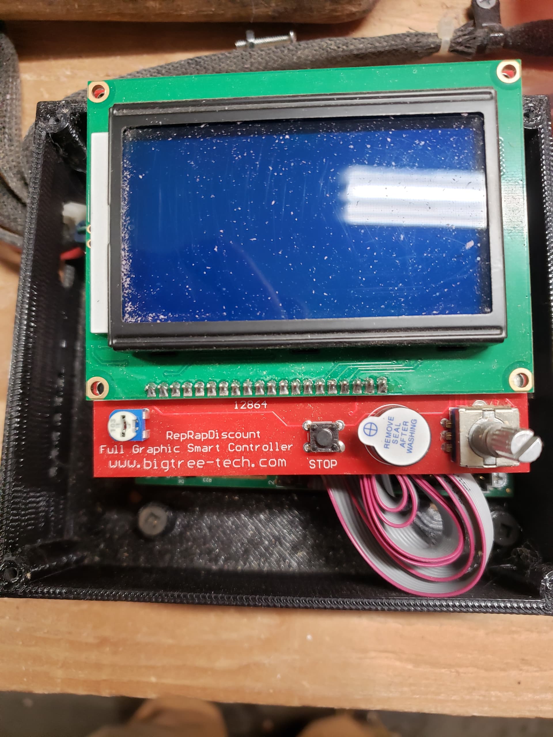

I have an MPCNC Burley with a mini rambo board that i built with my son for a collage project a few years ago. I recently dusted it off and got it running. The short story is i connected the touch plate wires backwards(power to ground )on the board and the screen flashed when I tested it. Once I wired it correctly it does not stop the Z when it touches. Everything else works correctly tool changes are hit and miss getting the z 0 with the new tool. I figure that a new board is required to use the touch plate and I am wondering which board to use. Thanks for any advice

Does your machine have an LCD or an ESP-01 web interface? If an LCD, which one?
Yes mini rambo, no end stops and lcd screen.
I will have to look at which screen it is when I get home from work today
Here are pics of the firmware version and the LCD screen
