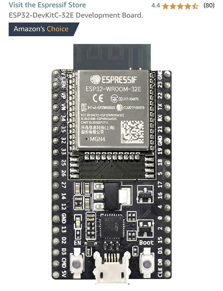

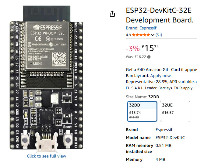

Guidance Counsellor :rofl: That’s tickled me. Thanks Guys. The TMC2209 is Out Of Stock (I’ll search for more) & the ESP-32 has DD & UE version ? Which one ?

You want the 32E. it should say ESP32-WROOM-32E on the main chip.

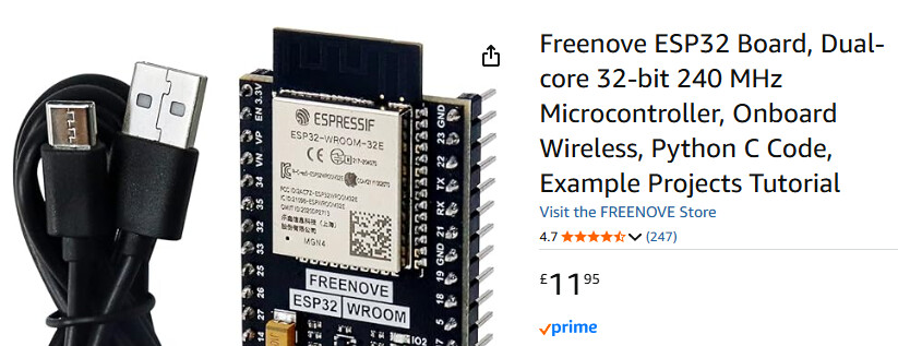

Found this one
Maybe.
That one isn’t an espressif made one, and may have a USB-C connector.
Some of those are a couple of mm wider than the ā€˜normal’ ones. It can still go in the jackpot, though in the worst case you have to slightly bend the headers on the jackpot and the pins on the ESP32 to fit.
We use ESP-32s with CP-2102 UART chips, but some manufacturers use a different UART chip. It can still work, just need the correct drivers to be able to open a FluidTerm console or to use the installers to put FluidNC on it.
