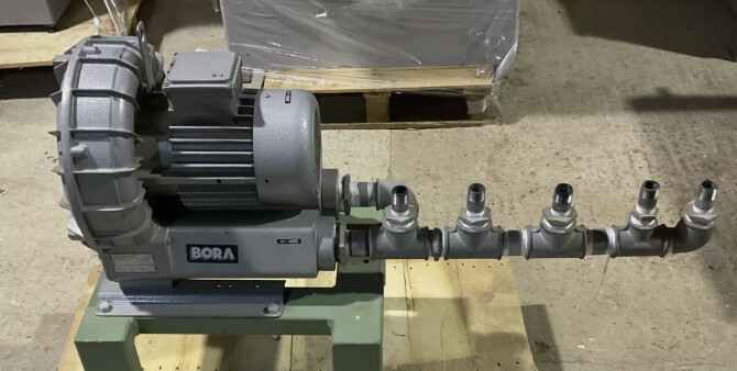

The Torsion table is laid out flat waiting to be screwed/pinned and glued up. I have made it from 12mm MDF. I have also bought a 2nd hand 3phase 1.5kw vacuum/blower that already has a manifold with 5 outlet pipes attached. I am in two minds whether to make a 4-zone or 1-zone bed, tempted for 4 zone since the manifold is already there.
I am concerned about the torsion box distorting when at full vacuum, the pump specs say the pump will go to 130mbar or 2psi of pressure, assuming minimal vacuum loss.

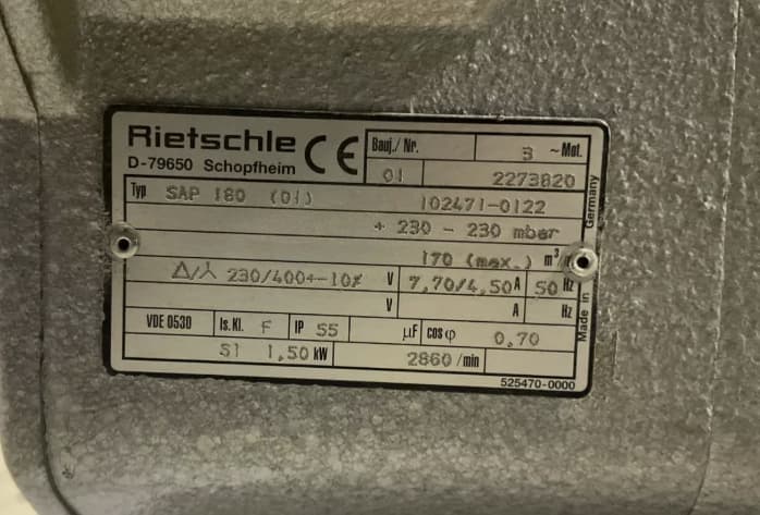

I made a mistake.
The vacuum is 230mbar (not 130mbar) or 3.3 PSI. Volume is 170m3/hour or 100 ft3/minute. Not quite the 200ft3/min you mention but its a start.

Here is the plate from the pump.
and pump itself…

If it’s 100cfm, I would think you can go a pretty long way with it. Just making sure it wasn’t something like 5cfm or something

I have one of those pumps (Seitenkanalverdichter) as well. You can find pictures of my suction table in my Ghostrider thread. It works well through MDF, I cut the grid in plywood though as to not lose suction.

Man that air pump should use a relief valve an a filter in the vacuum side

I hadnt really thought of the bypass and filter as I thought there should be very little dust sucked in the torsion box as it would be a sealed chamber but if I add a bypass valve I guess it it will be needed, again thanks for the headsup. The pump should arrive tomorrow. I will order after I check pipe/thread sizes. The 5th outlet on the manifold will be a good use for the bypass valve.

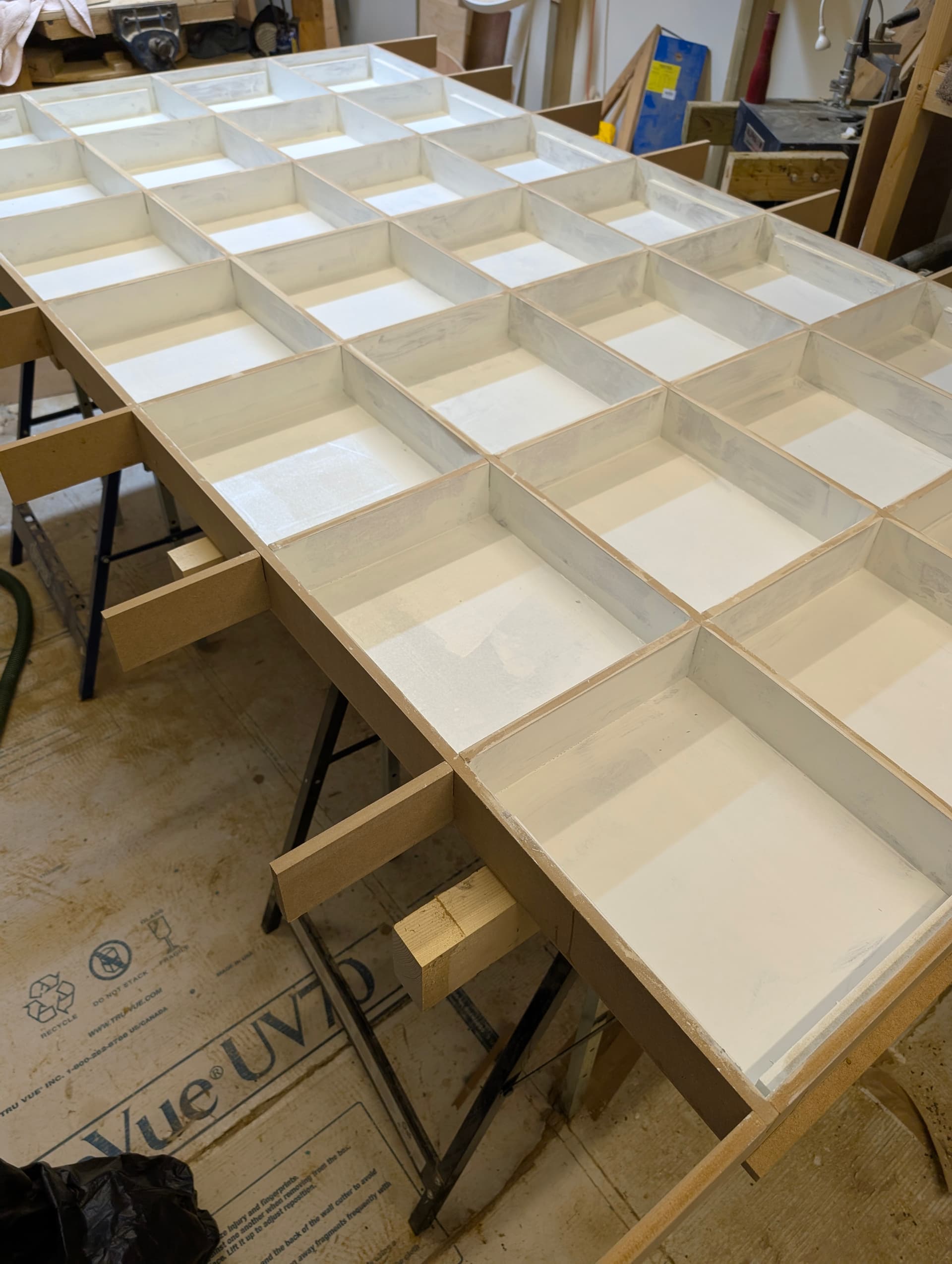

The torsion box has its first skin attached. I have painted the inside surfaces with old tin of gloss paint I picked up for a $5.
Tomorrow I intend to drill holes in the spars that seperate the skins so that vacuum/air can move around under the hole surface but I am having second thoughts on the design.
I am intending to machine grooves into the top surface of the torsion box to pass vacuum through to the sacrificial board that the sheet that will be cut sits on. Will this weaken the top skin of the torsion box? I intend to use 12mm MDF so it’s not much to work with, this way the whole torsion box develops a vacuum.
Or should I use the torsion box solely as a stable surface and perhaps add a 18mm MDF sheet on top of the torsion box and mill a square grid of grooves into this, seal it and then connect it through a centre hole that runs though the torsion box to the pump plumbing underneath? a 12mm sacrificial mdf board would then sit on top of that.

I’d say keep it separate. The skins of the torsion box don’t actually have to be very thick, technically speaking. They are providing rigidity by aligning all the internal spars using their flat-plane stiffness, like how it takes almost no force to bend a piece of paper but lots of force to pull it apart. They’re also supporting any point loads on the surface so that the load can be distributed out to the spars so you don’t ‘dent’ the tabletop of have local sagging in between spars. Those are actually 2 different tasks that get combined into one by having a thicker top, usually.
The trick is that you need to have good joints to transfer the load through the structure. If you’ve got a thick skin you can just sink screws. If you’ve got a thin skin then screwing gets difficult because you’ve got less strength to resist having the screw dragged ‘through’ the skin, gouging a path. So the thinner the skin, the most you need a fixing solution that’s valid for that material. 18mm plywood or MDF and you could just use screws into each section of the spars. 5mm plywood and you might be ok with more screws but might want to use glue. Thinner than that like 2mm or something and you would want to start gluing or using a ton of brads/small screws etc.
Thinking about it that way should hopefully make it clear what will be acceptable or not with the skin surface in terms of cuts in it etc.
You could do torsion box with thin (~5mm?) skin on top then an 18mm MDF vacuum plate above that. You could do it with a thin skin on top then a sacrificial 12mm ply and then the vacuum plate. You could do it all-in-one where the top skin is the MDF vacuum plate and just plan to rebuild/replace if needed. I think replaceable top skins work best when you’ve got something thick enough to fix it using just screws, or a plan for how to get it apart. If you’re doing a sacrificial work surface with the skin below that then I’d go for a permanent thinner skin with a lot of fixing and a replaceable work surface with way fewer fixings.
As for the vacuum aspect, I’d definitely do those as separate things. I don’t think you’d be wanting to draw a vacuum onto the inside of the torsion box because it’ll slow down the rate you can pull a vacuum quite significantly, which is important for pulling things into line. The higher your flow rate, the more force you can apply to a joint that’s not completely sealed which will pull it down and seal it. The more volume you have to evacuate, the lower your flow rate will be because you’re drawing down a bigger space etc.
Thanks Jono. I have already bought two 12mm MDF boards, one was going to be the skin, one was going to be placed on top as the sacricial board. I was going to carve out a pattern like this on the skin….
And run a foam gasket around close the edge.
I have a 100ft3/min pump and I calculate that the internal volume is around 8ft3 so I don’t mind waiting 10seconds or so for the board to be gripped (assuming I can get it sealed sufficiently on the sacrificial layer)
I am planning to skim the surface of the sacrficial board on both sides what ever design I go with.
The spars are 12mm so I don’t have much to screw into as the inside of MDF is pithy. I used some scraps to test how good a pull I would get using 35mm x 3.5mm screws and I got almost zero bite. I didn’t drill pilot holes, I could try again with longer beefier screws and pilot holes but because it’s 12mm end on I expect much of the strength to come from glue.
My main questions currently are:
  1. Do you think that the vacuum torsion box with just a 12mm plain MDF top skin (no routed air channels) and a 12mm sacrficial board allow enough vacuum to hold the workpiece?
  2. Would a 18mm top skin with a plenum grid machined similar to the photo above with a skimmed sacrficial board on top of that work better?

12mm should be tons, I would definitely drill pilot holes all the way through once the skin is in place, even if just to secure things. There shouldn’t actually be much load in the direction you’re screwing it in, the screws are there to essentially keep the spars upright. It’s relatively small load and ‘sideways’ on the screw. I’d also screw it so that I could check for bulk flatness before gluing it all up. Obviously surfacing it will sort some of it but it’s better to have it flatter to being with so the surface is closer and the rails and co-planar. That said, it’s pretty easy to add runners for the rail/running surface etc.
So relying on the vacuum straight through the MDF? That I’m not sure of. I know air flows a little in the core of the MDF but I think the outer surfaces are pretty sealed. That’s reaching the end of my familiarity and I’m just going off rough memories of what I’ve read here before.
I would certainly expect something like that to perform better, I would say it’s more a question of whether it’ll perform better enough to be worth the hassle.
If it were me, I’d be making a smaller scale test setup and seeing how that performs. Maybe make a 1’x1’ / 300mm x 300mm square with each option and see because it should be pretty linear… For flexible materials, I think it’d ‘feel’ the same in the smaller case because it’ll be more about the force per area rather than the overall. If you wanted to you could also try to temporarily seal the table and draw a vacuum on that to see how that changes the ‘bite’ of the table and how long it takes to draw a vacuum.
