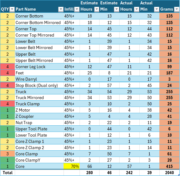

I printed this spring on an Ender 3 Pro (not S1) also with .4mm nozzle.
I would have to check what acceleration I used for setting but I printed the parts with the recommended infill and .2mm layer height.
My total print time was just over 242 hours.
I tracked each part on a spreadsheet that I can post later if you are interested on the breakdown.

Here is my data:
The first 2 columns with numbers are the estimated time from my slicer and the next 2 are the actual time it took to print. Final column is the amount of filament used in grams.
The Core was printed fully at 70%. I did not catch the note about 70%/30%/70% until after I printed.
I printed each part type separately so I could stay organized. Parts with multiple were printed together, i.e. all 4 feet were printed in one batch.

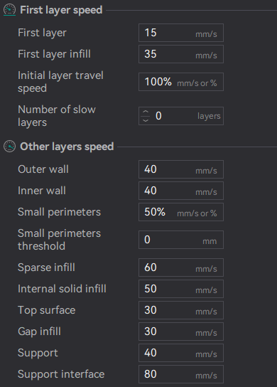

Here are the speed settings that I used:
Consider my times to be on the high side. I did not want to push my printer since it has failed prints before and so I wanted to play it safe.
