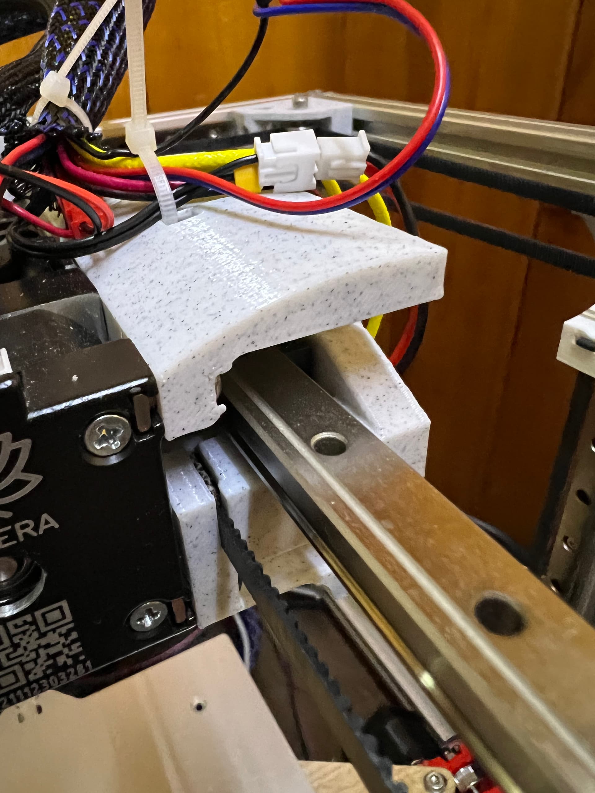

Have pictures of you setup, particularly of the belts and locations that they’re pulling out of?
Sure thing. Please disregard the state of the work surface. Since I’ve had to take it apart so many times, I’ve not put the effort into tidying it all back up.
Here is the birdseye view
The right hand side:
And the left hand side:
Since taking that picture of the left hand side, I’ve pushed those belts back down into place. Over the last few days, the right has pulled out 2x and the left 1x, if I recall correctly.
I suspect that the twist in the belt on the left maybe causing part of my heartburn here. I hadn’t really noticed that until I took this pictures.
The V1 design to hold the belts depends on the thickness being gripped in the belts. The 6mm belt will be less stable but if the locking piece is good it shouldn’t twist like that or pull out.
If you fold the belt over just past the slot it won’t be able to pull put.
That works for the first side you connect the belt.
For the other side, pushing in something like a sewing pin will make the joint more solidly wide, and will prevent it from coming out.
This is what I did for the bottom belts. Folded over, and then pulled into place. But for the top belts, I can’t see how to fold it over past the slot without bringing the belt in at a pretty steep angle. It’s solid part at the end of the slot
I hadn’t thought of shoving something small in there to help hold it all in place. Last night, though, after I wrote this, I glued a small piece of belt to the main belt. Let that set, and did my best to stick it down in there. We’ll see if that holds any better.
