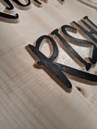

I’ve been doing a number of signs with lettering and graphics in soft pine. Things are getting better but there is always a bit of post processing to be done. I have a hard time getting a smooth transition between roughing tool and v bit tool.

Yeah I’m thinking I need a bit more than that. You can see the transition on the perimeter of the letters. I suspect it was a slight touch off error during the tool change. Maybe some dust was under the touch plate. Pretty awkward to clean up
Unfortunately, the soft pine is actually quite unforgiving when it comes to fuzz. Since it cuts so easily, strands turn up all over the place. Did you use finishing passes?
No I didn’t put a finishing pass on the carve just because it was already a 2hr long cut. It would have probably helped. It just sucks that pine is so readily available in nice flat glue ups. I haven’t found anything else reasonable priced that’s nice and flat.

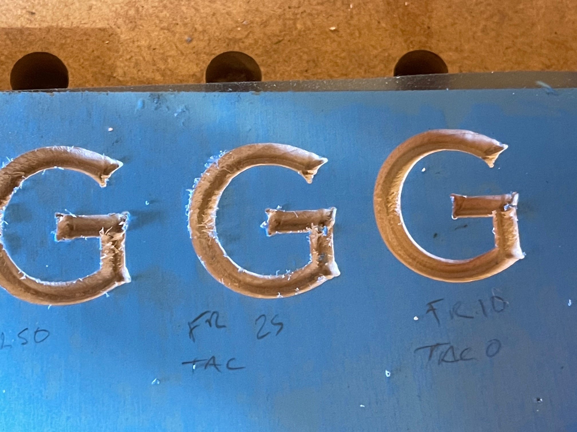

I had some improvement with turning on climb milling vs conventional milling with some poplar fuzz. Also lowered my feed rates. Didn’t totally fix the problem but in doing some test cuts i found obvious differences in the sample cuts.

I could probably do climb milling for the vbit carve part. I’ll have to figure out of estlcam will allow that.
I had tried my hand at fushion but can’t seem to get it to do embossed letters properly.
I use ESTLCAM, its in setup menu. under milling direction.
But isn’t that for all milling then? I think I’d want my pocketing tool to still be conventional milling

Yes it would change it for all milling. Might be an option to generate a cleanup pass with just climb. But also try lowering your feed rate. I got greedy when cutting pine because I can go so fast.

I was surprised how much of a difference it made. This is using a dewalt 660 with a 1/8 inch v-carve. 100% throttle. But your photo looks like you might even be in a better place than my slowest cut.
