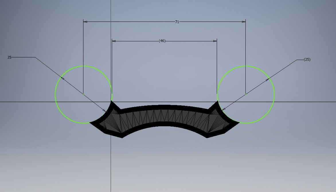

Thank you, Mike and Ryan. The 37mm distance and 35mm radius give me perfect alignment of the bolt holes with the tool mount.
I know this is an old thread now but google brought me here so I thought this would be good place to post.
Between the images on the this thread and in Ryan’s thingiverse post I still didn’t think their was quite enough dimensions shown. I managed to pull the dimensions I needed from Ryan’s model using freecad and then remodeled it in Sketchup (since sketchup is my user friendly modeling program of choice, noob here). I’ve attached what I came up with for your reference.
I hope these isometric views are clear enough for everyone. I’ve also attached the sketchup model.
The sketchup model has a flat face on the front that the user can just push/pull and go to town.
Tool_Blank.zip (37.1 KB)
I also know it’s an old thread but maybe the best thread to ask for another dimension.
I have printed the F-parts for 25mm conduits from thingiverse and now I wanted to print a tool mount who fits perfectly to the MPCNC but I am not sure if the distance between the conduits is 46mm.
Maybe someone can help me.
It will benefit everyone if you make it fit the tool mount (I even provide a solid file to edit). If you make it fit the rails directly the other two versions can not use your hard work.
