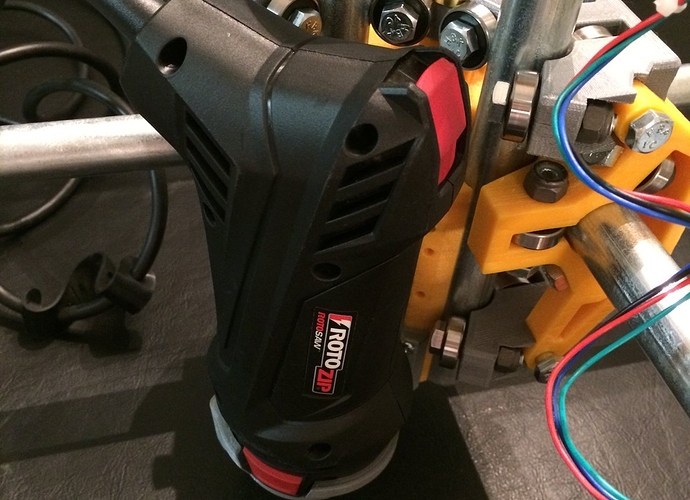

Tool Holder for RotoZip SS355 - 3D scanning

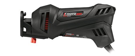

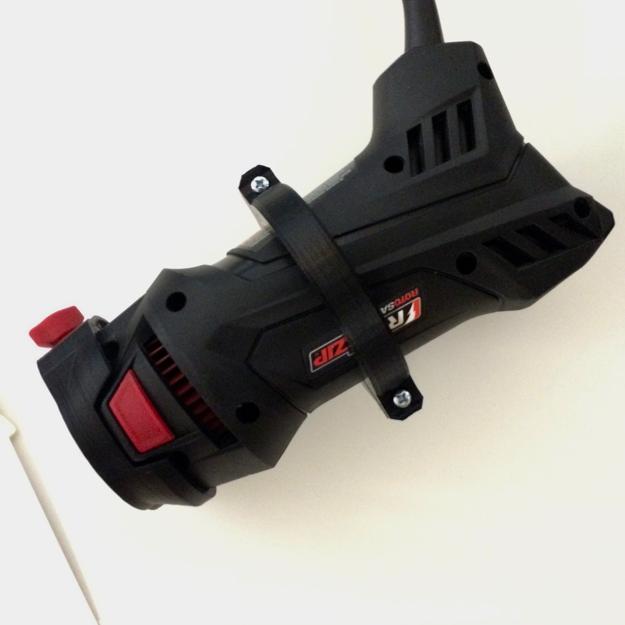

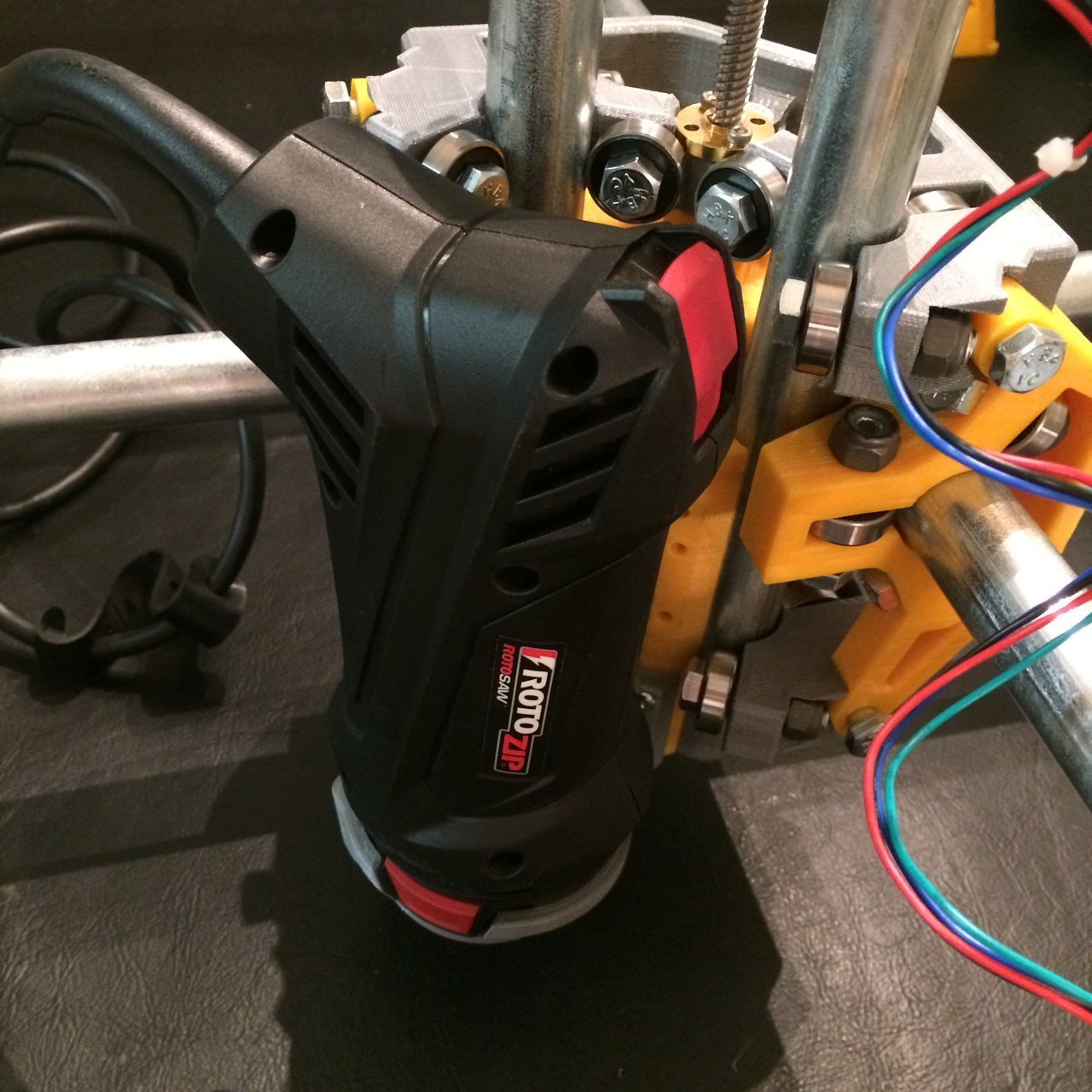

I wanted to put an unused RotoZip SS355 into service on my new MPCNC. I haven’t been able to find a tool mount for it and thought I’d design my own. It’s a tool built with excessive style, and has a tapered hand grip and an even more aggressively tapered business end. Just for fun, the tapers aren’t rotationally symmetrical.
[attachment file=93510]
The SS355 does have a depth guide that is bolted on, so I think I can use that to secure the tool in the holder, which is good because the tapers will be working against any clamping I do.

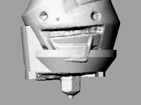

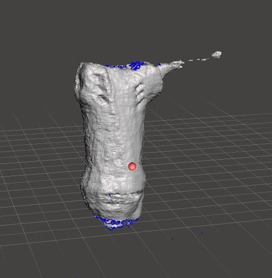

My first thought was to 3D scan the tool with an old XBox Kinect and the ReconstructMe software, but the depth resolution isn’t good enough for the task at hand.

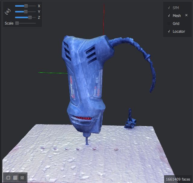

I struggled with Meshroom for a day or two and ended up having to downgrade to a previous release. The results, however, are kind of stunning.
I fed the software 64 images of the RotoZip tool and let it digest them overnight. This morning it produced the following mesh:
[attachment file=93872]
Next step, CAD.
Wow, that is really good for only 65 pictures.

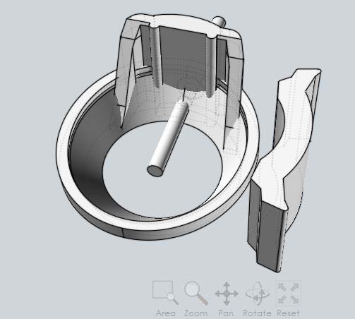

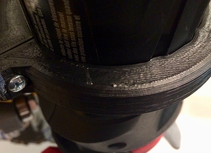

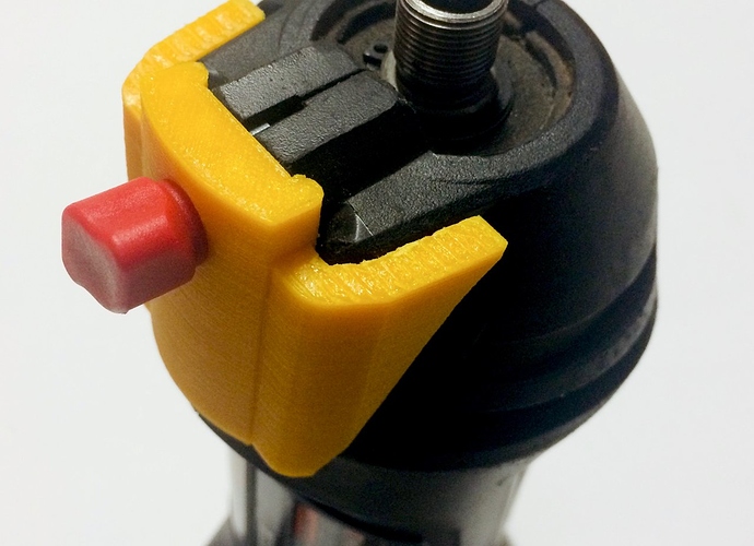

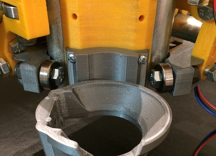

Thanks to Edward’s scan I’ve been able to make quite a bit of progress on the lower mount.

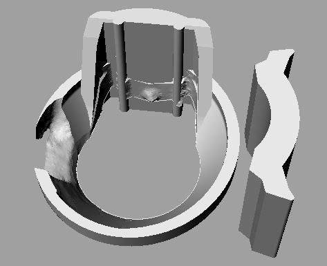

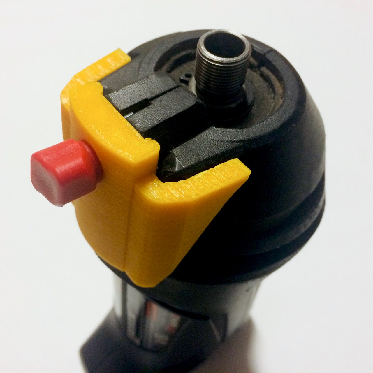

I started by making a part to fit into the depth gauge slot, then overlaid it with some basic geometry based on measurements of the rotozip.
Next I dropped Edward’s scanned model into the part, and used Boolean operations to check for collisions and get a better idea of what fit and what didn’t. After several tweaks and revisions the fit is close enough to add the mounting components (based mainly on the standard Dewalt 660 mount) and test a mountable version.
I’m no engineer so I’m trying multiple approaches to make sure the tool is correctly aligned and stable with the idea that one of them will eventually work best.
There’s still more to do, but I’m pretty excited that it can now be attached to the tool mount.
[attachment file=109475]
I’ve sent Edward files to test with his RotoZip. If anyone sees anything that could be improved, I’d love to hear it.

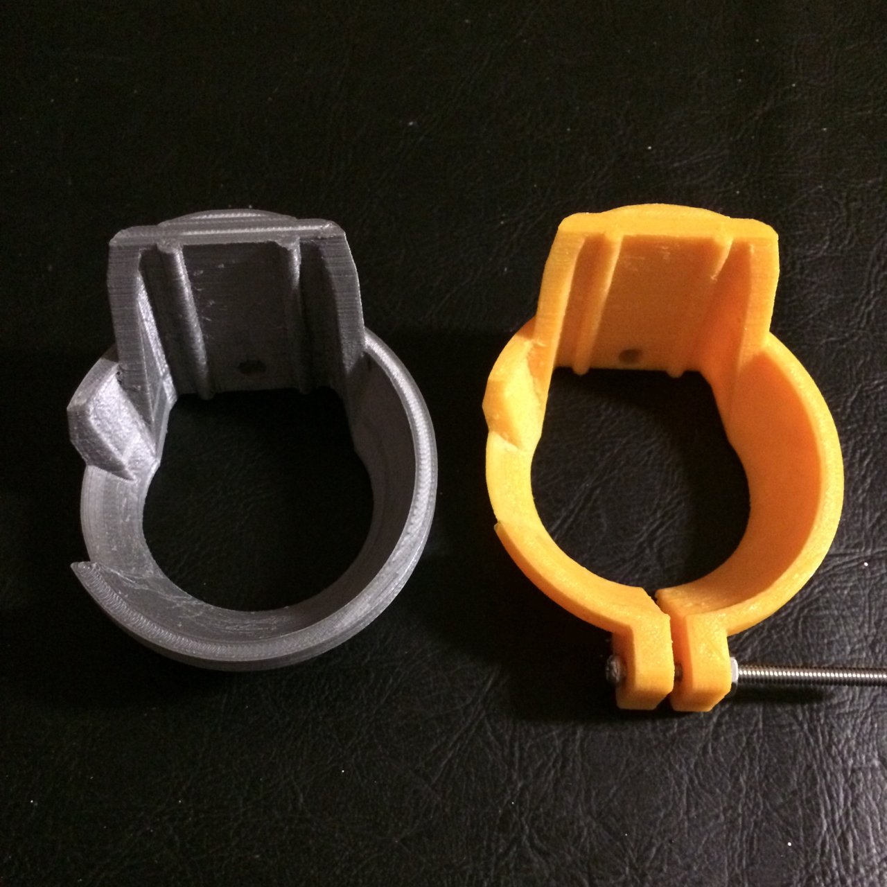

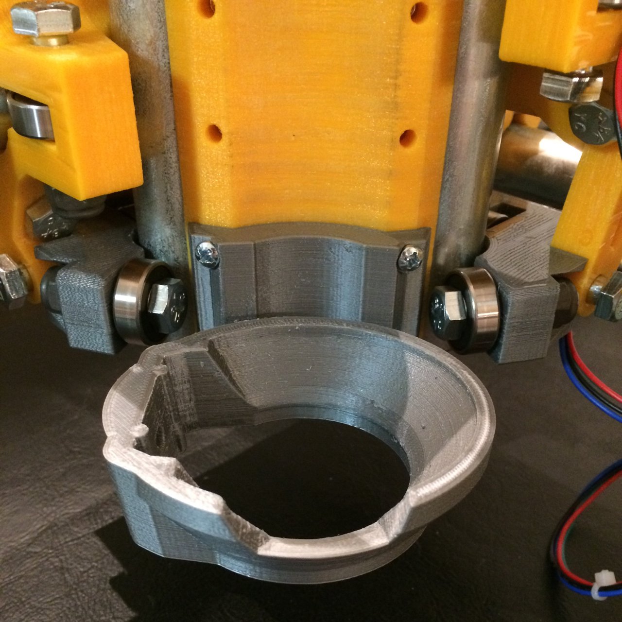

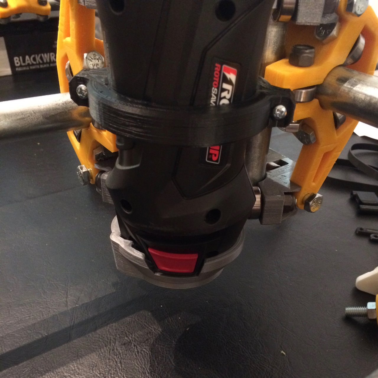

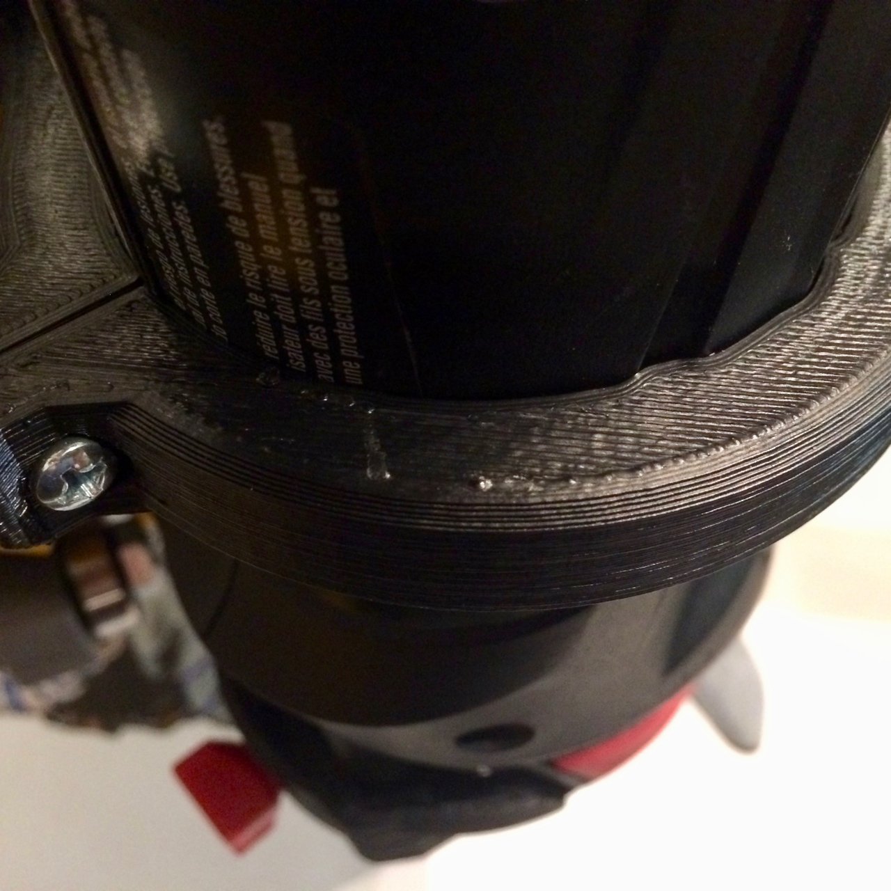

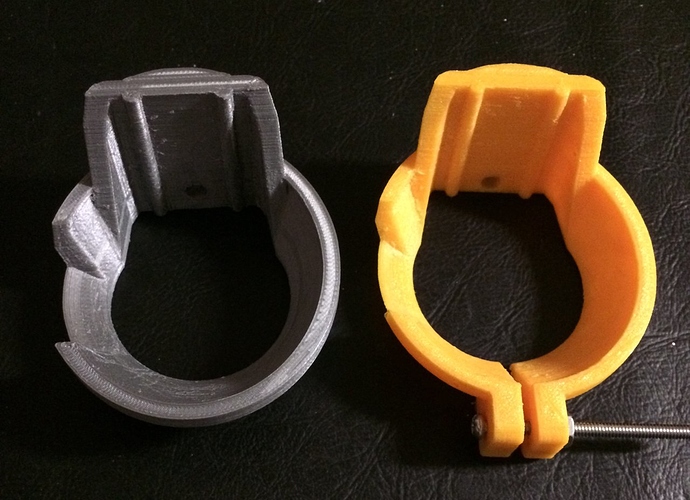

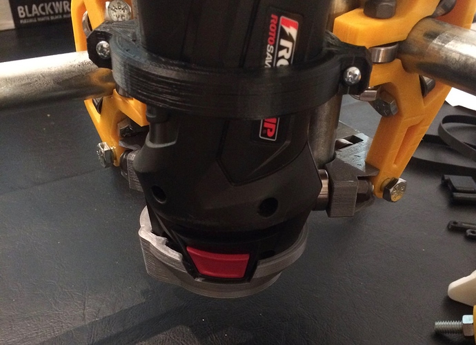

Edward and I have both test mounted our Rotozips and the fits seem secure enough to mount the tools for testing. I haven’t milled anything yet, but will be trying it out in foam and then in wood as soon as I finalize the wiring on my machine. I’m really excited to see what it can do. I’ve have a lot of fun collaborating on this one. At this point, I’m turning the thread back over to Edward, without whose help I don’t think this would have been possible. [attachment file=“Test Mount.jpg”]
[attachment file=“Both Mounts Final.jpg”]
Ok, this is probably going to end up on Thingiverse as a remix of the scan and Ryan’s DeWalt mount. I’ll duplicate the license from the DeWalt mount.
I strongly suspect Ari and I are going to be the sole users of this design, but it seems appropriate to share it.
