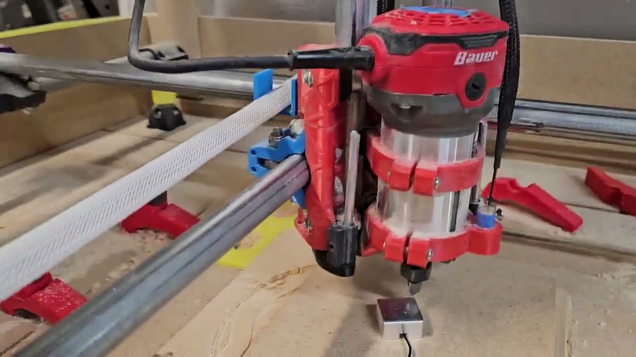

Running jackpot/fluidnic and I’m cut/pasting the tool change gcode into Ecam.
M63 P1 ( turn off pin 27)
G91
G0 Z10
G90
G0 X0 Y10 F2520
M0 (MSG change tool, probe)
G38.2 Z-80 F200 P0.5 ( Probe set thickness)
G00 Z10.0000 F500 ( Clearance )
M0 (MSG remove probe)
M62 P1 ( turn on pin27 )
I run the program, get to the change, change bits and continue, the tool probes down and touch the plate and picks up, remove the plate hit continue and the machine is cutting in the air pretty much at tool plate height. My probe plate is 15mm thick and it’s set correctly in the fluidnc dashboard, it works correctly for the 1st cut but not after the tool change.
I assumed the p0.5 was telling the machine that the plate was .5mm as that was the default when I first activated the probe tab. But setting that to 15 tries to drive the tool through the bed.
Where am I going wrong?
In this line of code that I quoted, the “P0.5” part is saying the plate is 0.5 mm thick.
You would need to edit this line of code so it says “P15.0” or whatever your plate thickness is.
So, if the tool change probe script code you posted is not your edited final code, can you post that?
Is it driving through the bed on tool change probing? Or on cutting after the tool change probing?
The regular probe script and the tool change probe script should match.

This is the copy/paste from the ecam as is. Changing the .5 to 15 is whare I first did when it was cutting air but it just drives the tool straight down into the touch plate and holds firm so no cutting is an option. The touch plate is pinned to the bed by the tool.
I’m using the probe button on the fluidnc dashboard, I don’t use the in gcode script.
So you get a successful probe with the +10 lift off when the 0.5 mm is listed, but don’t get a successful probe when the plate thickness is changed to 15?
The code you posted here still seems to be the code before editing. Can you post the edited code?
Any chance the wiring connection for the probe is not solid? Intermittent?
The edited would just be
M9
G90
G0 X0 Y10 F2520
G38.2 Z-80 F200 P15 ( Probe set thickness)
M7
I’m not changing anything besides after the P.
The wiring is solid, this is only happening at the tool change.
Hmm. Well, the P15 looks right. I mean you don’t have a minus in front of the 15 or anything.
Next up is, the target distance of -80.

Does it work if you type this in directly in the terminal?

So… you probe down to 15mm and are surprised when it doesnt lift after you tell it to go to 10mm?
Try
M9
G90
G0 X0 Y10 F2520
G00 Z25.0000 F500 ( Clearance )
M7
On particular note:
Good catch!
G91          ( -- set Relative distance mode)
G0 Z10    ( -- move 10mm in +Z direction)
G90         ( -- set Absolute distance mode)
G0 X0 Y10 F2520
G00 Z10.0000 F500 ( --- still in absolute mode, move to Z10, -5mm from top of 15mm thick probe)
There’s no good way to Bold something in preformatted text mode, but he was pointing out the need to change the Clearance line to this
Which I kept misunderstanding because I didn’t notice the difference between his and Nathans
I was mistaking his machine for being a LowRider, based solely on the 80. I was explaining that, if it’s a LR3, and if it’s got regular size YZ plates, and if he has max travel inputted and soft limits enabled, the probe target distance cannot be more than the available travel.
Based on the video, it’s MPCNC, not LR3, and all the above become moot.
Right.
Yeah got a bit mixed there, but that’s the gist. That was why I put to pay particular attention to the G0 Z25
Could put a G91 before and G90 after the G0 Z10 line as well to tell it to lift 10mm relative.
This, I think, may be the winner.
However, I’m still a little foggy on why it would not work as he had it.
G90 = absolute positioning, but based on Zero of the current workspace.
He probes, and with the P value, it means a new Zero gets set in the current workspace.
So, even if G90, would not “Go Z to +10” mean, “10mm above the newly set Z zero offset”?
If not, I need to go study it all some more.
The problem was that he set the probe height to 15mm then because it was in absolute mode, telling it to go to Z10 was basically telling it to dive another 5mm.
