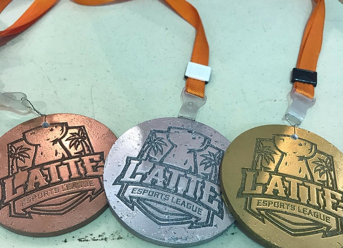

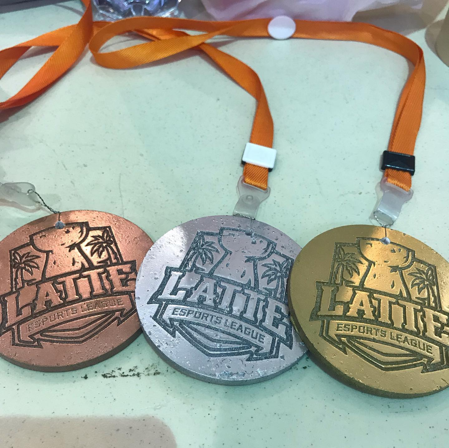

I use a collet adapter from 1/4" to 1/8". I made these with a 30 degree but, and the text is about 5mm tall. Winston Moy also did a test on a collet adapter and run-out was something like 0.0012".[attachment file=111738]
