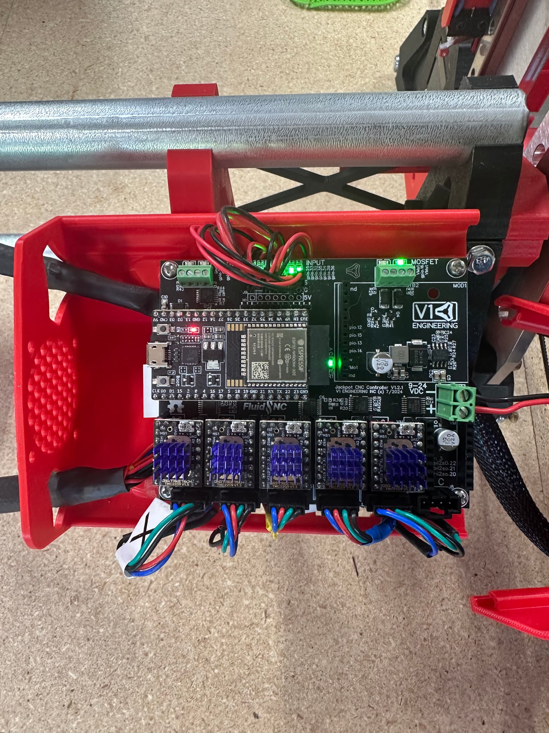

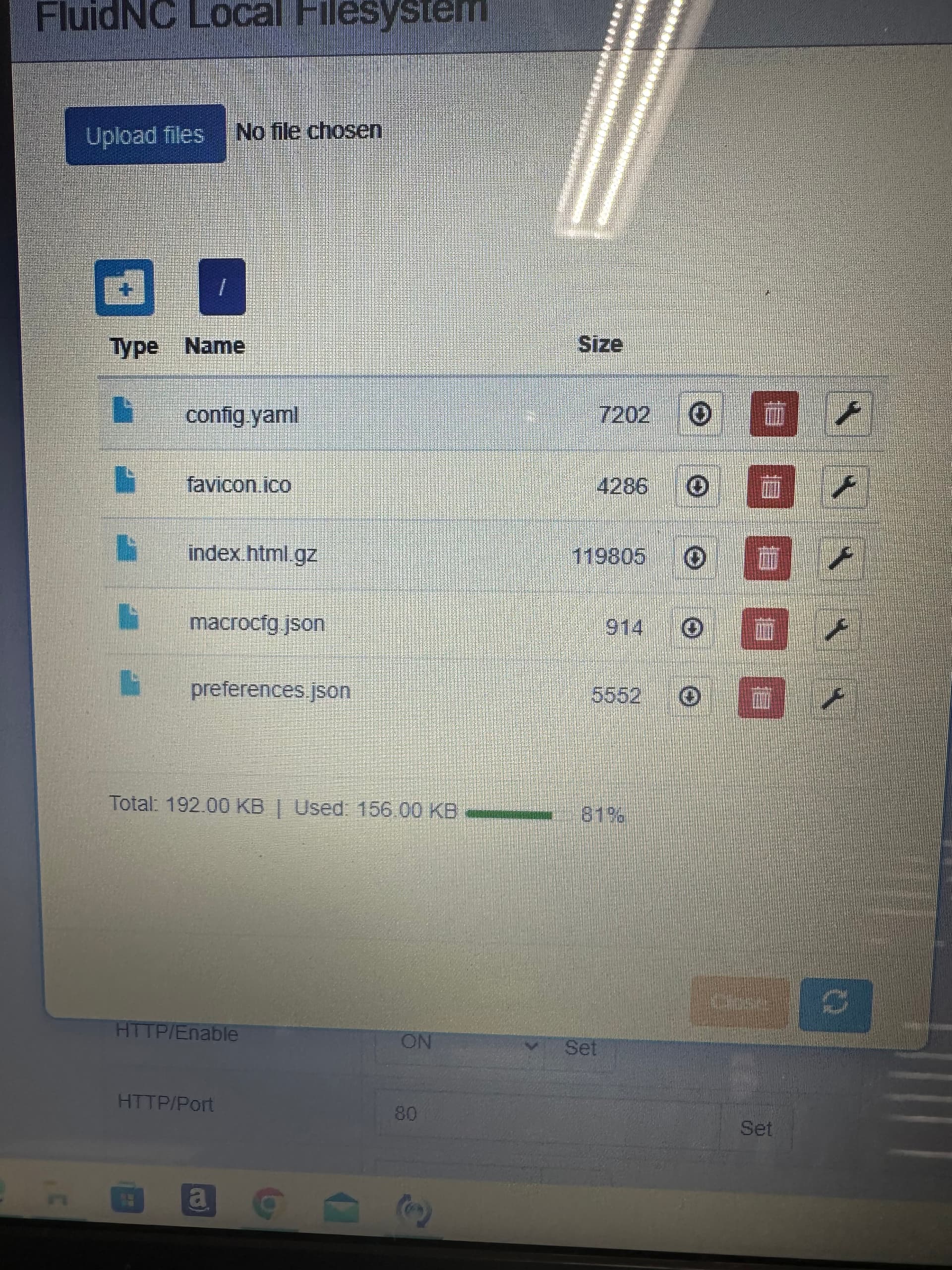

I recently completed the build for my LRV3 and started the road to the electronics. All was wired and connected as the instructions stated. The Jackpot controller was shipped with the MPCNC config file so this was changed and restarted. The following is the $SS for the bootup. I have changed the firmware multiple times and followed the instructions from the V1 firmware site. need assistance as I am stumped.

You don’t have the correct config file. You have a config file that will be used with the Jackpot V2 board (Which is in development, but not yet released.). The IO is slightly different on the Jackpot V2, so you need to get the config file for an LR3 with a Jackpot V1.
I’ll edit this post in a little bit with the correct link for you.
Edit: The recommended software and config for Jackpot V1 and a new build is linked here:

Holy Moly its alive!!! Thanks I was struggling and thought it was the V2 as it is fairly new. I guess I should have looked at the board closer. Thanks a million!

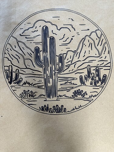

OK, next up let’s see a crown, then that machine cutting it’s own strut plates!

Not a crown but it seems to work great. Strut plates next.
