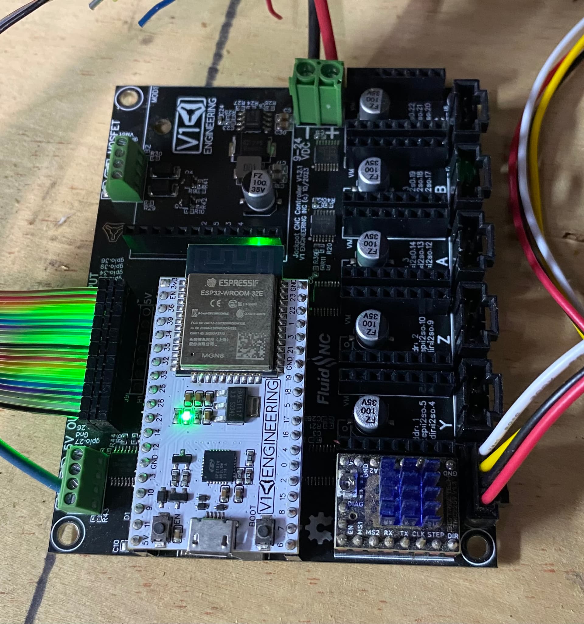

So I’m having issues with my Jackpot, but a brief history on the machine in case it is relevant.
-Started as a 10’x5’ LowRider 2 with external drivers and a parallel port Mach3 controller.
-Upgraded to a LowRider 3 and also switch to the SKR Pro because I wanted to run a laser sometimes.
-Ran like that for a while, but killed two SKR Pro boards (they would stop responding over USB/serial terminal) and had trouble with the LCD screens too. So after the second board died, I was happy to give Jackpot a try.
-Moved to Jackpot in March '24 and it was smooth sailing. I made many laser projects with that setup.
After taking a break from projects over the holiday season, I’ve got issues.
One Y motor and one Z motor move the commanded distance.
The other Y motor and Z motor move maybe 1/10th the distance.
It is in an unheated garage, so I tried bumping up the stepper currents to 1.5A, but that didn’t make a difference.
I do get some of these errors in bootup:
TMC driver not detected - expected 0x21 got 0x0
Full log below:

Thinking it might be bad TMC2209’s, I swapped the set that came with the jackpot for the set that came with the SKRpro. No change.
Reading through other threads, it sounds like my drivers are not initializing properly and so are not getting configured. Does that potentially mean it is operating with the wrong number of microsteps and that’s why I get a fraction of the expected distance?
I tried the boot order to bring FluidNC online before the drivers are powered, which gave me Not Detected for all 5. Then ran $MI and got the same result as normal power up sequence (2 axes on-line, 3 axes Not Detected).
Any ideas what could have spontaneously combusted to give me trouble?
If I give up on the TMC2209’s, can I run external drivers using the Step and Direction pins and let the Jackpot live with Not Detected?

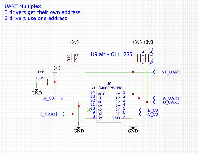

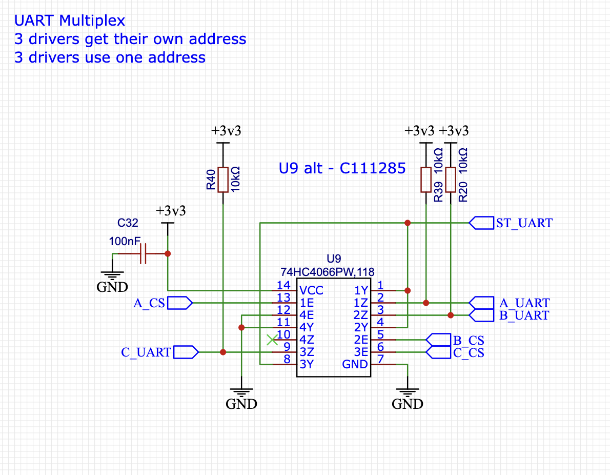

This is interesting. On the jackpot, the first three TMC2209s have unique IDs and are always connected to the ESP-32 UART. The other three get multiplexed access. It’s shown below if you’re curious.
If it were only the 4th and 5th driver that was bad, I’d say it’s a bad mux. But the 3rd driver fails for you as well. Very odd.

This means that the TMC2209s didn’t get configured right (which we know from your boot logs). Because of that, they are not moving correctly. Also, this means that the I2S mux pins that manage EN/STEP/DIR are likely working because you do get motion, just the wrong motion.

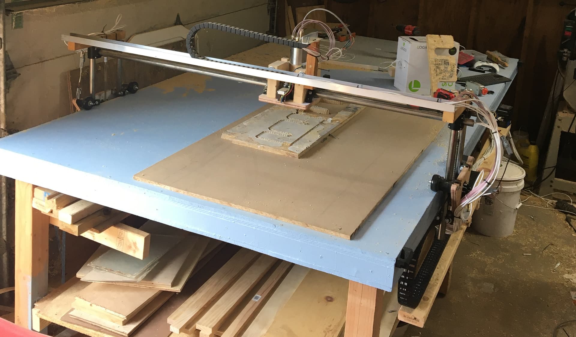

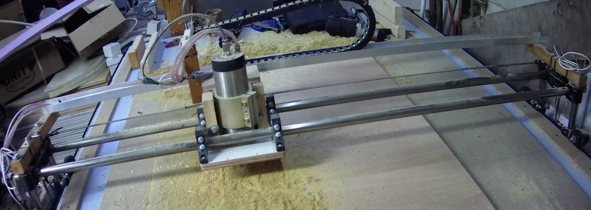

Hah, I just fall into the Long Time Listener, First Time Caller category. I’ve had hiccups before, but someone else always had a posted solution for it. No build thread. Here’s what the Lowrider 2 was set up as.
Since changing over to Jackpot, it has been a laser-only machine. As you might have guessed from the bed size and spindle selection, I have self-inflicted rigidity issues that limited cut speeds. The spindle is now on a smaller aluminum machine.

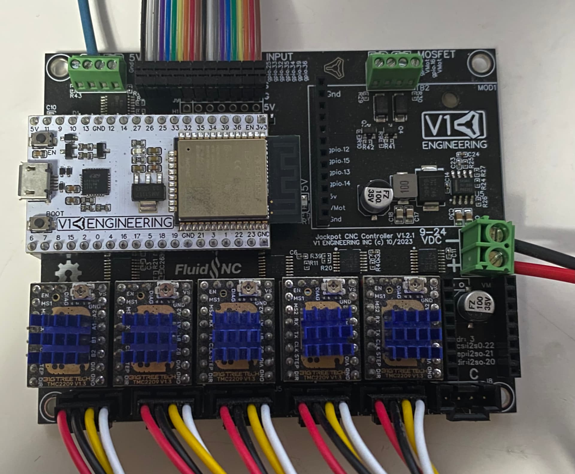

Jackpot from order 24596 3/31/24, which I think puts me in the clear on the resistor?
All the way across the table? How fast? Honestly, don’t do that at any kind of reasonable speed. Jog it over before you power down. Not sure that would be a possible cause- but be aware of it.
From the picture, it looks like you have version 1.2.1 which is the latest version and does have the resistor. It was added in version 1.2 back in November 2023.
https://docs.v1e.com/electronics/jackpot/#changelog
11/18/23 Noon - V1.2 boards start shipping for orders placed after this time. Pull up resistor added for more robust boot on more ESP32 boards.
Fun fact. My Jackpot was shipped on 11/18/23 prior to noon. Although, it now has a resistor and I have a second Jackpot.
It does have it.

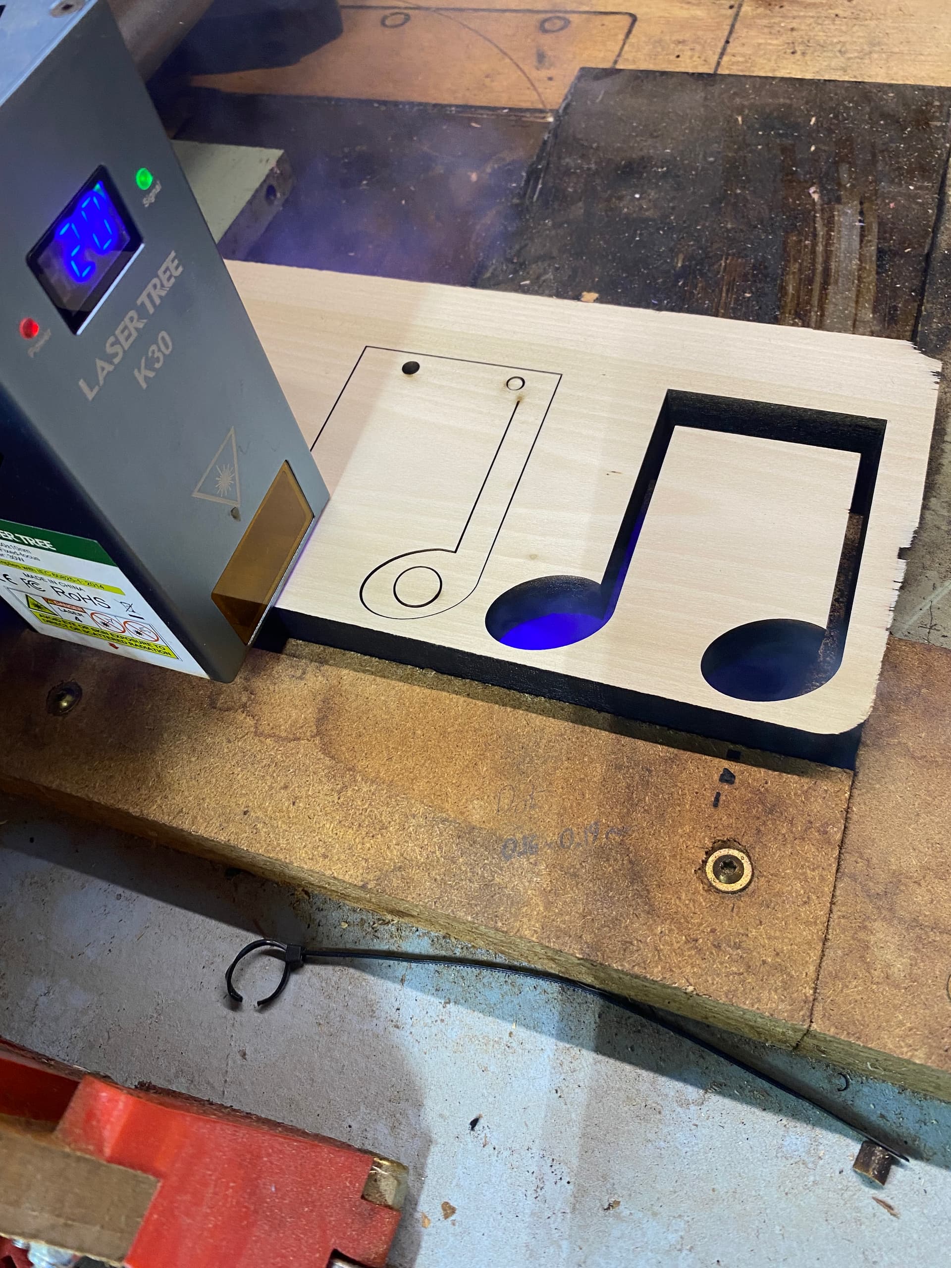

The test project was a little music note to hold the kid’s instrument case on the wall:
