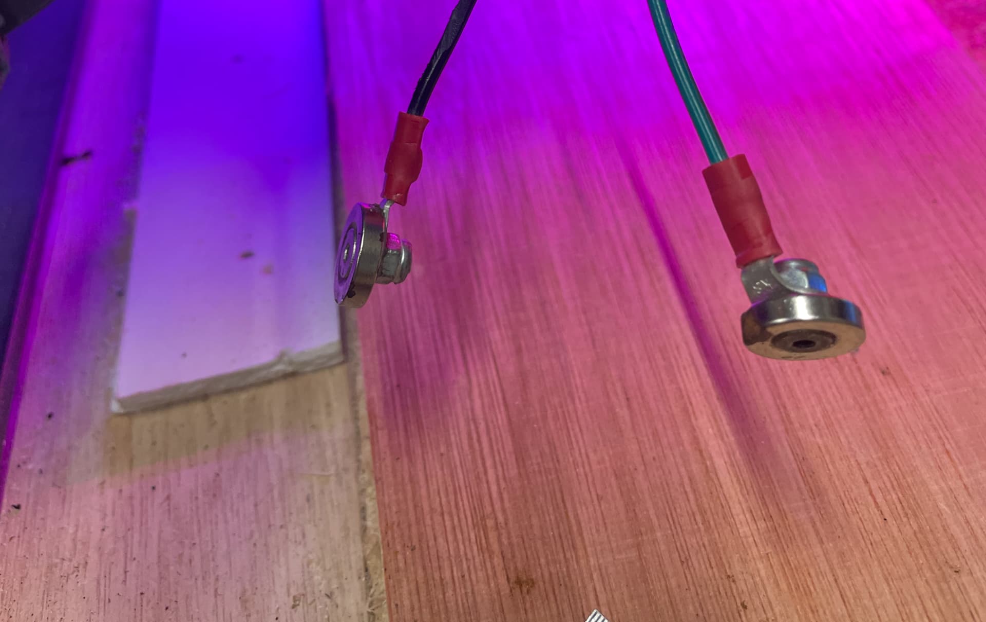

My magnet connection has a cheap (some vaguely magnetic?) crimped spade terminal sandwiched between two magnets. I tried alum and brass terminals and couldn’t find any real difference in performance (I didn’t measure current - just on and off!)
It prints without support - just bridges the top gap, thread the wire, crimp, pull back and plonk a magnet each side. I never did get around to sharing it, so if you want the file just yell.

I use magnets with a countersink and crimp on ring terminals.

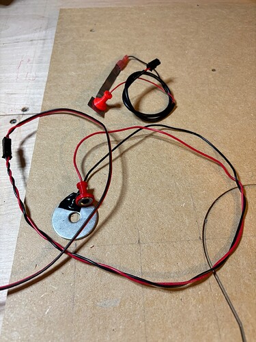

I’m like Dreyfus, counter sunk magnets with a screw into a 3d printed hole holder. I’ve switched to using a large washer. Works much better for me. Also put a connector on it so I can switch out to either type probe or easy replacement option.

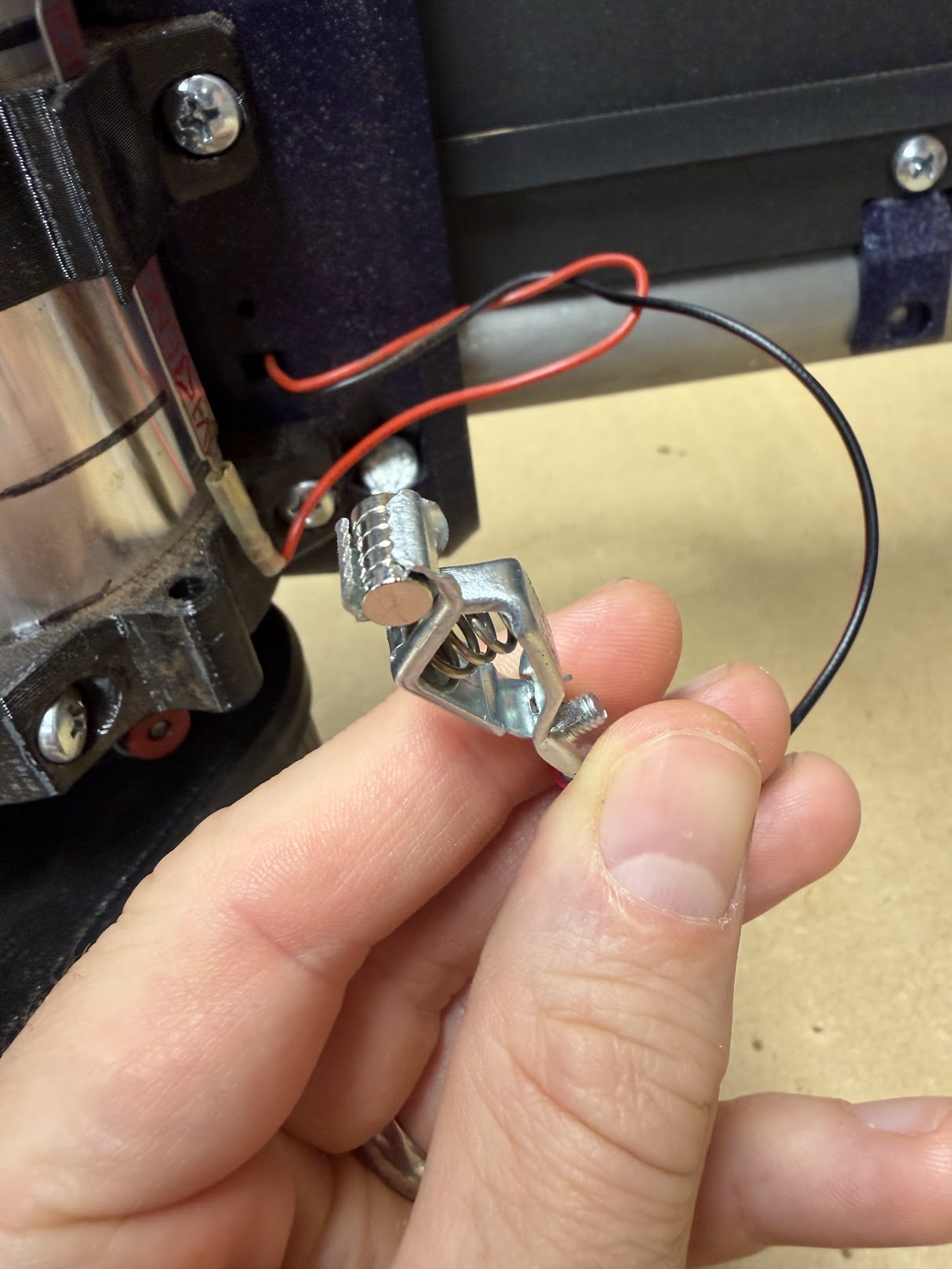

I use the magnet, but I am thinking of switching to the clamp because I can’t seem to get very good conductivity. I must hold the clamp/magnet to the bit to make sure it makes good contact. It gets awkward.

Thanks for reminding me actually. I was using the clamp onto the endmill for a while, until I saw a post where the magnet was clamped and just stuck to the collet.
Since then, I replaced the magnet with these much stronger ones

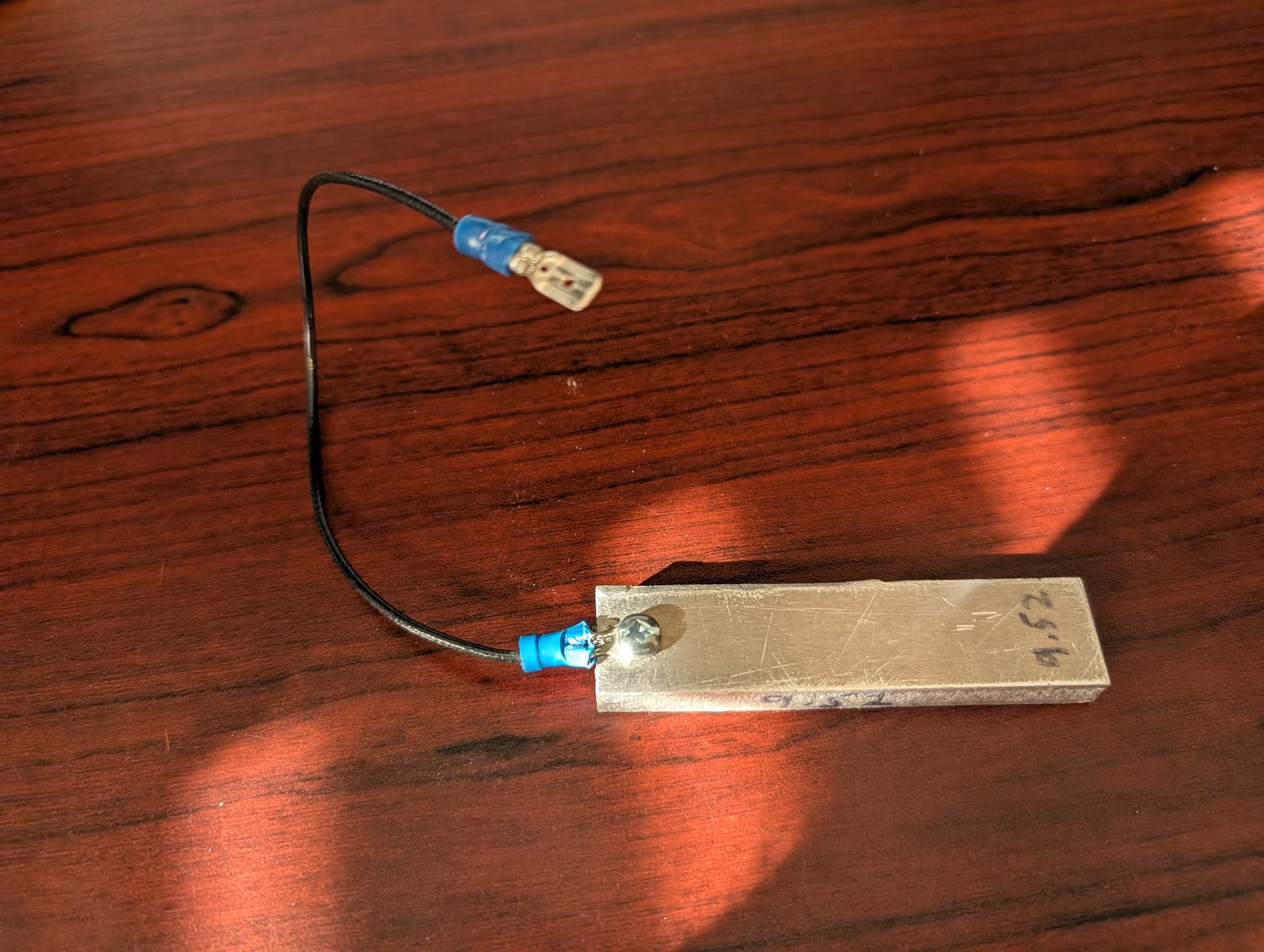

I lost my original V1E touch plate somewhere in the clutter of my garage, and I also found the size, shape and flex of the original to be a bit of a bother.
I had a spare piece of aluminum on hand, so I drilled and tapped a small hole and attached a short section of wire with a screw and ring terminal. A spade terminal allows me to remove and attach it as needed, and the wire it attaches to is easily contained by the alligator clip on the other lead.
I use foil tape for edge finding and profile probing. Ryan’s works great also but for z probing I think a stiffer flat piece that can’t curl would work more reliability. I like the washer or ring too never needed to find the center but maybe one day I will
